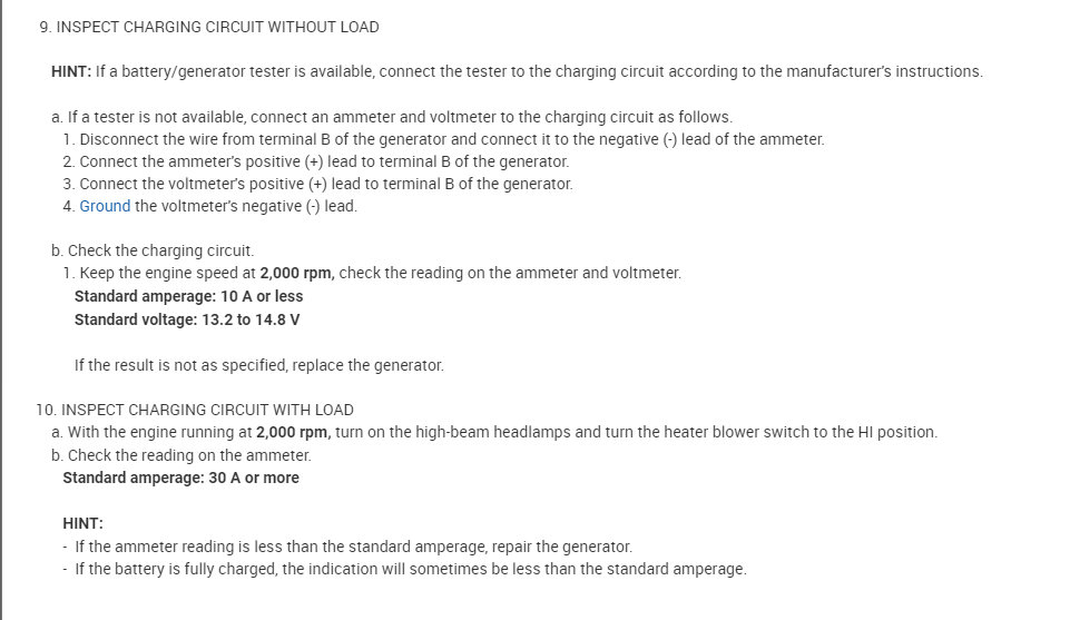

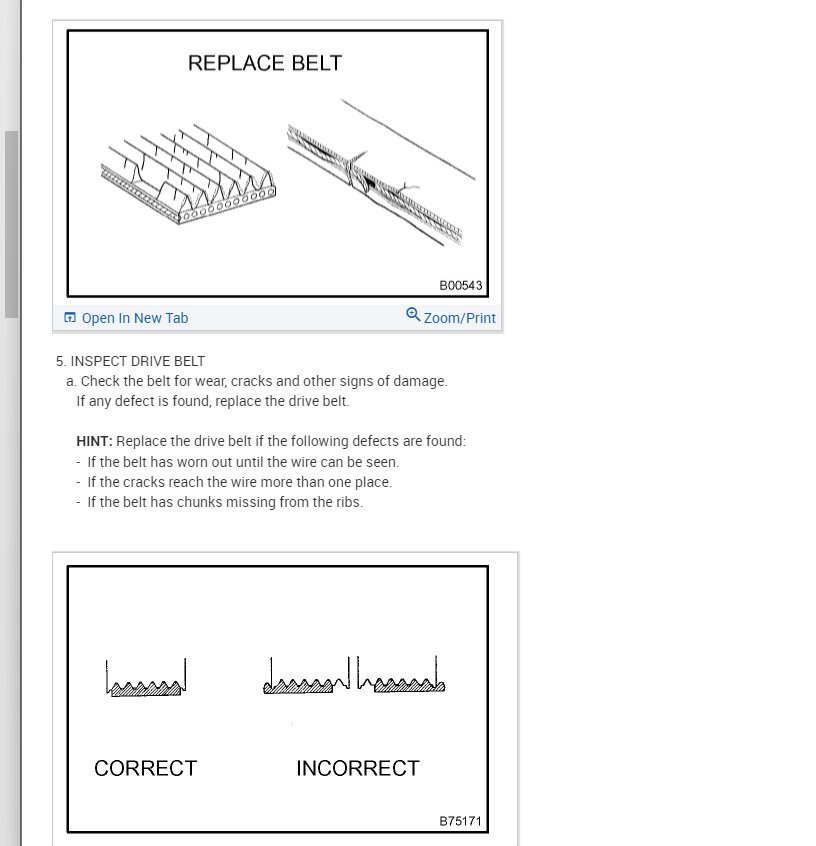

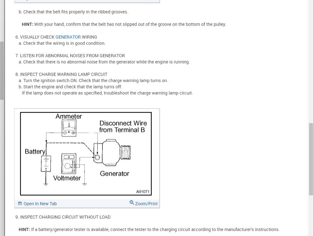

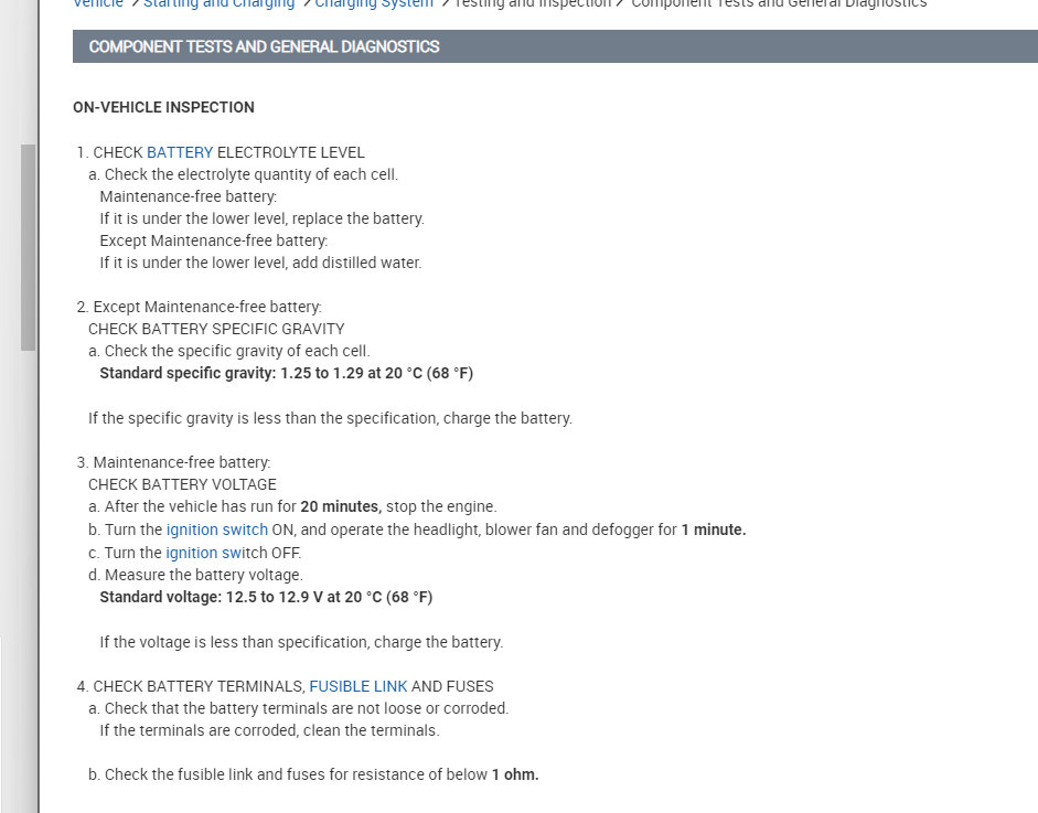

This could be a couple things, but we need to start from the basics even if you have already done them. I would stop by a parts store and have them check the battery and alternator again. If either of those are faulty then that needs to be addressed first.
If the battery and alternator are okay now, then we need to run through the testing I am attaching to make sure we are not missing something else like the belt being too loose or slipping.
Also, the voltage that it is charging is ok, but if the indicator is coming on then that means it is not reaching the level that it is being commanded.
So, let's start with this and go from there.

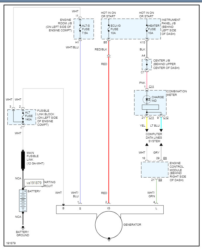

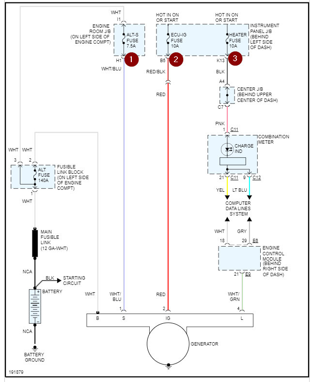

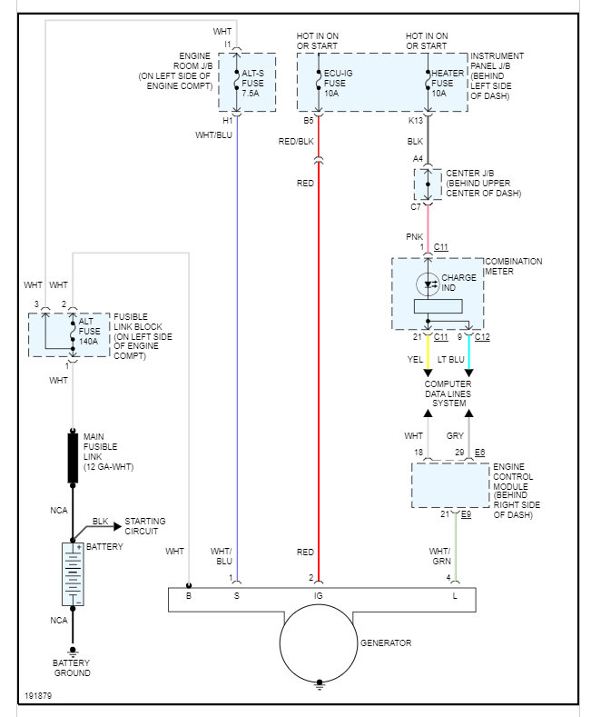

KASEKENNY1 has provided the wiring diagrams with the fuses already. In the engine bay fuse check the alt fuse 7.5A and on driver lower part of dash is the ECU-IGN fuse 10A and heater fuse 10A. Let us know how those fuses look.

Take a look at this wiring diagram. There is a fuse for each wire going to the alternator.
So, we need to go to the alternator and check the power at each of the wires specifically, B, S, IG.
Your alternator fuse could be fine but if you don't have power on the other wires then the alternator will not work.

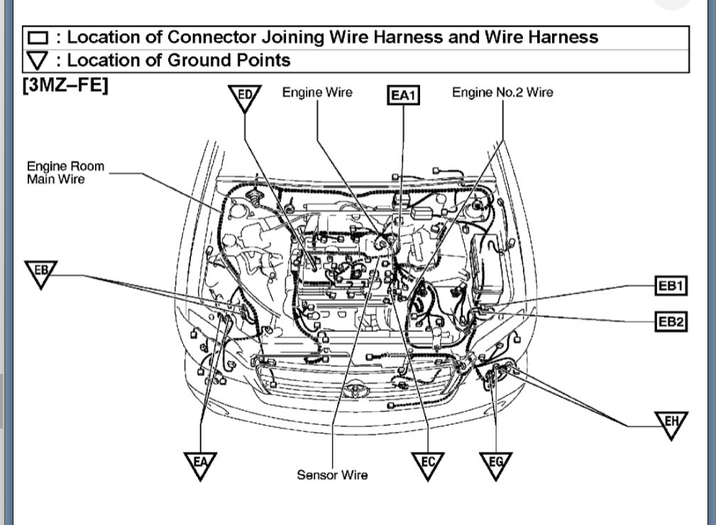

I checked all the fuses, and they are all good. I tested both the battery and alternator again and they passed the test and are producing good voltage. I heard that the EB2 connector is known to get corroded on these cars. I haven’t had a chance to look at it yet but was thinking of buying the plug ahead of time before I take it apart. I am having a difficult time finding the connector anywhere including the dealership. Any suggestions?
Mar 4, 2022 at 12:32 AM
Got it. That is correct as I have heard of that well.
I am attaching the location of it, but I have not been able to find a kit for it.
What I would consider doing is just getting an entirely new connector which means both sides of it. All you need is a 10-pin connector and then change one wire at a time to ensure you keep them straight. However, you don't have to keep the exact replacement connector if you are going to change both sides which is what you would have to do if there is corrosion.
