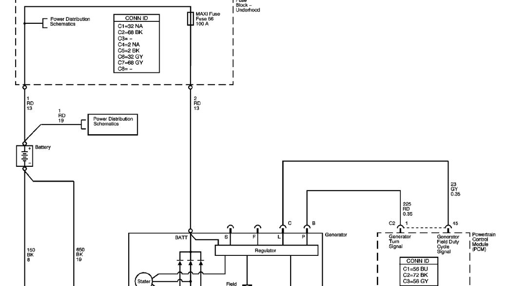

I have an issue with the battery light. I replaced the battery and I replaced the alternator twice. Also I changed the main fuse and it's still lit. What else should I check?

Good evening,
You need to check the actual charge rate at the battery with the engine running. it should be 14 to 14.5 volts.
I will attach a wiring diagram for you to view as well.
do you have a voltmeter to do some wiring test? the PCM controls turning on and off the alternator system.

The alternator was bad I replaced it twice. Third time's a charm thank you so much for your help.
