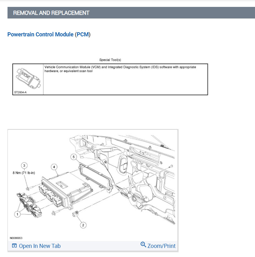

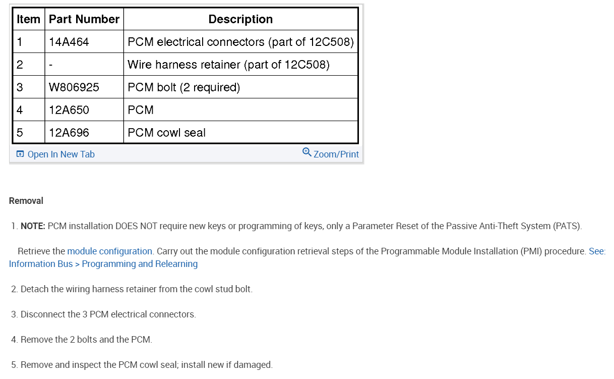

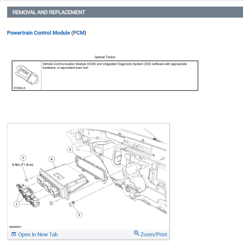

The system is resetting itself when you cycle the ignition key, it sounds like the PCM is going bad, but to be sure let's do a CAN scan which will tell us what's going on. You can get a CAN scanner (Controller Area Network) which will work on most cars from Amazon.
here is a video to show you how:
https://youtu.be/u-4syLc-ifQ

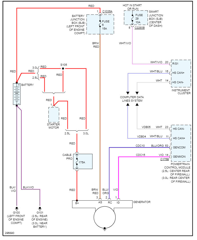

Here are the charging system wiring diagrams so you can see how the system works. Please check fuse # 6 in the engine fuse panel and fuse # 29 in the SJB on the left side of the dash.

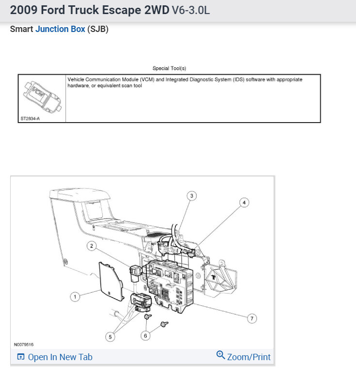

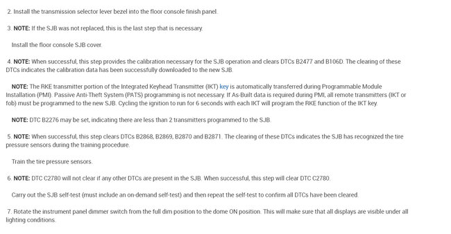

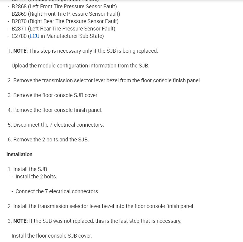

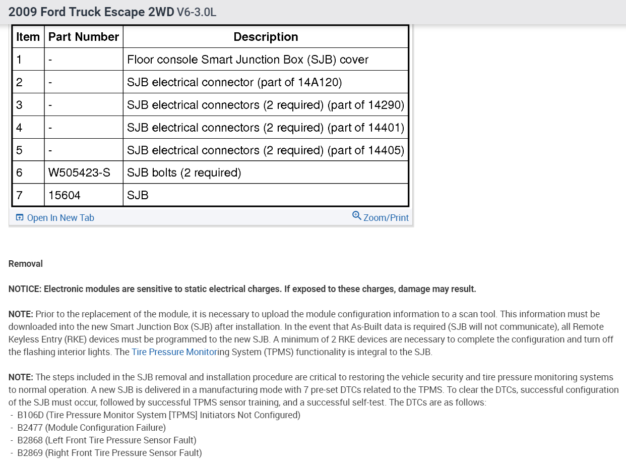

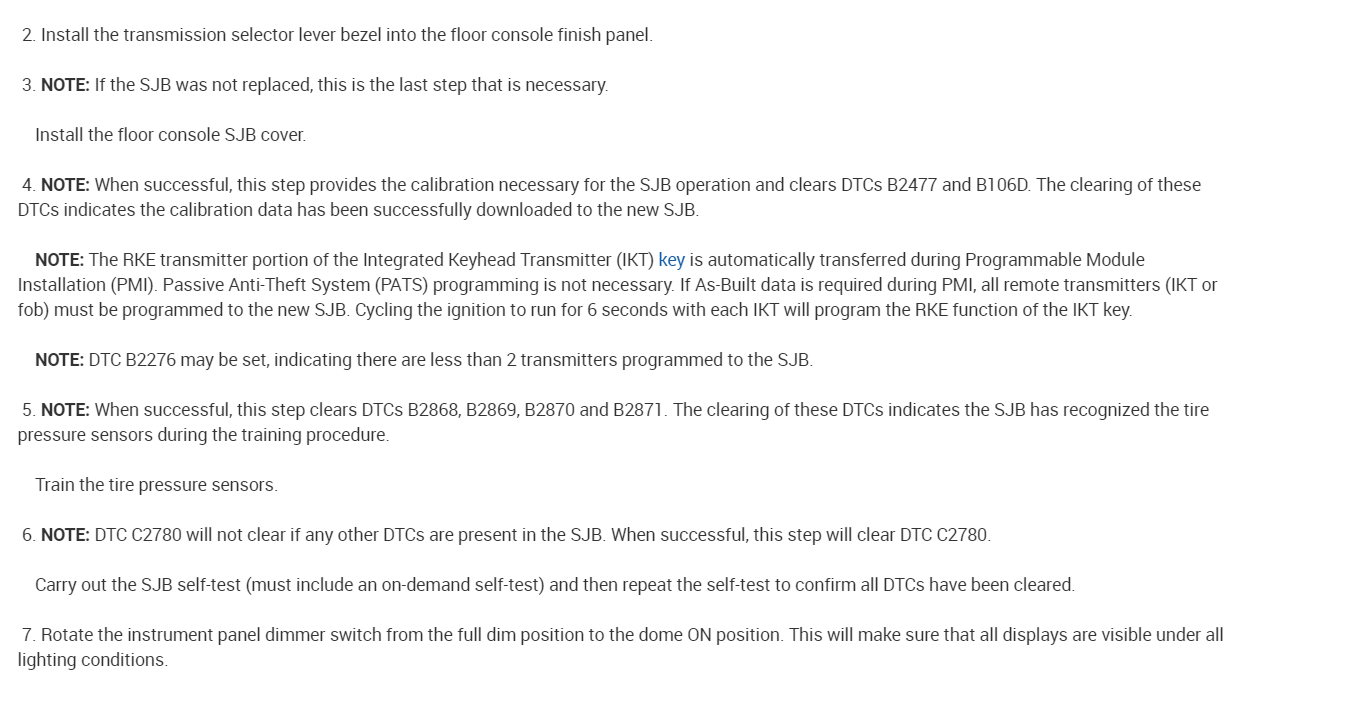

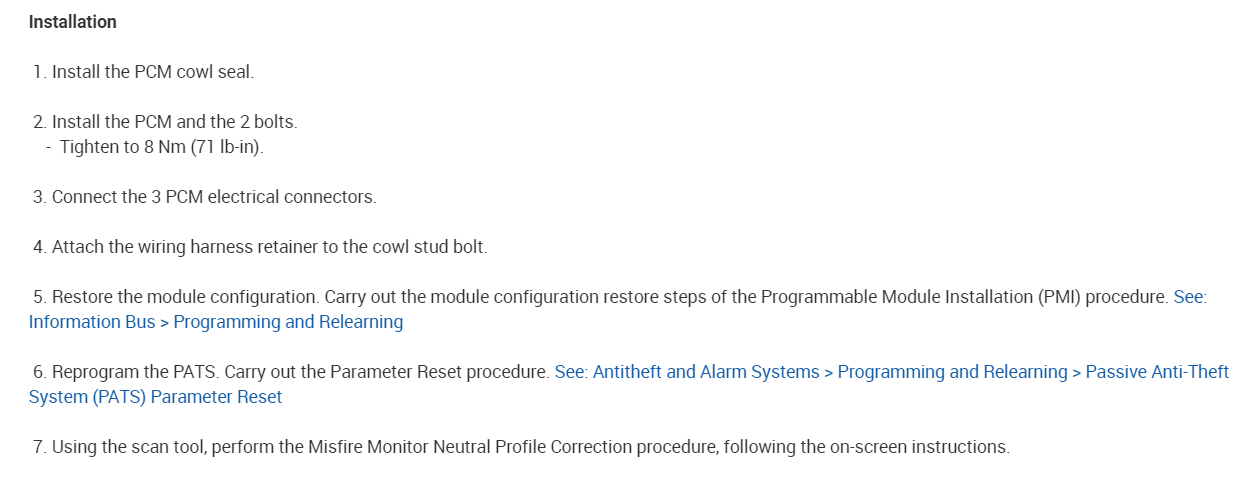

I have seen the SJB (smart junction box) go out as well, this is why we need to scan. Here is how to change both units out in case you need it. You can get a preprogrammed unit by searching Google or Ebay. Check out the images (below). Please let us know how it goes

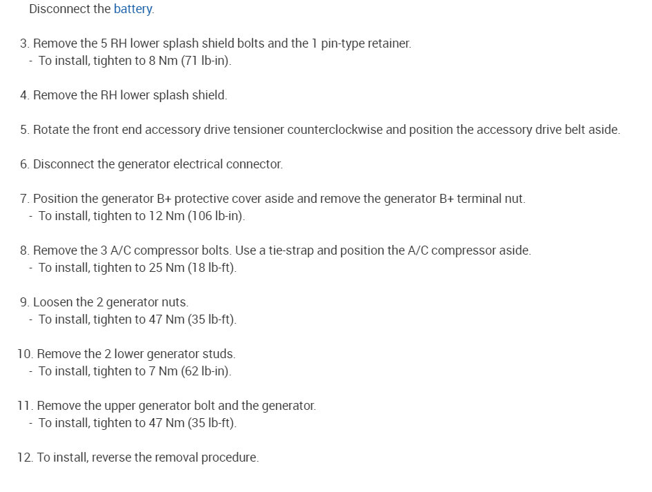

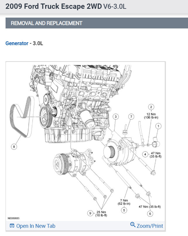

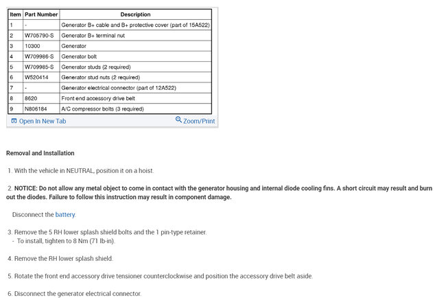

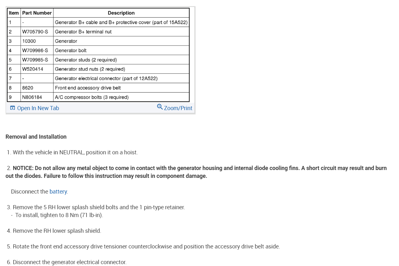

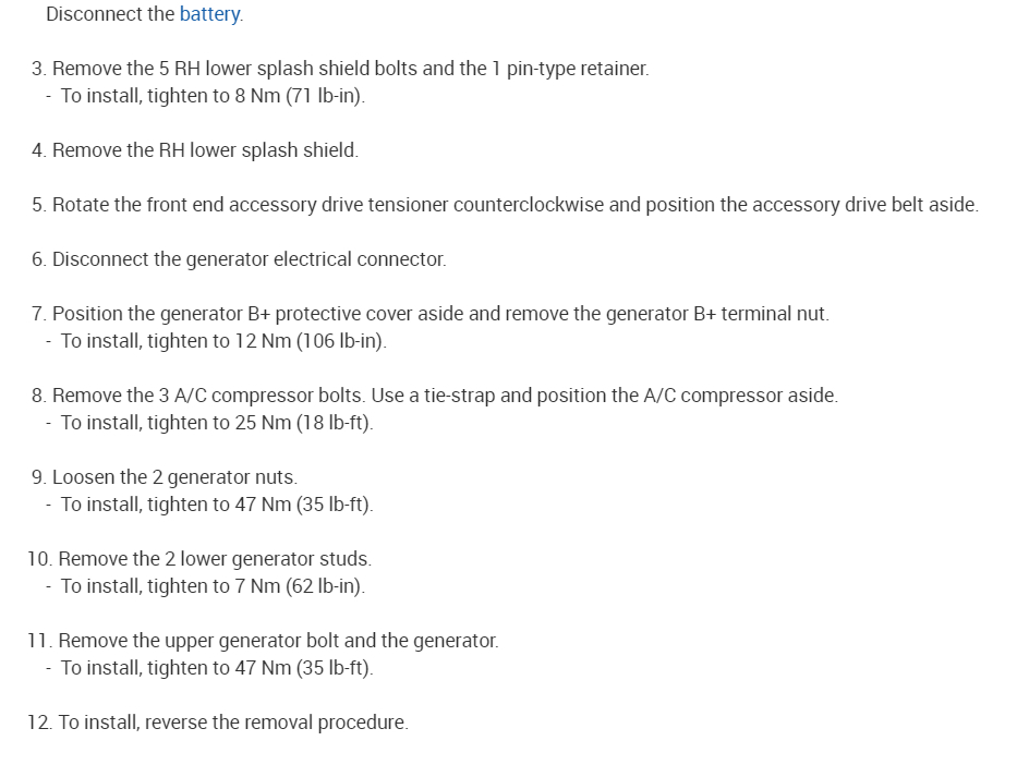

Nice work, I would use this guide to test the alternator and then if it fails replace it. I have included institutions in the images below.
Check out the images (below). Please let us know how it goes.
