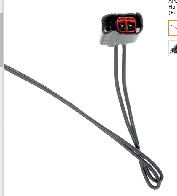

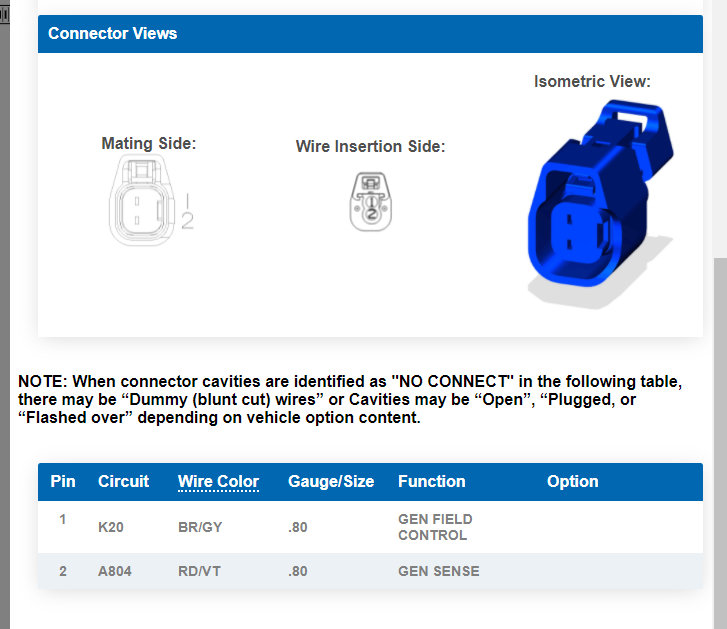

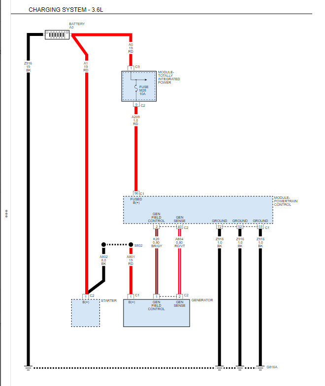

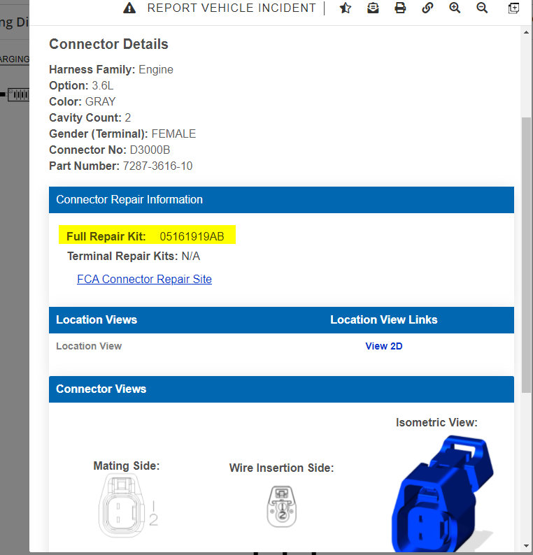

I am attaching the info on what is called a connector kit. This just the connector and wiring pigtails so that you can cut the old connector off and solder the wires back together so that you don't have to replace the entire harness.
I highlighted the part number and if you just do a Google search then you will find this connector. I attached a picture of this as well.
Please let us know if you have questions. thanks

Thank you! We finally got it to snap together and all is well now!
Jun 20, 2021 at 12:56 PM
Oh. Great. Well if this gives you more trouble then it most likely has a broken lock. They are clearly just plastic so they don't last forever. Just hold onto that part number if you ever need it in the future because that harness is a almost $500.00 and the connector is less then $20.00.
