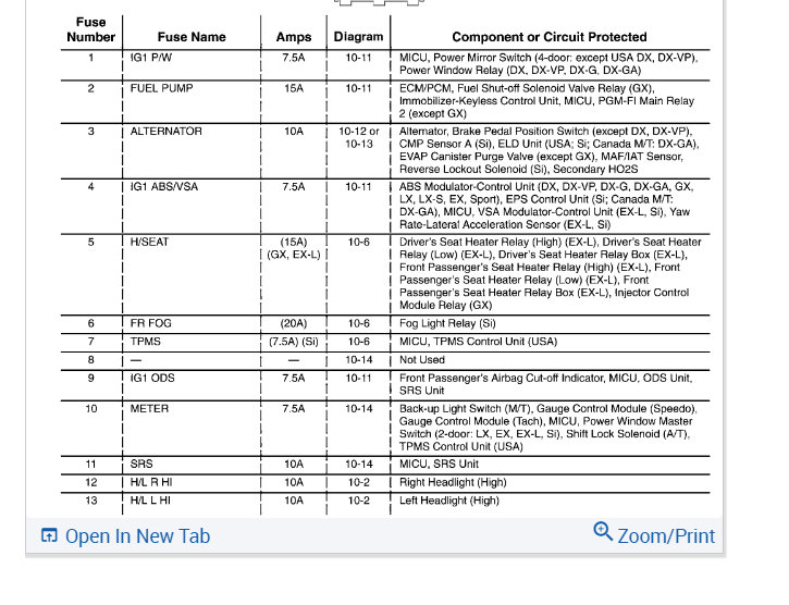

I was driving down the road when my battery light came on bright and solid. I checked the alternator and that's fine, the terminals are good. I swapped alternator fuses. The battery is producing 12.2 volts idling. I'm absolutely stumped, I'm not sure what to do.

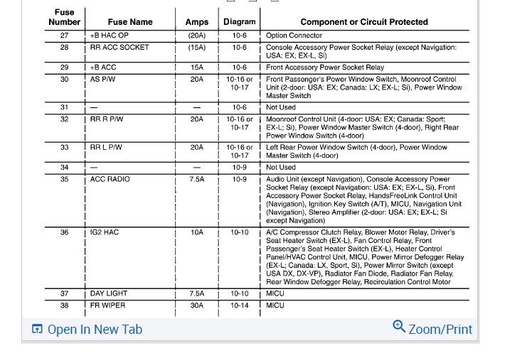

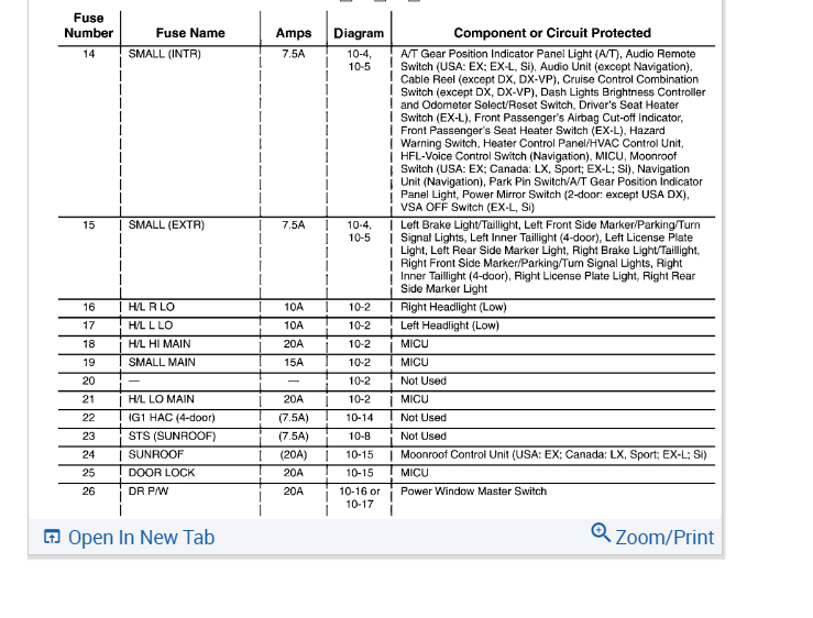

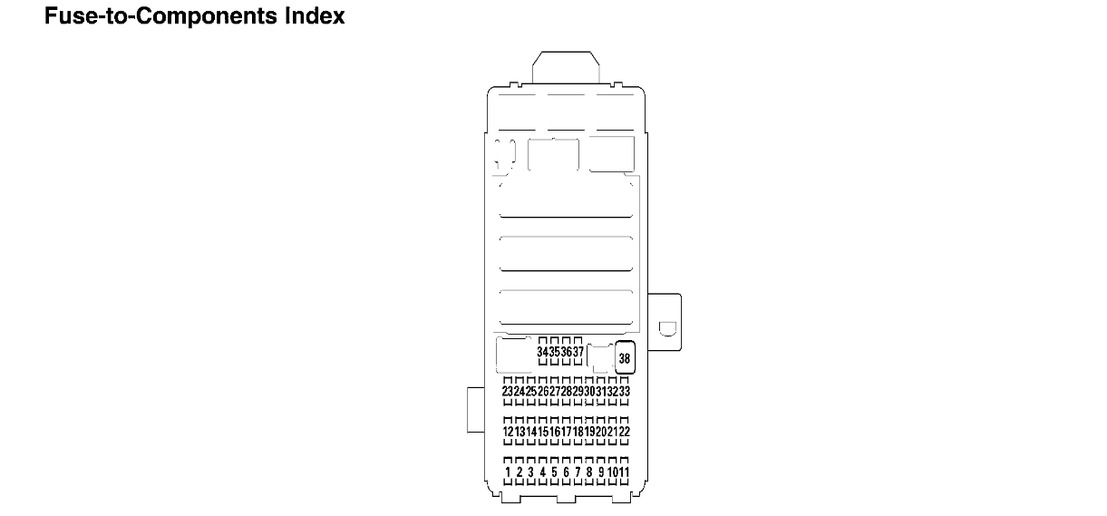

There are two fuses we need to check # 10 7.5 amp and #3 10 amp in the interior fuse panel. Here is a guide to help and the fuse location is the diagrams below. I have also included the alternator wiring diagrams so you can see how the system works.
