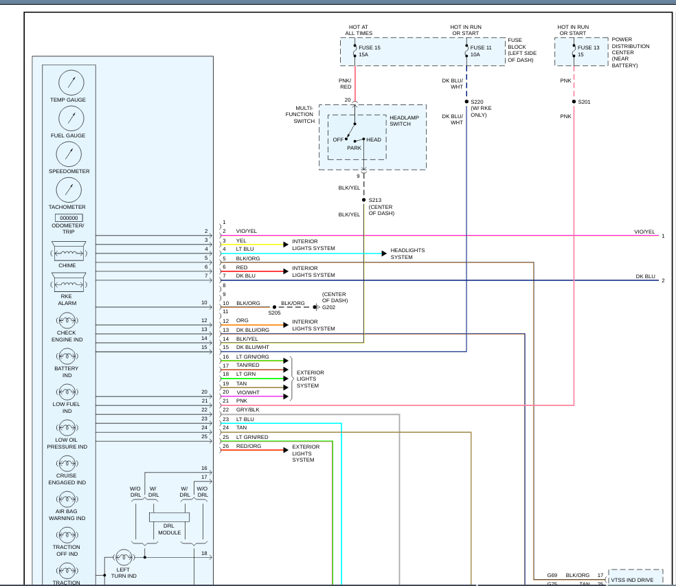

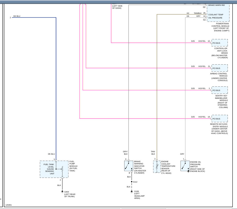

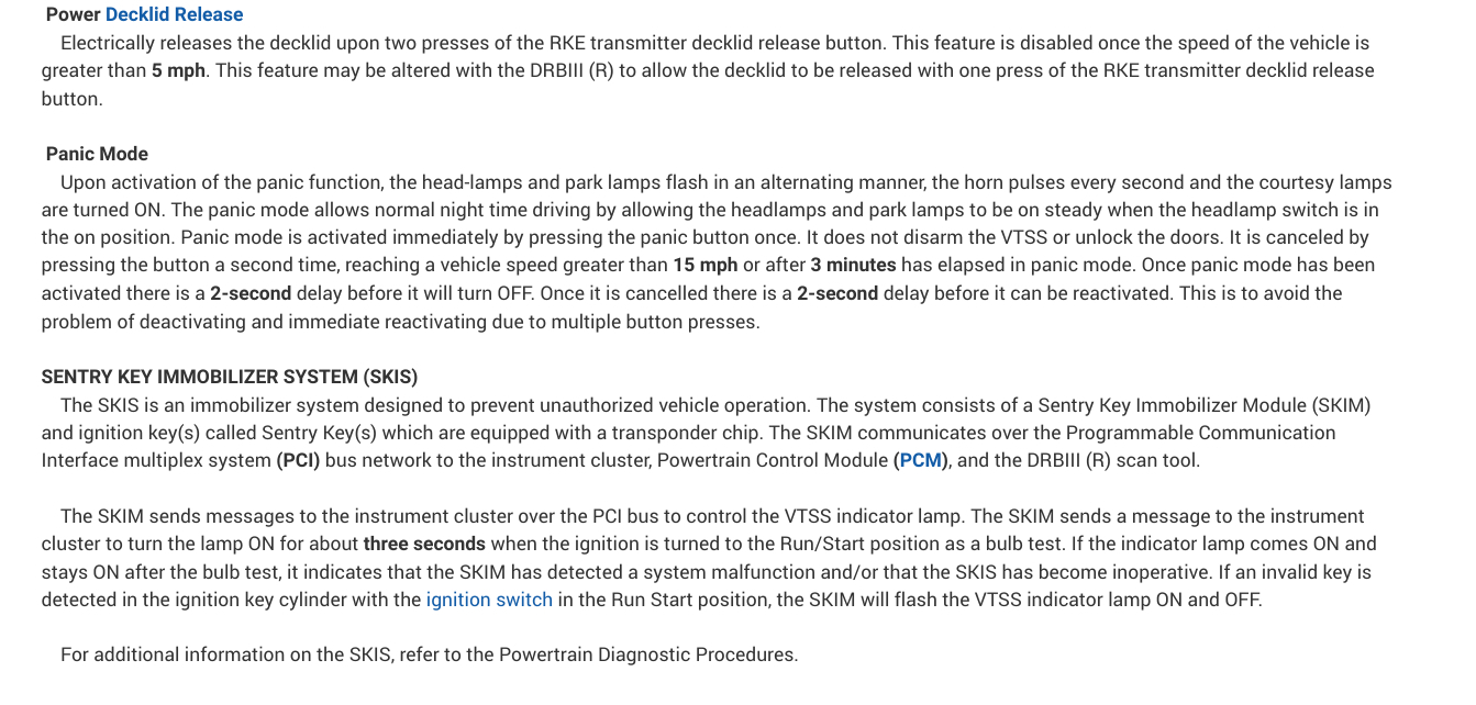

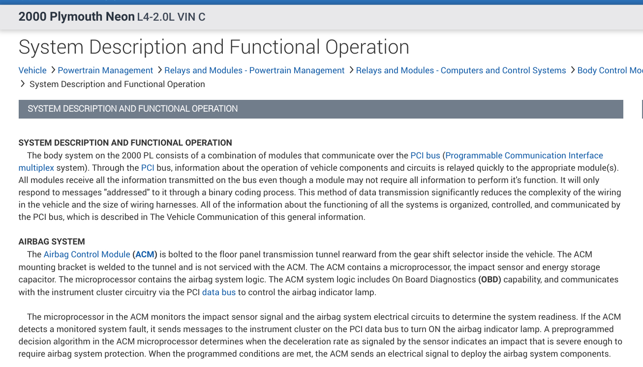

Battery light came on then it quit. put a alternator in the light went off about a week battery light came back on so put another battery in it starts runs but the kept coming back on.
Feb 8, 2020 at 12:03 PM
SCGRANTURISMO
  • 4,897 POSTS

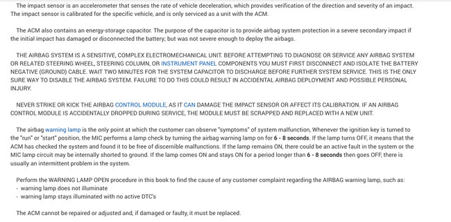

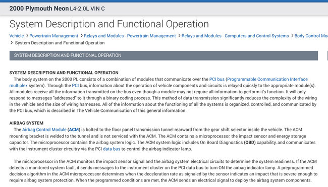

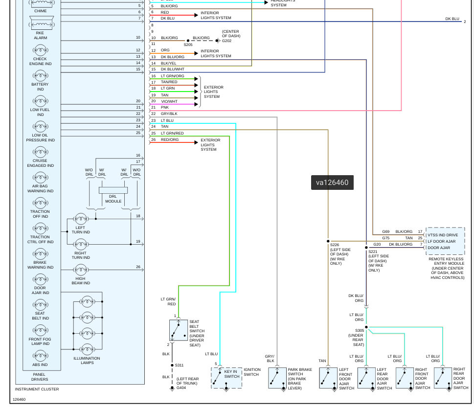

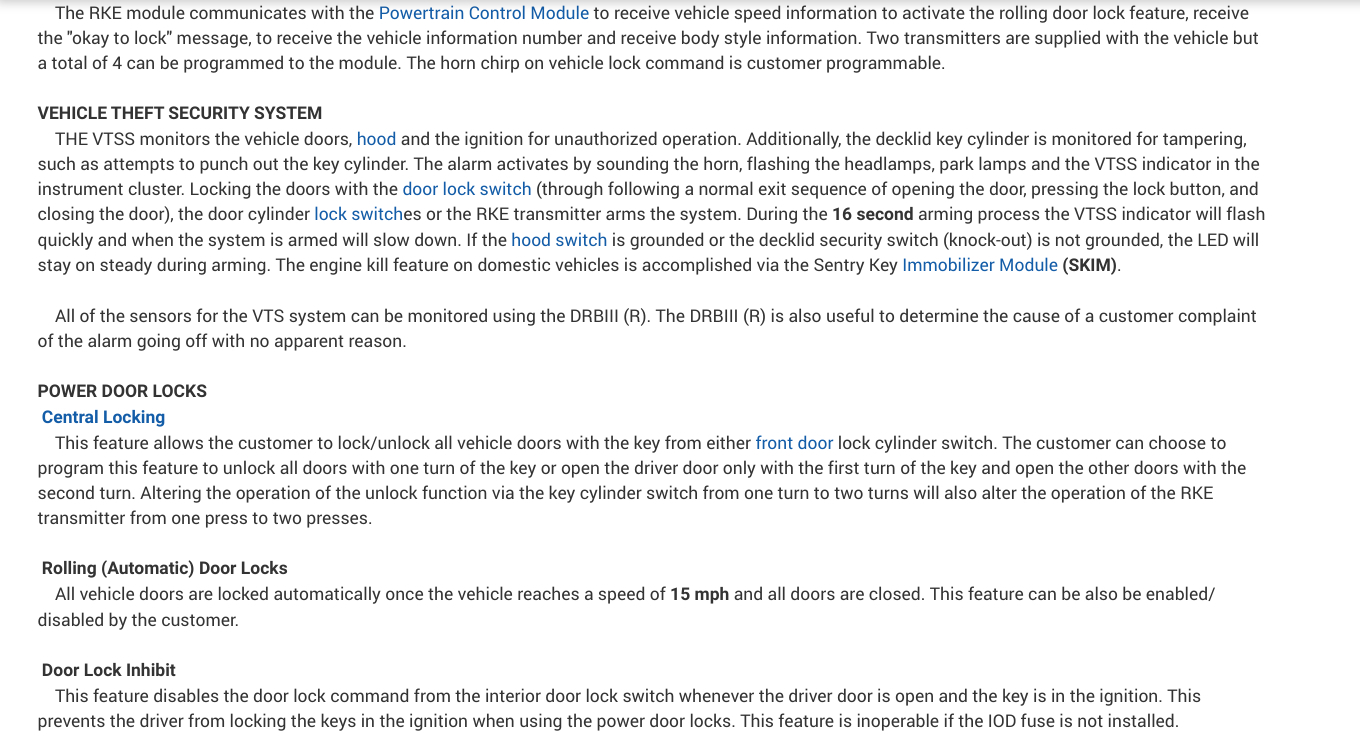

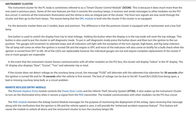

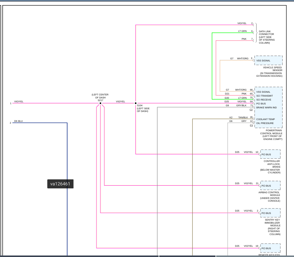

The battery warning lamp is controlled by the Body Control Module[BCM]. In the diagrams down below I have included the description and operation of the BCM as well as the instructions on how to self test the instrument cluster warning systems controlled by the BCM and also the Instrument Cluster wiring diagrams as well for reference. Please go through these guides and get back to us with what you find out.
Thanks,
Alex
2CarPros
