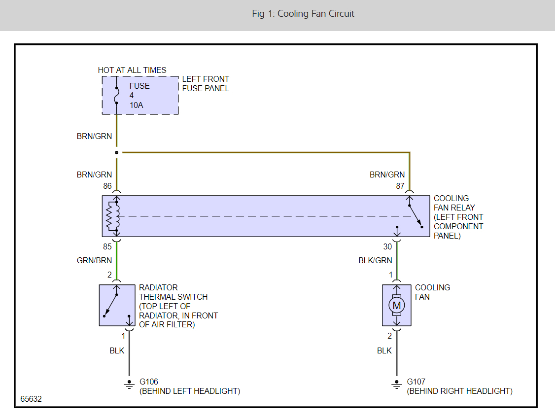

Hi Ken. I checked my fans with the multi-meter and the motor is good. I replaced cooling fan fuses and relay. My electric fans still do not come on. When I turn on the A/C it does not get cold and the fans do not come on.
Apr 23, 2018 at 10:41 AM
  • 55,433 POSTS
There is a thermo switch that causes the fan motor to come on let try shorting that to see if the fans will work here is a wiring diagrams for the fans so you can see how they work. It a two wires sensor up by the thermostat housing.
Please run this test and get back to us.
Apr 24, 2018 at 4:17 AM
TNEAL777
  • 9 POSTS
Hi Ken. I tested the thermo switch connection with a paper clip and the fans came on. Does this mean that the thermo switch is bad and needs to be replaced in order for the fans to turn on?
Thanks
Apr 25, 2018 at 9:48 AM
  • 55,433 POSTS
Sure does, the fan never come on correct? if so the thermo switch is bad.
Let me know what happens.
Apr 26, 2018 at 2:37 AM
TNEAL777
  • 9 POSTS
Thank you so much for your help! The fans finally turned on. :-). So it was the thermo switch. We really appreciate it!
