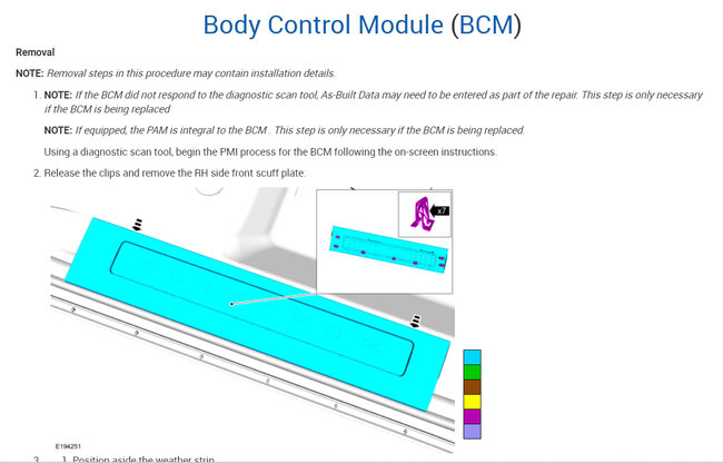

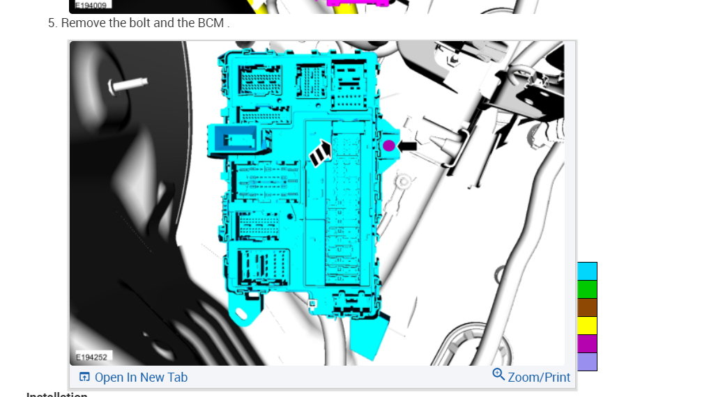

I replace battery but truck keeps draining, and radio won't work.
Feb 1, 2023 at 11:41 PM
  • 55,447 POSTS

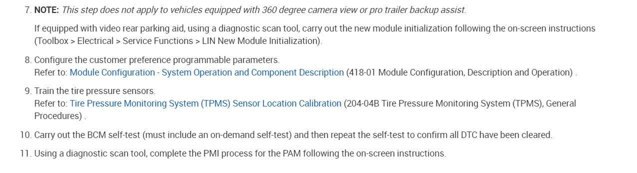

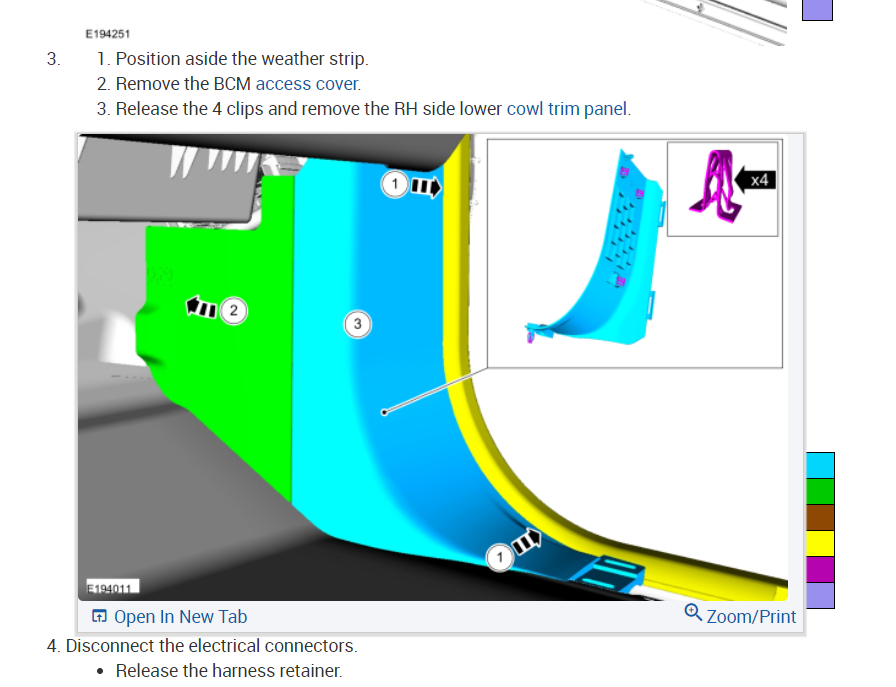

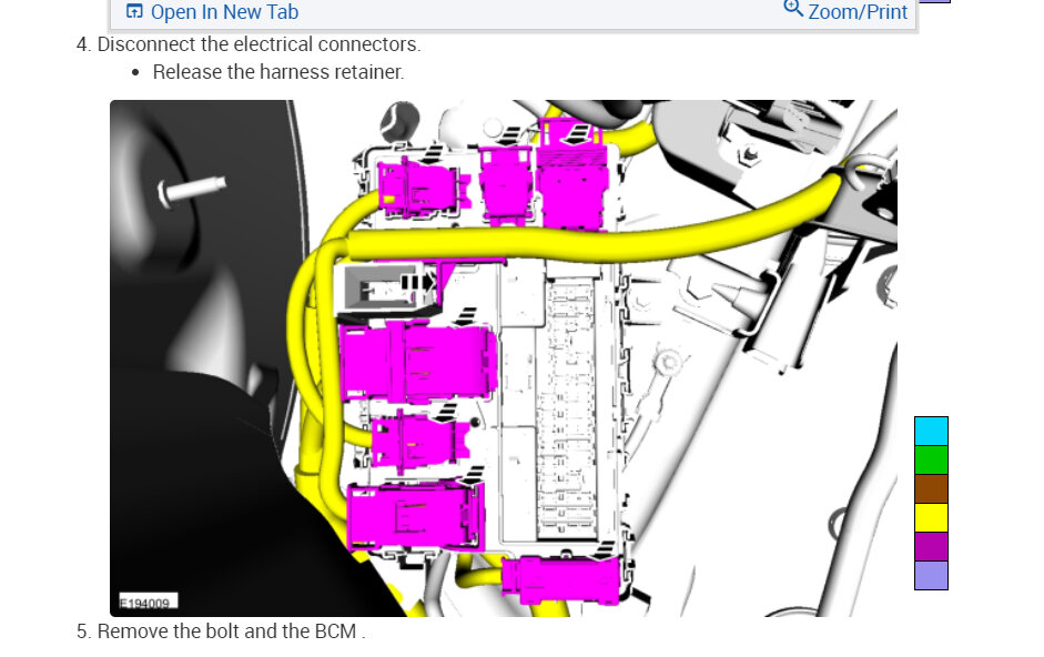

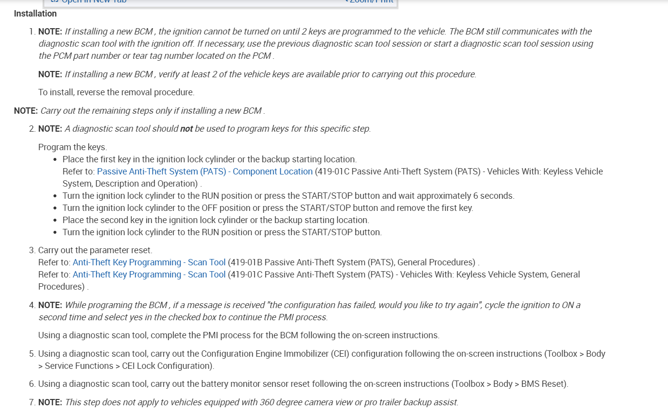

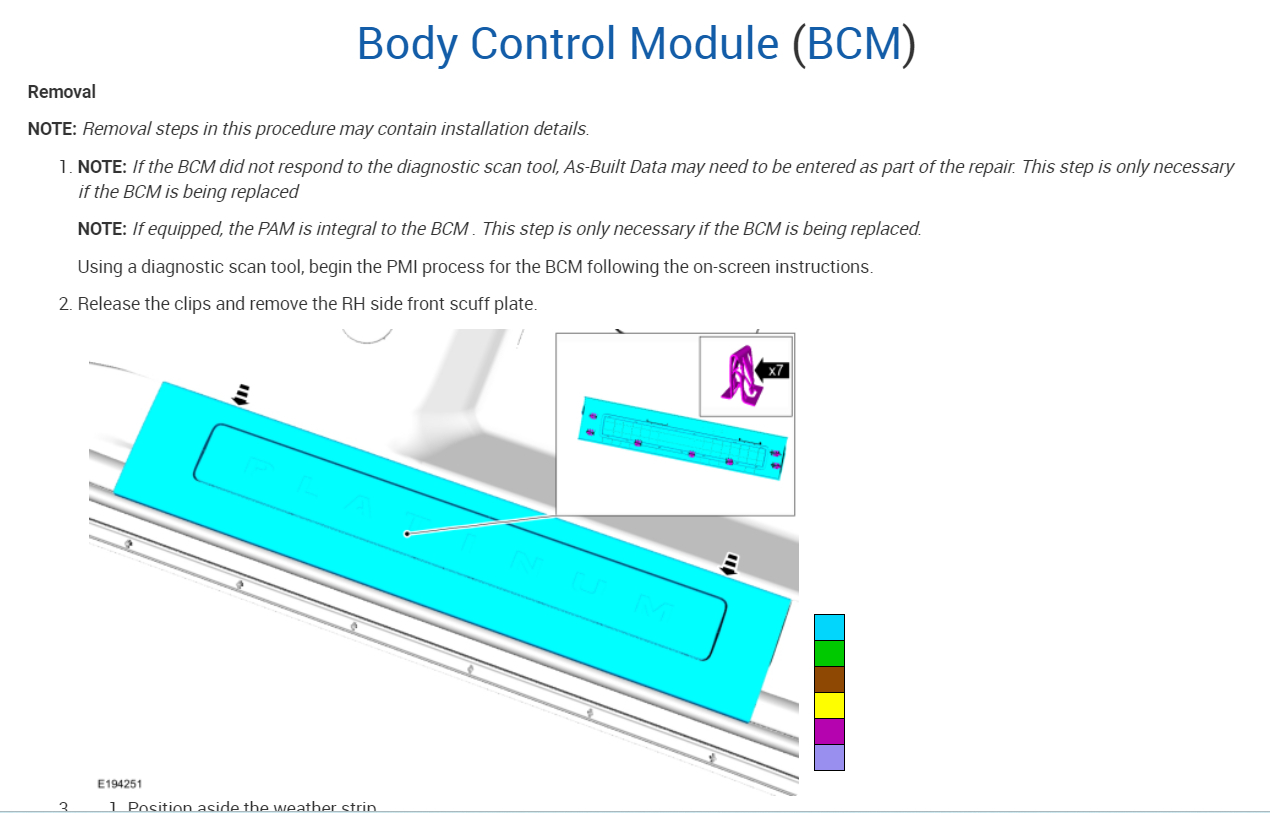

Anytime there is a battery drain there will be heat associated with the problem. I would start (truck cold, battery fully charged) by checking the cigarette lighter, then lift the hood and check the alternator for heat or warmth. Next, check the BCM here is the location in the diagrams below. Also here is a guide that shows other common battery draw problems:
https://www.2carpros.com/articles/car-battery-dead-overnight
Also, a CAN scan will help test the system, which is easy to do. You can get a CAN scanner (Controller Area Network) from Amazon.
https://youtu.be/u-4syLc-ifQ
and
Check out the images (below). Please let us know what you find. We are interested to see what it is.
