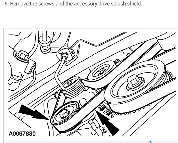

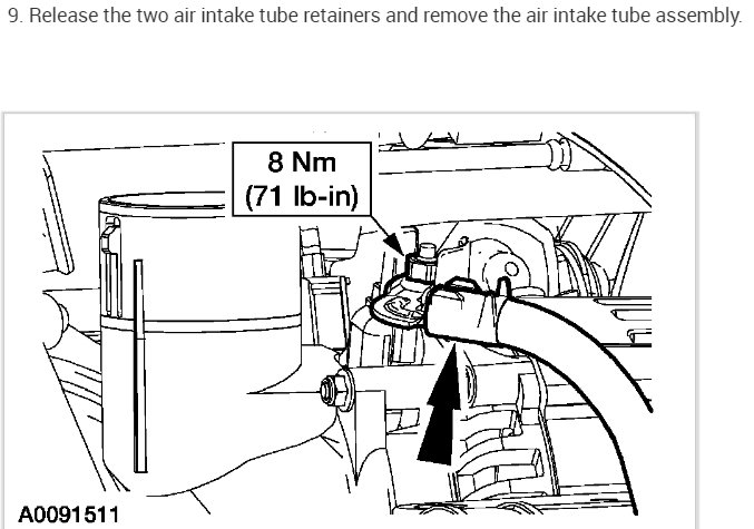

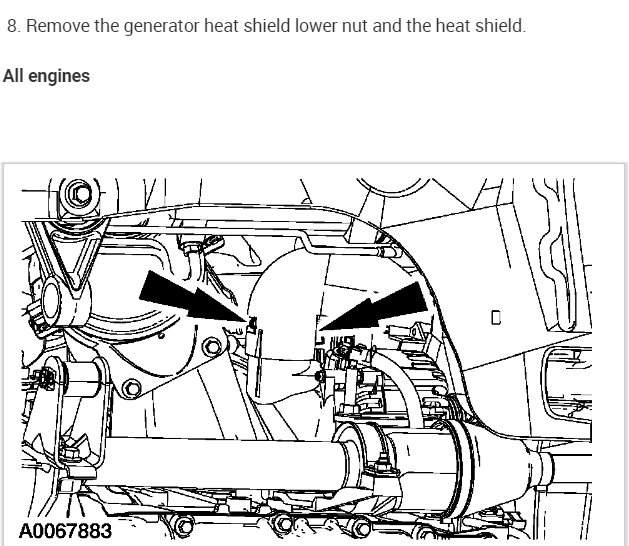

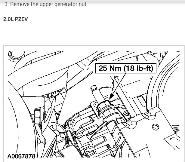

As i have the car listed above SE. it was running well just the air conditioner was not working because lack of refrigerant. Then i filled the refrigerant and the A/C started running. But the same day battery of my car dies. Then i installed the new battery it loses too. What should be the problem?
Jun 7, 2020 at 8:53 AM
DANNY L
  • 5,648 POSTS
Hello, I'm Danny.

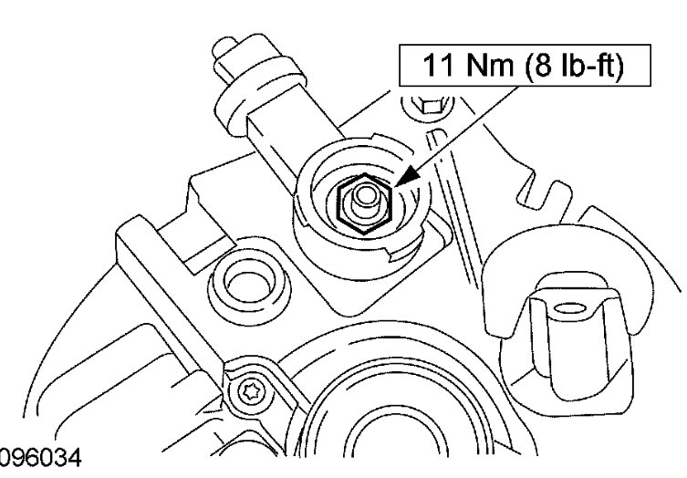

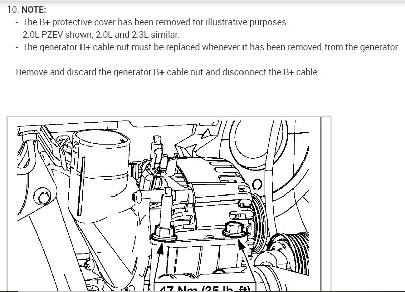

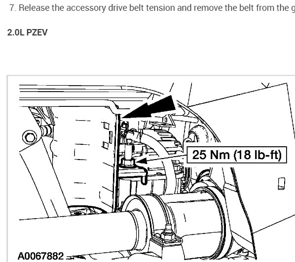

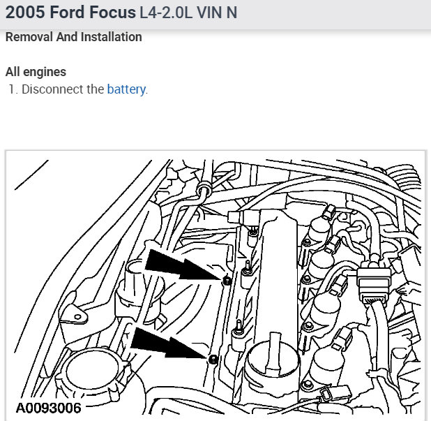

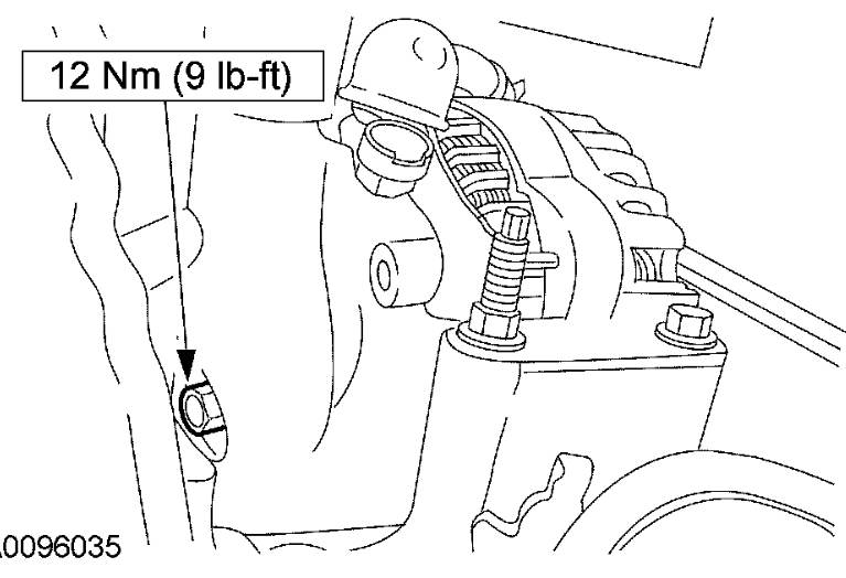

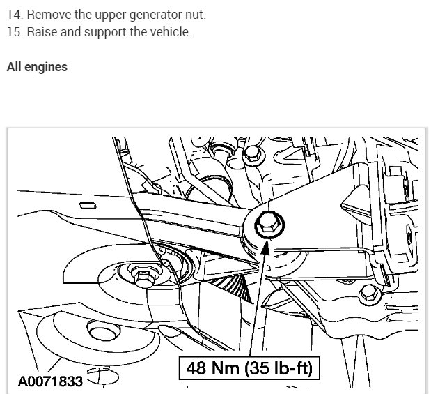

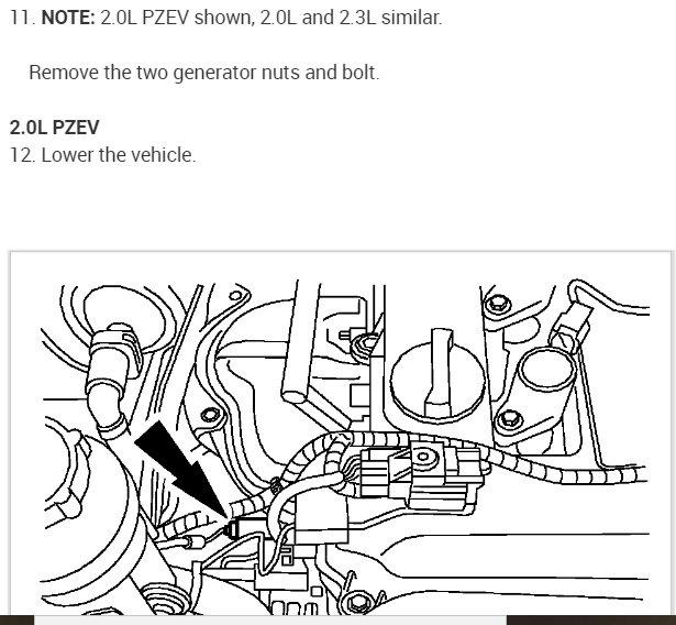

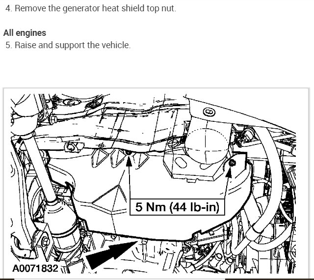

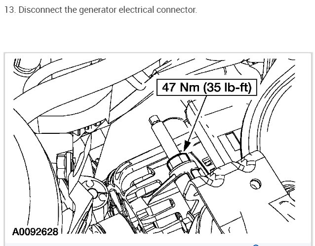

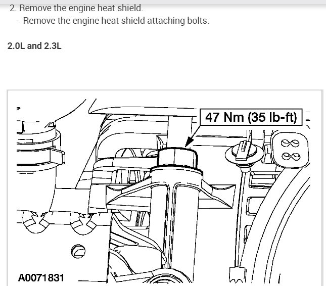

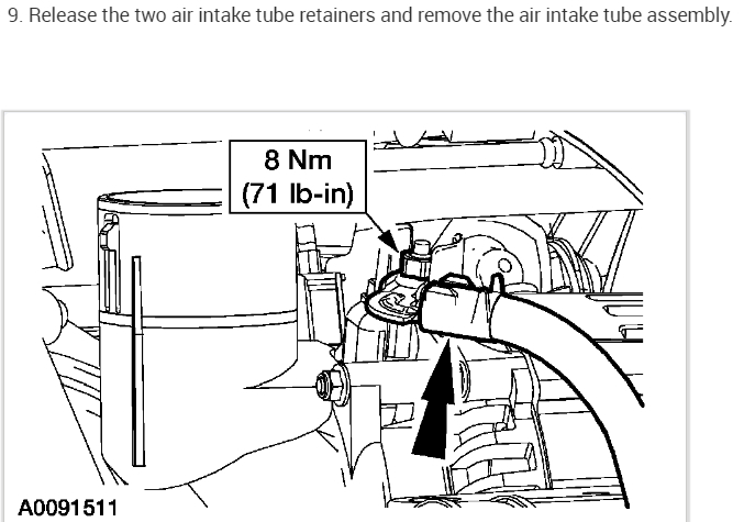

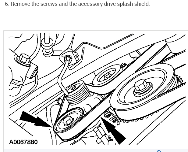

It sounds like you have a weak or defective alternator. Most local auto parts stores will test for free.Here are tutorials for showing you how to remove the belt and the alternator:
The output of the alternator should be between 12.5-14.5 volts. I've attached picture steps below on how to remove and replace for your Focus.Hope this helps and thanks for using 2CarPros.
