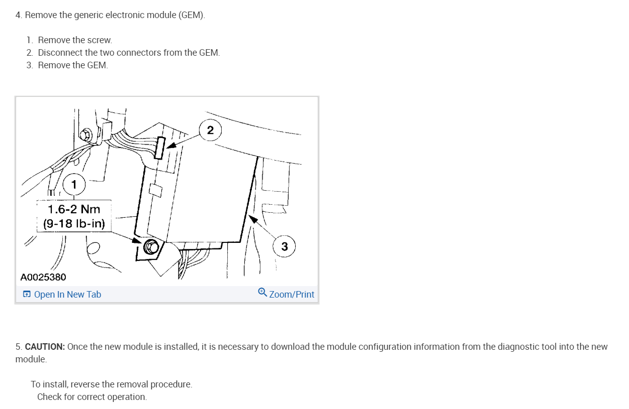

New alternator, new battery, new starter, new belt. No codes. Something is draining my battery. I know I have a short. Tested each and every fuse. The 26 and 29 fuses turned the light off on my light probe. Now I'm stumped.

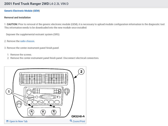

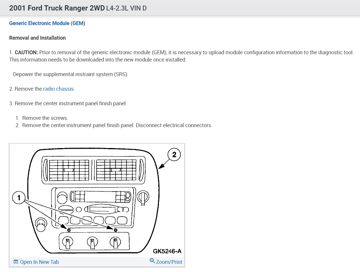

I have seen the GEM module cause this due to lack of shut down ability. This guide can help as well with the GEM module location in the diagrams below:
https://www.2carpros.com/articles/car-battery-dead-overnight
