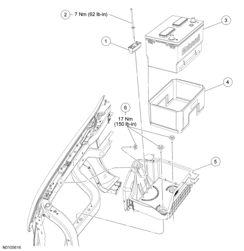

The codes are there because of low voltage, I would replace the battery, is sounds bad but to be sure this guide can help you load test the battery using no equipment:
Here is a generic guide to help you step by step with instructions in the diagrams below to show you how on your car:
https://www.2carpros.com/articles/how-to-replace-a-car-battery
Clear the codes when completed. Check out the images (below). Please let us know how it goes.
