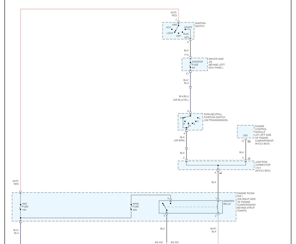

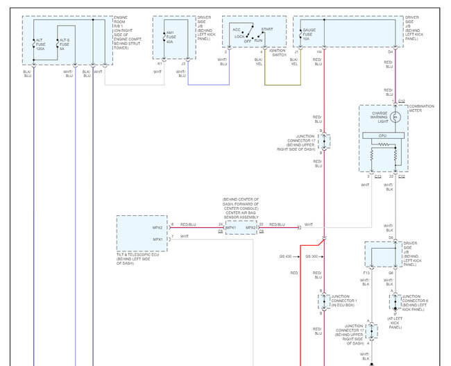

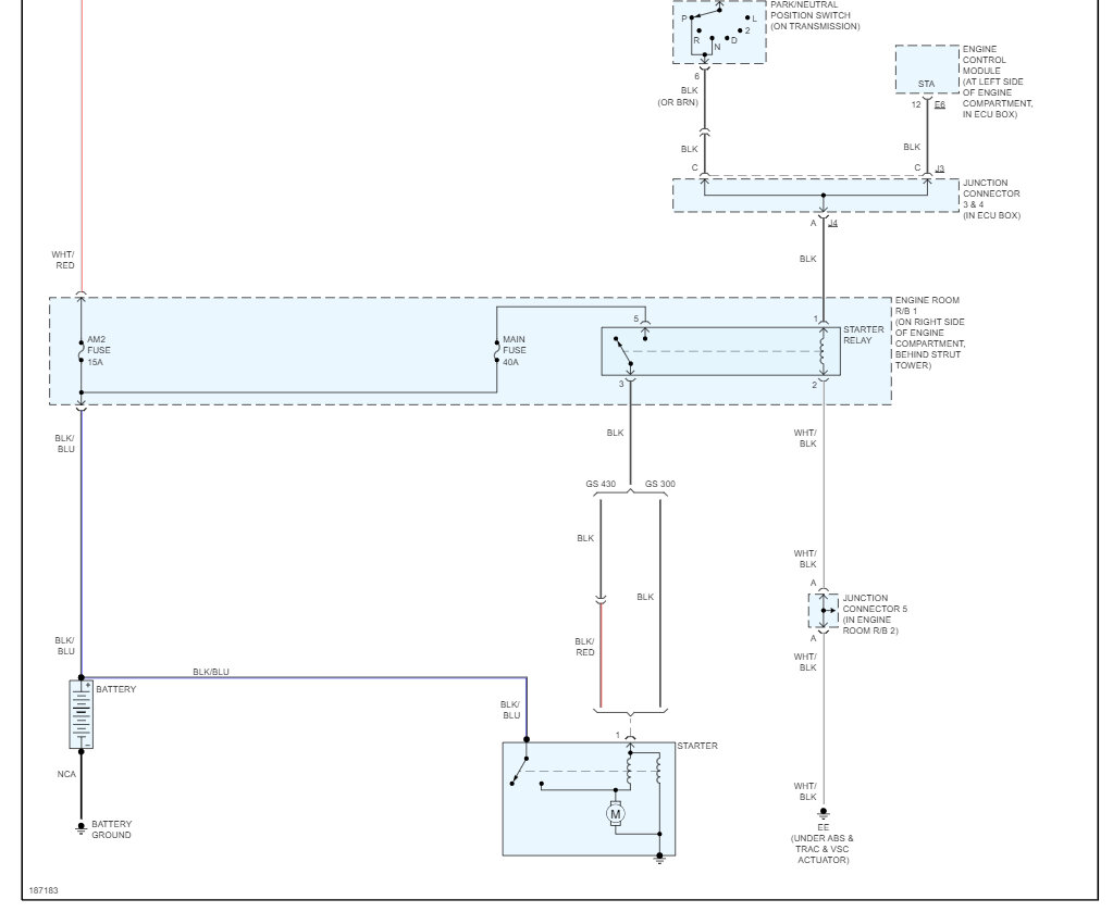

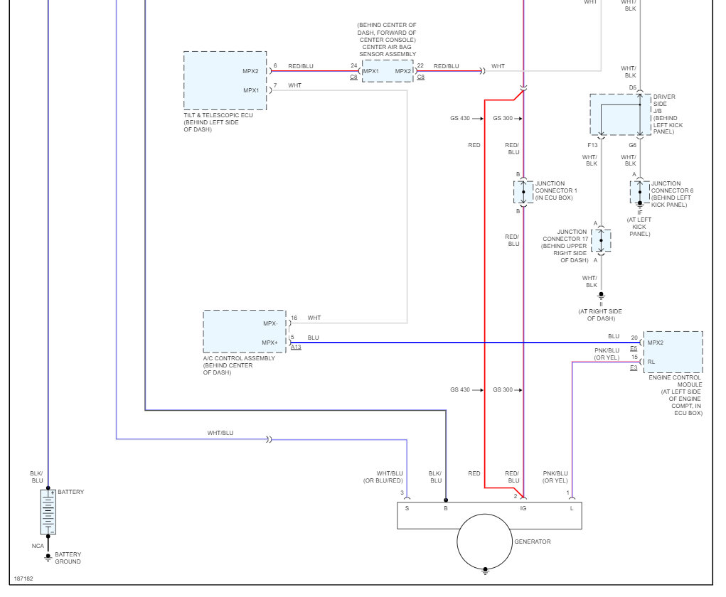

The vehicle battery indicator light does come on sometimes. I have checked the battery voltage and it is okay and the alternator seems to be fine and sometimes the vehicle will not crank. Please could I get the circuit diagram for both the charging system and starting. Thank you very much. This site has been of help to me. I really appreciate.

Sure, here are the wiring diagrams for the starter and alternator system with a guide to help you check the connections.
Check out the images (below). Please let us know if you need anything else to get the problem fixed.
