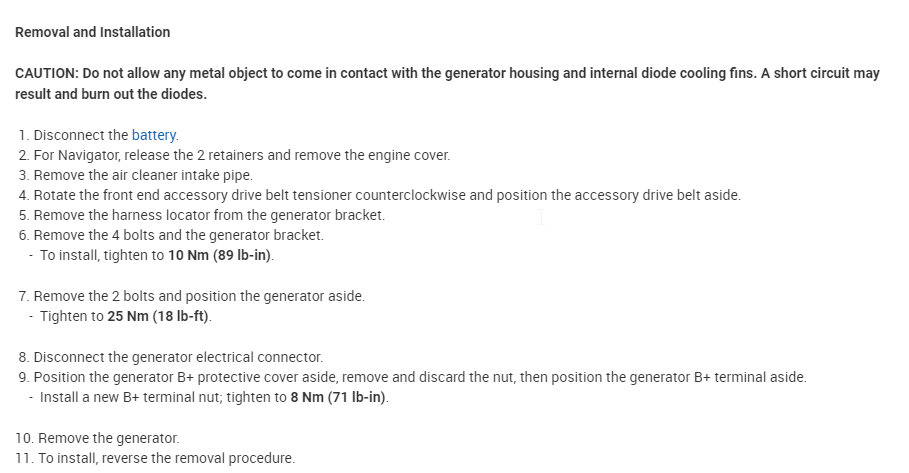

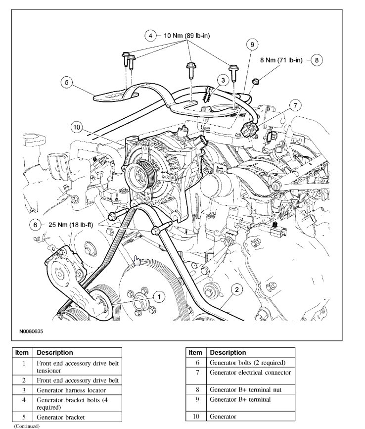

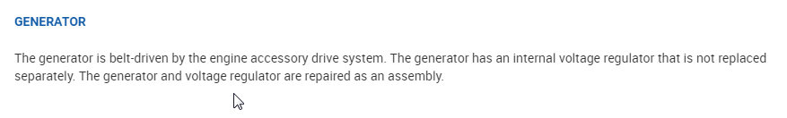

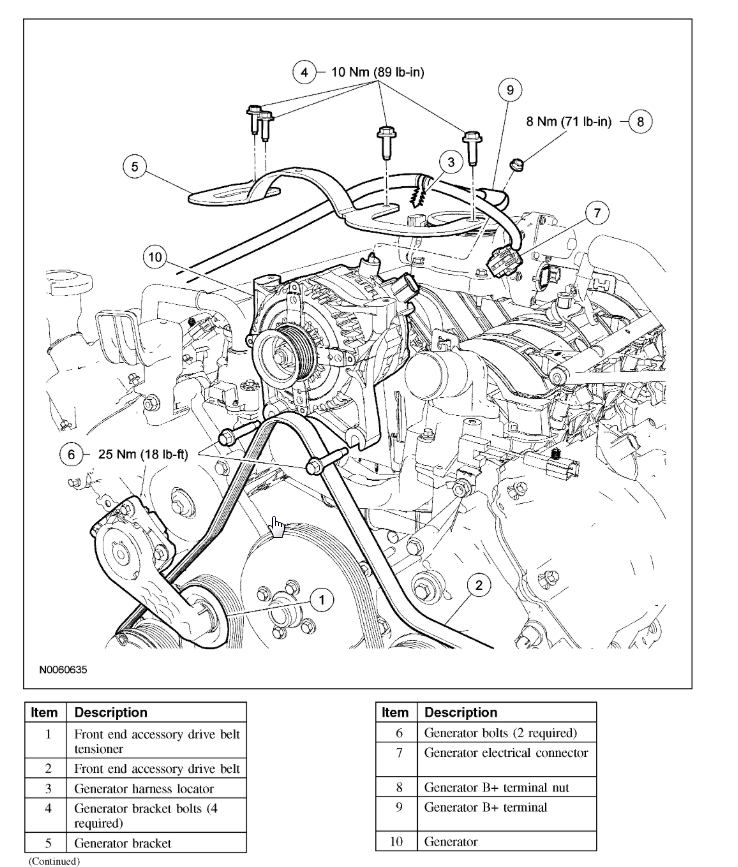

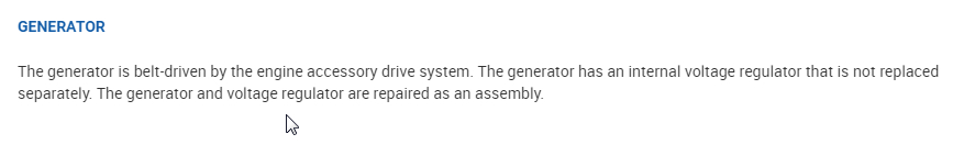

Okay, we need to test the alternator. I imagine the alternator has a faulty voltage regulator so if this happened after the replacement then your only option is to replace it again as this has an internal regulator and is not service separate.
Let me know what happens. Thanks
