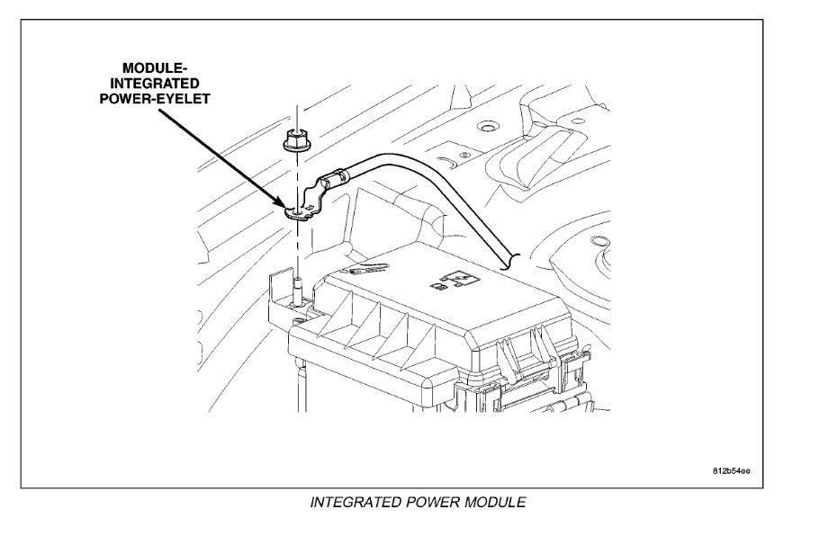

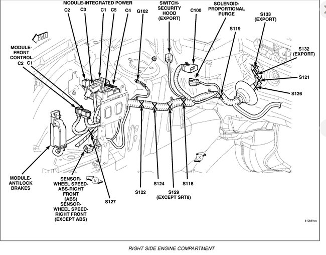

When a battery gets connected backwards, you could have different items circuits/fuses to go bad.
First check the battery fuses.
There are 2 battery fuses in the fuse box that is located in the trunk. They should be number 2 and number 4, both 40A fuse.
This vehicle also got a 6 ga fusible link that could blow as well.
It can also damage the integrated power module.
Let me know what you find.
