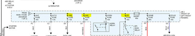

Few fuses did blow and were replaced. It turns over fine and new alternator and fuel pump were and battery were put in after switching terminals to correct position. Don't know what else to check, coils and plugs don't seem to be getting fire to concerned it nay be ECM or igniter though these are least common to happen normally. Any suggestions?

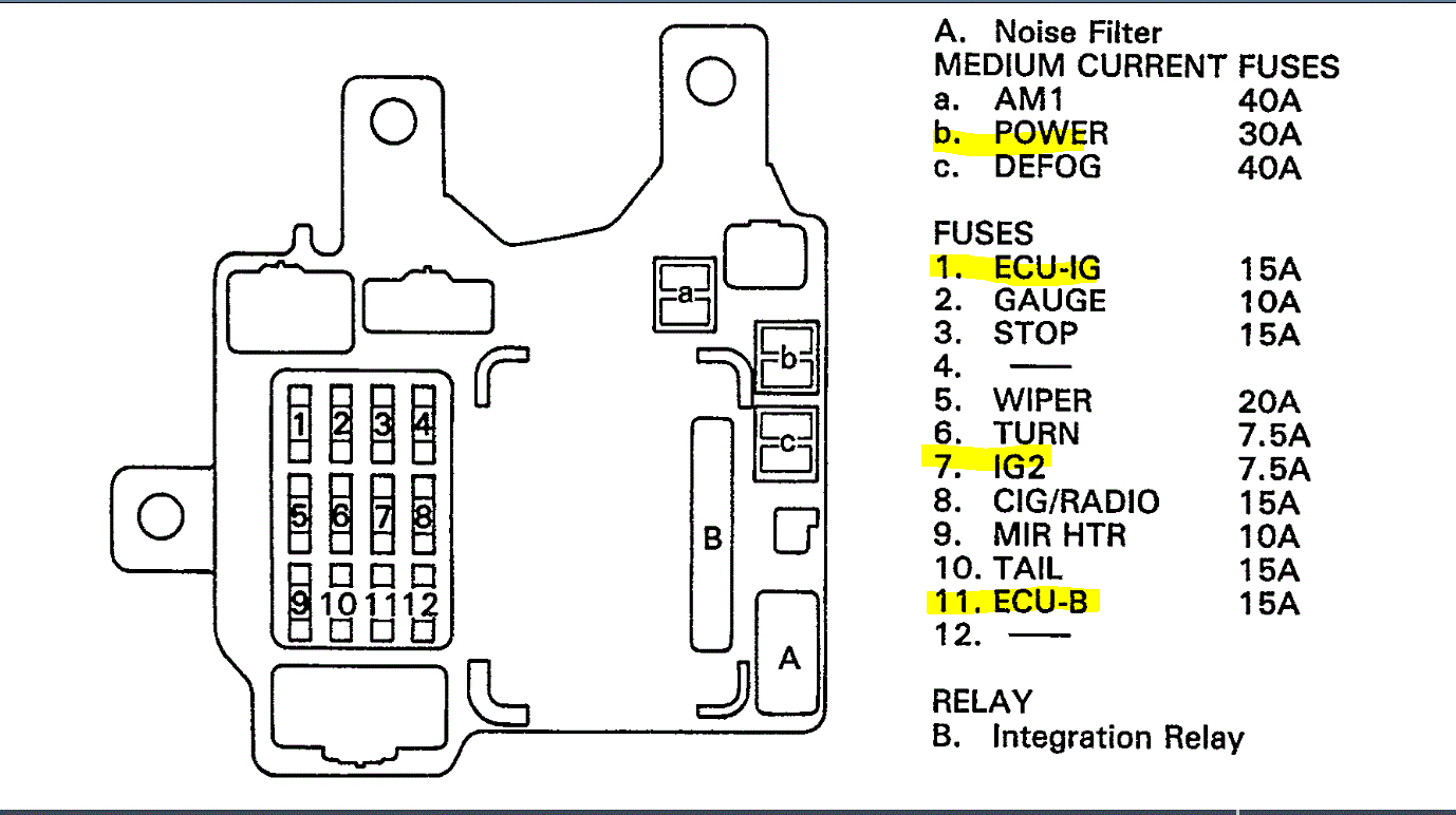

I need you to check a few fuses for me. When checking, not only confirm the fuse is good, but make sure power is available to it.

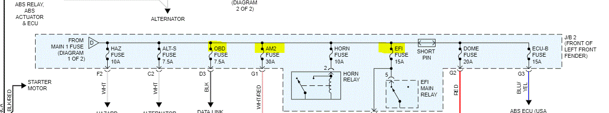

Picture 1 is the fuse box under the left side of the instrument panel. Check the highlighted fuses. Picture 2 is from a schematic. Check the fuses indicated. The EFI fuse powers the ECU, so check that as well.
Let me know note that it is important to confirm power is to these fuses. If there isn't, then we have a problem before the fuse box.

Chances are it isn't a major issue. I suspect there is a fuse issue. Make sure the main heavy amperage fuses are in good condition. Those fuses power the smaller fuse boxes.
Let me know what you find.

We've checked all the main fuses under the hood in the fuse box located behind the battery also we've checked all the fuses on the inside located underneath the instrument panel. Originally there were a few that were blown but we have replaced them and checked all of them again and there were none that were blown then but the car will still not start. I just ordered a new ECM assuming that it did burn up that module since we don't know what else it could be. I also ordered an igniter because I was told that could be a problem also.

When you replaced the fuses, did you confirm there was power to them? Something may have caused a problem before the power even gets to them.

Replaced ECU and igniter then car started right up so problem fixed. Thanks for all the help and information everyone sent!
