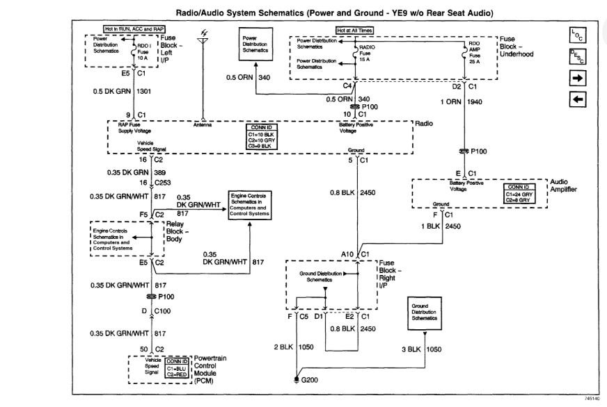

I did a test with my digital ohm meter between the battery post and the terminal connector on the negative side. The problem is the hood light comes on still. When I probe just the negative side to test it goes from 9.00 to 14.00 when the light comes on. Also, when I pull the fuse that says rdo amp it drops to 09. Any thoughts on this?

When you are looking for a parasitic draw, you measure current draw, not voltage. You need to remove the negative battery cable and put one lead of your meter to the cable and one to the battery terminal. Set the meter to amp scale. Let the car sit for about fifteen minutes and see what the measurements. It should be 50-75 milliamps.
If it is more, pull fuses one by one until the draw comes down. That will tell you the circuit that is causing the draw. If it is normal, then it could be a shorted battery draining itself down.

I did that and the fuse that says edo amp is the only one that made a difference.

Sorry, RDO AMP.

That fuse powers up the radio. It is very possible that the radio itself is causing the drain. You would need to remove it and have it tested at a radio repair shop to confirm.
