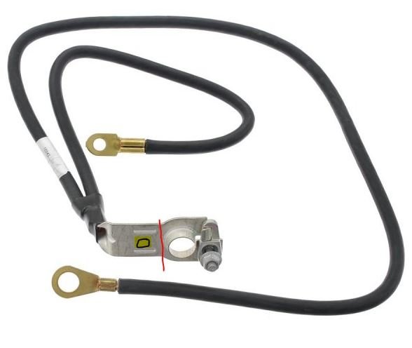

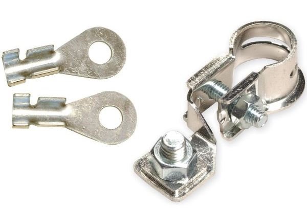

It sounds like a perfect mix. A bad battery that likely has a bad cell, corroded battery terminals that are not letting the battery charge properly. The fast clicking says the battery is at least very weak, however if it was that cold and the battery was already discharged it is likely that it also froze and shorted it internally, that is why the pack drained fast without starting it. If it still has the OE negative cable with the end like the one in the first picture you can replace that connector. Take a hacksaw or similar, no power tools that can create a spark though, you don't want to chance an exploding battery. Cut the terminal off at the line, then drill a hole to match the size of the bolt in a lead free terminal like the second picture. Bolt the terminal to the cable and install it. Clean up the positive terminal and after you install them both give them a coating of dielectric grease.
Now once you get it started I would run a charging system test to be sure the alternator is still okay.
The reason for the load test is the way you said you needed to keep giving it more gas to stay running at times, low battery voltage can do a lot of things so it's possible the alternator is starting to fail.

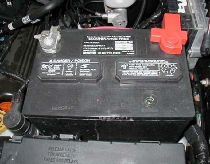

Thank you for your reply. Actually the battery terminals are a weird box shape. I'm going to try to grip the end of the threads on the bolt with vice grips and use a hand wrench to try to get that bolt off before I use a hacksaw. While I have been waiting for daylight I've had a lot of time to think. The guy I bought it from had taken the factory radio/CD player out and put a cheap radio/CD player in it the day before I bought it. I was using it Friday on my 250-mile round trip and I'm not sure I turned it off. Normally that shouldn't matter depending on how he hooked it up. I had an 1989 Ford Motorhome last year and I left the radio on and just turned the key off. I had a drained battery the next day. When I had to give this vehicle some gas to keep it running I immediately thought of a weak battery. Been there before. I figure if he swapped radios he most likely swapped batteries too. A friend was with me and said give it gas the next time you try to start it. I have never ever had to give any of my vehicle's gas when starting it. Okay, one hour until daylight. Time to make some coffee, get dressed, and gather my tools. Thank again!

Okay, yours has the earlier version that looks like these. Those bolts can be replaced if needed as can the ends using about the same process as above. If the radio was just replaced it could be connected wrong and drained the battery. If you have a second vehicle you could pull the battery and take it to be tested, some parts stores do that free. If you think it has a constant drain there are ways to test for those.

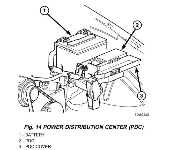

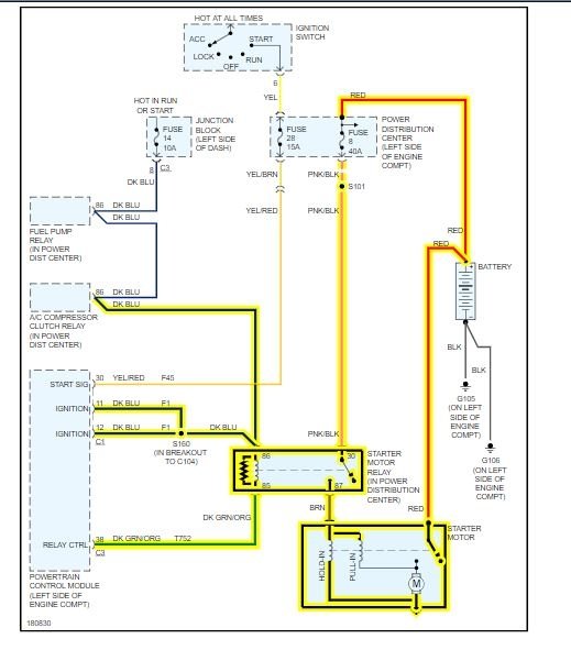

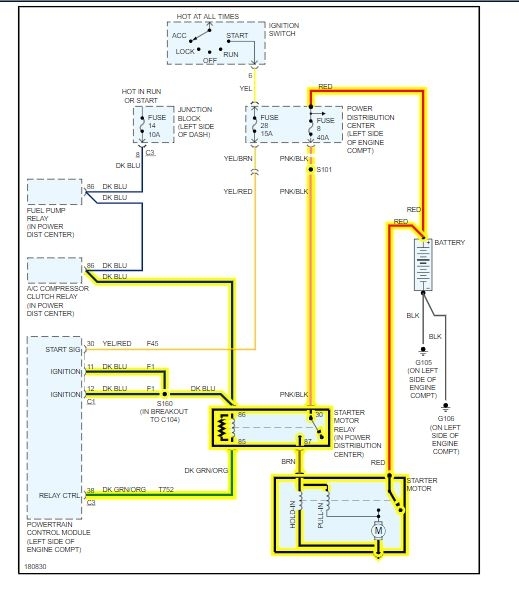

Good evening,
I would start at basics and test the battery. I attached some guides for you to follow for the testing.
https://www.2carpros.com/articles/car-battery-dead-overnight
I also attached the wiring diagram for the starter for you as well.
REMOVAL
The starter relay is located in the Power Distribution Center (PDC) (Fig. 14). Refer to label on PDC cover for relay location.
1. Remove PDC cover.
2. Remove relay from PDC.
3. Check condition of relay terminals and PDC connector terminals for damage or corrosion. Repair if necessary before installing relay.
4. Check for pin height (pin height should be the same for all terminals within the PDC connector). Repair if necessary before installing relay.
INSTALLATION
1. Refer to Power Distribution Center (PDC) cover for starter relay location.
2. Install relay to PDC.
3. Install cover to PDC.
