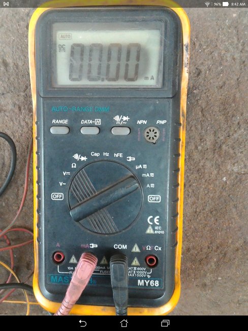

Set the voltmeter to DC amps and read the measurement. Look at the picture below and see if I set the multimeter correctly
Jan 18, 2022 at 11:52 PM
On the screen, does it say AC on the left side? Very blurry and hard to read.
Jan 18, 2022 at 11:56 PM
MALLYBOY
  • 329 POSTS

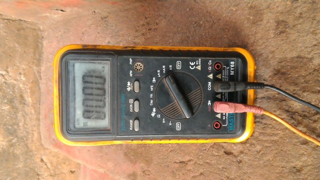

On the screen, does it say AC on the left side? It says DC on the left side and mA on bottom right of the screen.
Let me update another picture
Check and know if I set the multimeter to the scale correctly?
Jan 20, 2022 at 3:36 PM
The dial is set correctly.
Now press the range button until you see AC show up on the screen.
