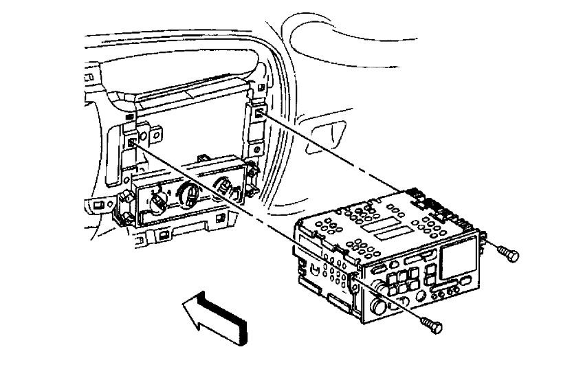

I have looked into removing the multi wire connector going to the radio and see that the dash has to just about be removed. Can you suggest a way of getting to the 12 volt connector on the back of the radio in a more convenient way? Thanks for the advice.

Procedure for removal.
It is for the AC clutch.
REMOVAL PROCEDURE
CAUTION: Refer to Battery Disconnect Caution in Cautions and Notices.
1. Disconnect the battery negative cable.
2. Remove the instrument panel accessory trim plate.
3. Remove the radio mounting screws.
4. Remove the radio.
5. Disconnect the electrical connector and the antenna lead.
INSTALLATION PROCEDURE
1. Connect the electrical connector and the antenna lead.
2. Install the radio.
3. Install the radio mounting screws.
Tighten
Tighten the screws to 1.9 N.m (17 lb in).

I guess I will put my cutting torch down and do it the way your recommend. Have a great weekend.

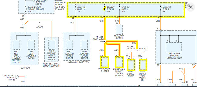

This is a confusing question. With the fuse out there would be no current in the ckt. When I put my amp meter in that is acting like a fuse and completes the ckt. The amp meter then reads 470 mil draw. With the fuse in and the radio out there is still the 470 mil draw. The fuse is labeled RDO battery but there has to be something on the line beside the radio..
Nov 18, 2019 at 5:56 AM
I attached the diagram of what is on the circuit.
Still waiting on an answer on the draw after the fuse is removed.
Nov 18, 2019 at 6:01 AM

With the fuse removed there is no current flow in that leg. With the fuse in and the radio removed there is the 470 mil flow. This would indicate there is something in the instrument cluster drawing this phantom current. Stupid question, where is the control for the instrument cluster or do I have to remove the entire cluster? Right now the dashboard is open due to having removed the radio. I am thinking about just putting a switch in to control the power to the instrument cluster and putting the radio constant 12v on another ckt. What do you think?
Oh, what is "in left seat harn" at junction "s266"? I had not thought of this being the problem.

The cluster and the HVAC controls are the other 2 on that circuit.
Where did you see this seat harness?
Nov 19, 2019 at 3:14 AM
JOHN SCHWARTZ
  • 18 POSTS
My bad, I was interpreting the diagram incorrectly. This might be a location definition for junction 266 showing all items are in the "left seat harness" where ever that might be. My climate control is the old fashoned knob adjust not electronic control. I have eliminated the radio so this leaves the instrument cluster. I would assume this has an electronic control for all and I guess this would be IN the instrument panel. I will look into how this is connected at least there is no flexible cable going up to the speedometer to disconnect.

It is the label S266 in your diagram in the vertical line between the fuse and the instrument cluster. Oh, I will definately go and check the AC Control Head. Thanks,
