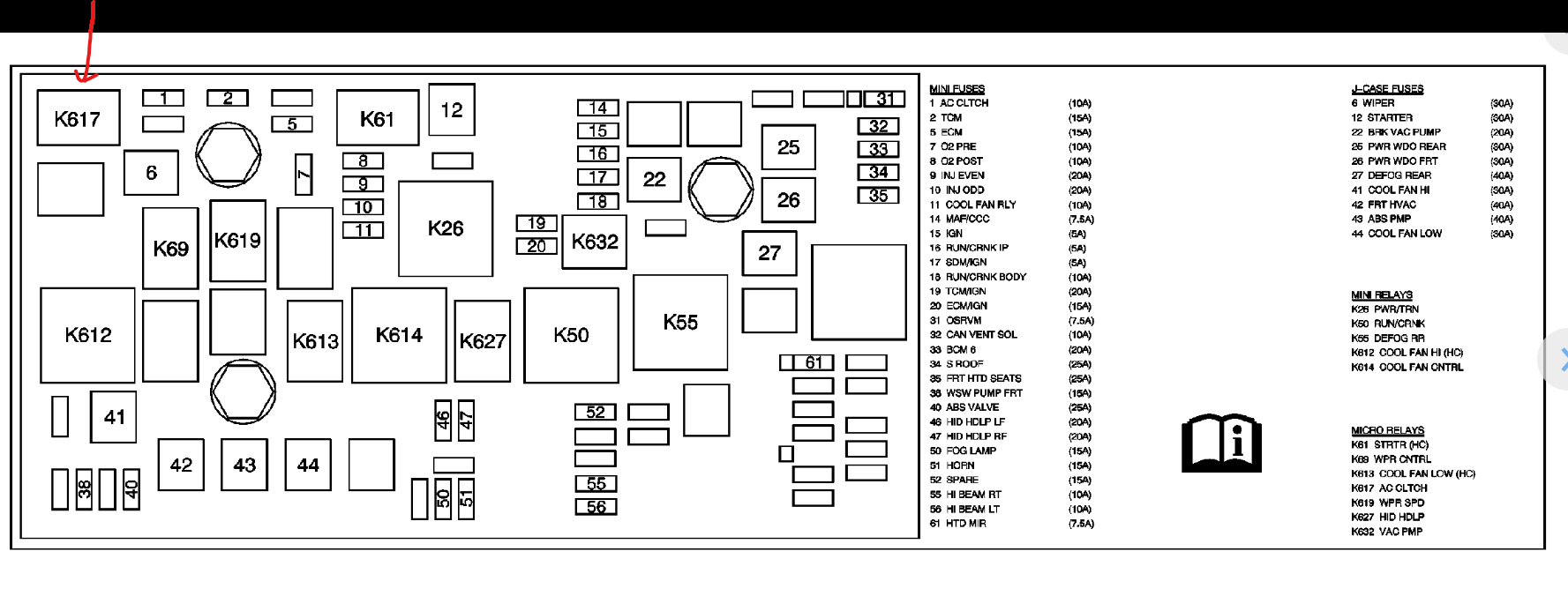

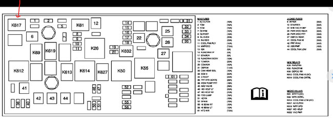

Lets try removing the AC compressor relay which I have seen stick on and drain the battery, here is the location just remove it and try the car for the next day or two. Here is the location which is in the fuse panel under the hood. Also, feel the alternator with your hand when the car has been sitting to see if it i warm. Check out the images (below). Please let us know what happens.
