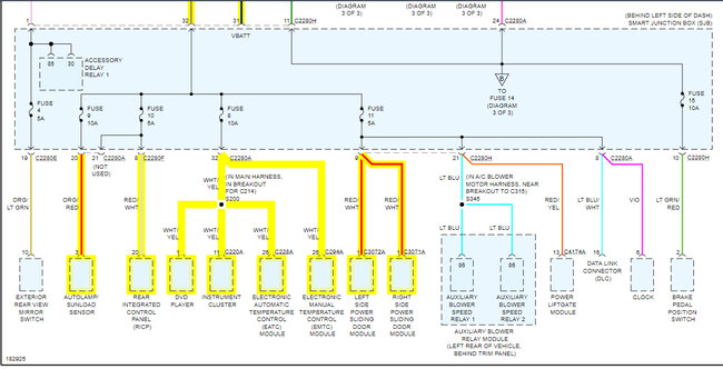

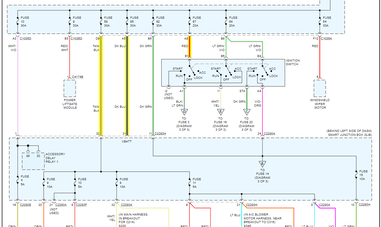

I have a problem with the power consumption. When everything is off, it consumes 0.38 amps. The normal is rather 0.05 amps. I changed the battery and the problem is still present. By doing several tests, I reduced the problematic circuits to 3 fuses: F-58, F-65 and F-67
F-58: SJB #1 - Center High-Mounted Stop Lamp (CHMSL), License plate lamps, OBD II, Dome lamp, Auxiliary blend doors, Switch illumination (feeds F-8, F-9, F-10 and F-11).
F-65: SJB #2 - Left cornering/auxiliary lamps, Left low beam, Right front park/turn lamps, Right rear park/stop/turn lamps, Puddle lamps, Mirror signals, Visors, 2nd and 3rd row lamps, Cargo lamp, Defroster indicator.
F-67: Ignition switch #2 feed.

Good morning,
You are on the right path.
Fuse 58 is a problem since it controls so much. I attached a diagram of what it controls. You will need to remove the fuses it controls one by one to see if you can get the milliamps down to 50 to 75.
https://www.2carpros.com/articles/car-battery-dead-overnight

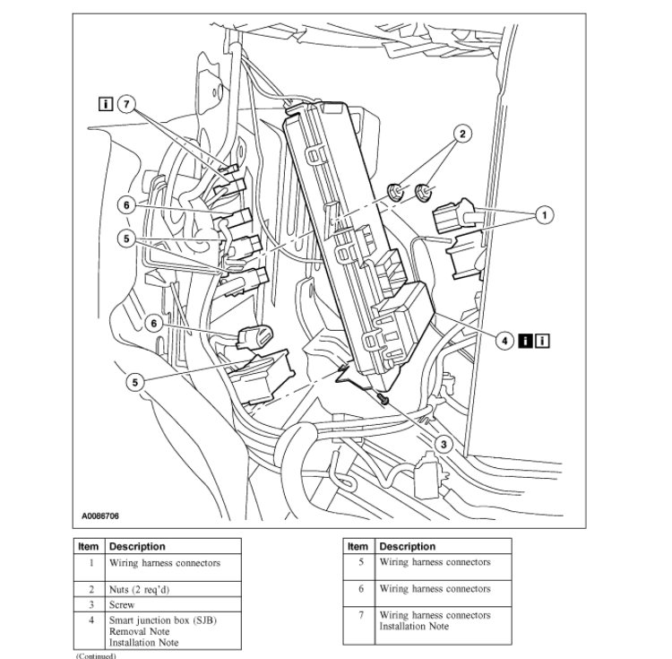

If all the fuses out for 58 and it still has the drain, good chance the SJB is the issue itself.
SMART JUNCTION BOX (SJB)
REMOVAL
1. CAUTION:
- Prior to the removal of the module, it is necessary to upload module configuration information to the appropriate diagnostic equipment. This information needs to be downloaded into the new module once installed.
- Electronic modules are sensitive to static electrical charges. If exposed to these charges, damage may result.
Disconnect the battery.
2. Remove the LH dash closeout panel.
3. Remove the parts in the order indicated in the illustration and table.
Item 4: Smart Junction Box (SJB) Removal Note
1. Position the SJB forward to allow access to the wiring harness connectors on the rear face of the SJB.
INSTALLATION
1. To install, reverse the removal procedure.
Item 4: Smart Junction Box (SJB) Installation Note
1. Once the SJB is installed, it is necessary to download the module configuration information from the diagnostic tool into the new module.
Item 7: Smart Junction Box (SJB) Installation Note
1. Make sure the coaxial connector is connected, or the remote keyless entry (RKE) system will experience diminished range.
