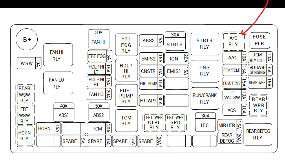

Yep, you have a drain for sure, I have seen the AC clutch relay stick on and drain the battery down on these cars, so lets remove it to see if the drain goes away. Also, this guide can help as well. Can ask of the car has an after market radio?
https://www.2carpros.com/articles/car-battery-dead-overnight
Here is the location of the A/C compressor relay. Check out the images (below). Ken

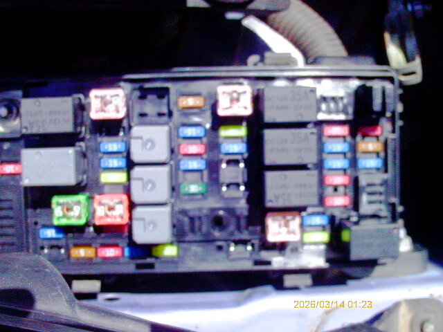

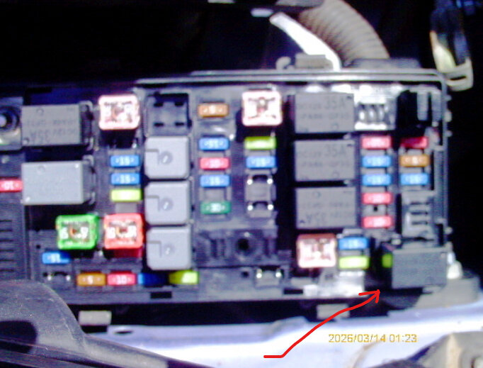

Hello, I am sorry for being late getting back to you on my car question. My wife passed away back in December, between trying to take care of our estate, lawyers, and car trouble I have been running here and there. Back to the car. The Chevy Spark Fuse Box doesn’t show an A/C RELAY. I am enclosing photo for you to look at. I will be waiting to hear back from you. To answer your question about the radio, the answer is no. Thanks Again for all the help you can give me.

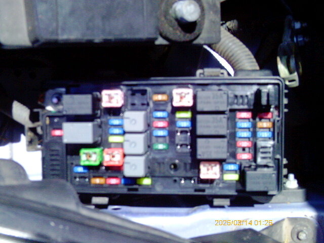

Here is another photo also.

I am sorry to hear about your wife, here is the location of the relay, if the relay is warm, (battery connected) this is your problem. Ken
