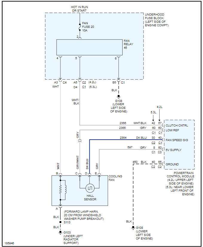

Car keeps overheating after awhile I used a radiator sealer but still overheats and when I’m driving the battery gauge starts going down until it’s off, but as soon as I get a jump it turns right on.Took it years back to the local mechanic they charged me $346.00. Then went and got the rocking on my vehicle fixed that cost me $987.00. Now a year later the car starts overheating battery draining and the car starts rocking side to side.Any advice i would appreciate it.

Okay, the battery was bad and the terminal bolts were stripped (side post)And the overheating I noticed the cap was a little worn out so replaced it. but still overheated. I noticed a little sizzle on top of the radiator.

Okay. So when does it overheat? Here is a guide that will get us started:
https://www.2carpros.com/articles/engine-overheating-or-running-hot
We need to start checking the things off the list but we need to start with when it overheats and then does the radiator fan run when the engine is overheating? If the fan is not on then we need to jump power to it. Here is a wiring diagram for your review.
Let me know if you have questions. Thanks
