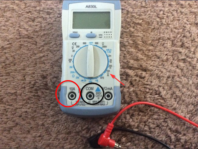

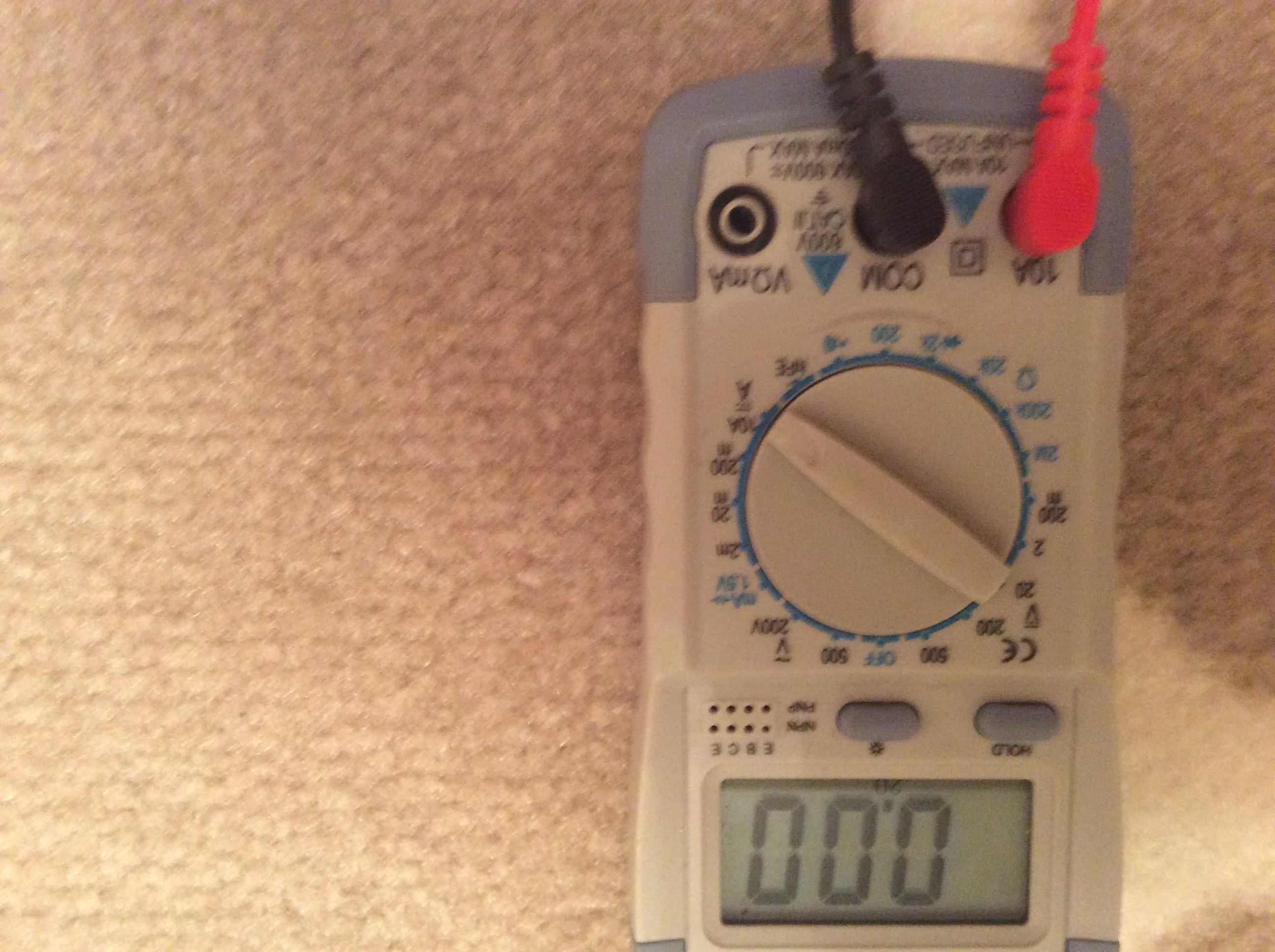

Here is pic of my device. Can you tell me where wires go and what to set it on.
Sep 13, 2021 at 10:28 AM

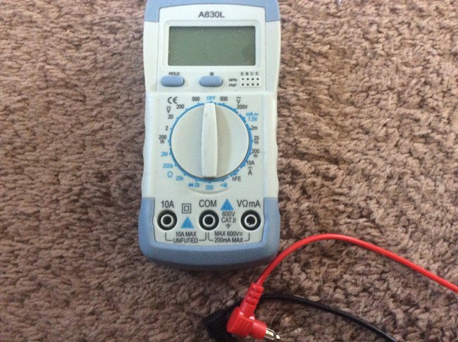

STARLORD1976
  • 173 POSTS
Here it is I think.
Sep 13, 2021 at 10:30 AM
Sure. Take a look at the picture below. You want to put it on amps and put the leads in the amperage ports.
Here is a guide that will help as well:
Please let us know what you find with this.
Sep 13, 2021 at 4:54 PM

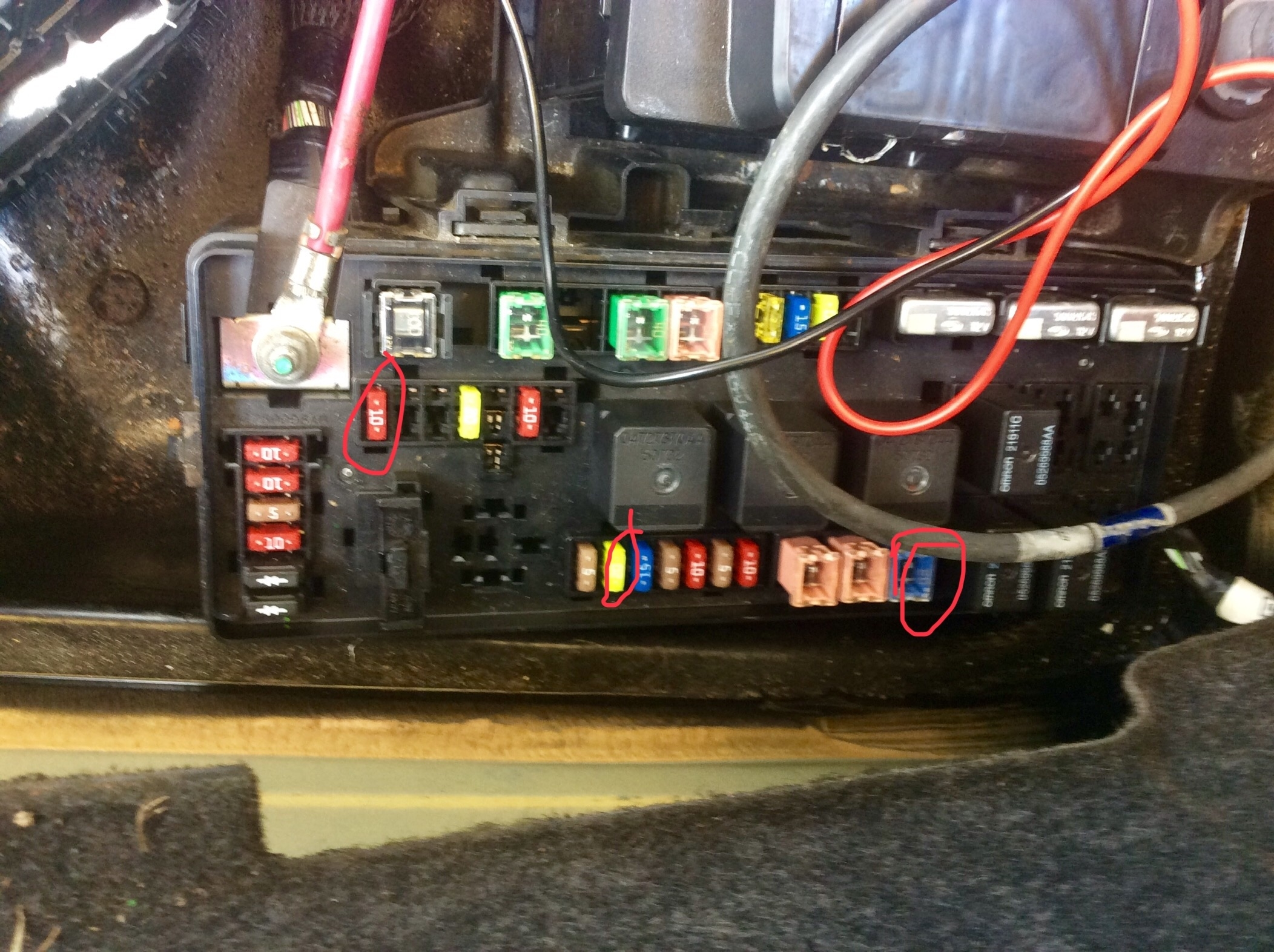

The battery is in the trunk, and which fuse box do I start with? There are a couple of them.
Sep 13, 2021 at 8:09 PM
Correct. I did say hood lamp because you have a fuse box under the hood so you need it open and that is going to wake up this electrical system if you open it while doing this test and that is going to be misleading.
You can start with any fuse box that you want to because we don't know what is causing this so we just need to start working through all the fuses until we find which one causes the voltage to drop.
This is a vehicle that has a PDC so if you get all through all the fuses and none of them dropped the amperage then we are going to have to start unhooking modules but let's get to that later if needed.
I need to stress that you need to open the doors and hood and flip the latches and then let it sit to allow the system to go back to sleep. If you start doing this before the network is asleep you are going to get incorrect results. So if when you hook this up and have 2.5 amps then give it 10-15 minutes and it should drop when the network goes to sleep.
Then where that settles is what your draw is. Remove fuses at that point until it drops to around 35 milliamps. That will most likely show on your meter as .035 amps.
Sep 14, 2021 at 7:58 AM
STARLORD1976
  • 173 POSTS

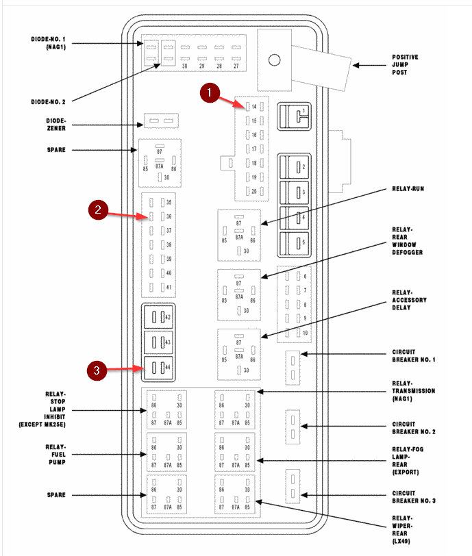

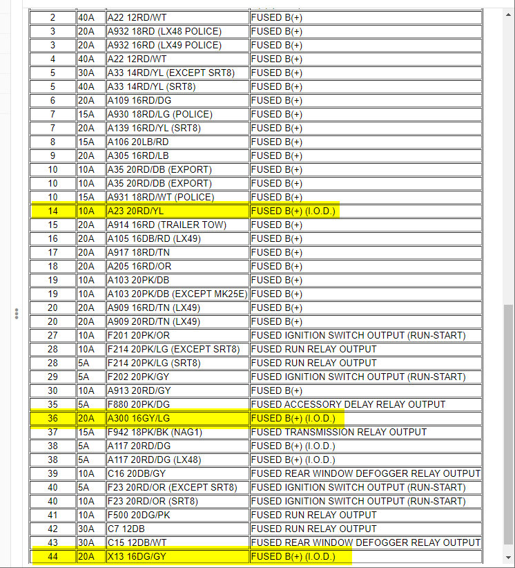

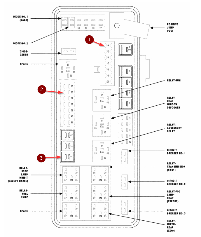

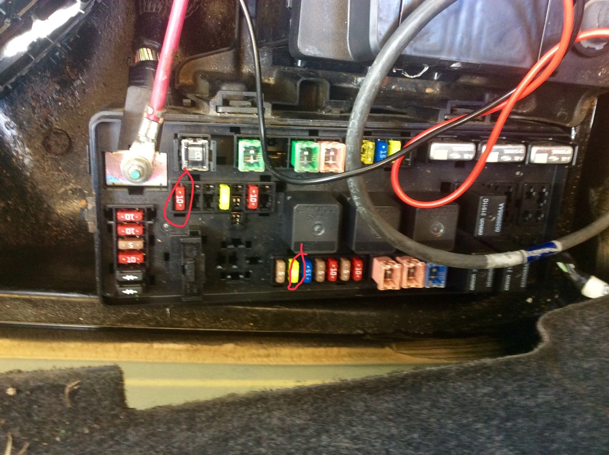

So far i did the fuses in the trunk and there were two that came down, but with them both out it still reads 0.95. so should I check more fuses and do you know what the fuses I circled goes to? Thanks
Sep 14, 2021 at 9:38 AM
STARLORD1976
  • 173 POSTS
Follow up. I unplugged both fuses and the bigger blue fuse and now reads 0.32.
Sep 14, 2021 at 11:28 AM

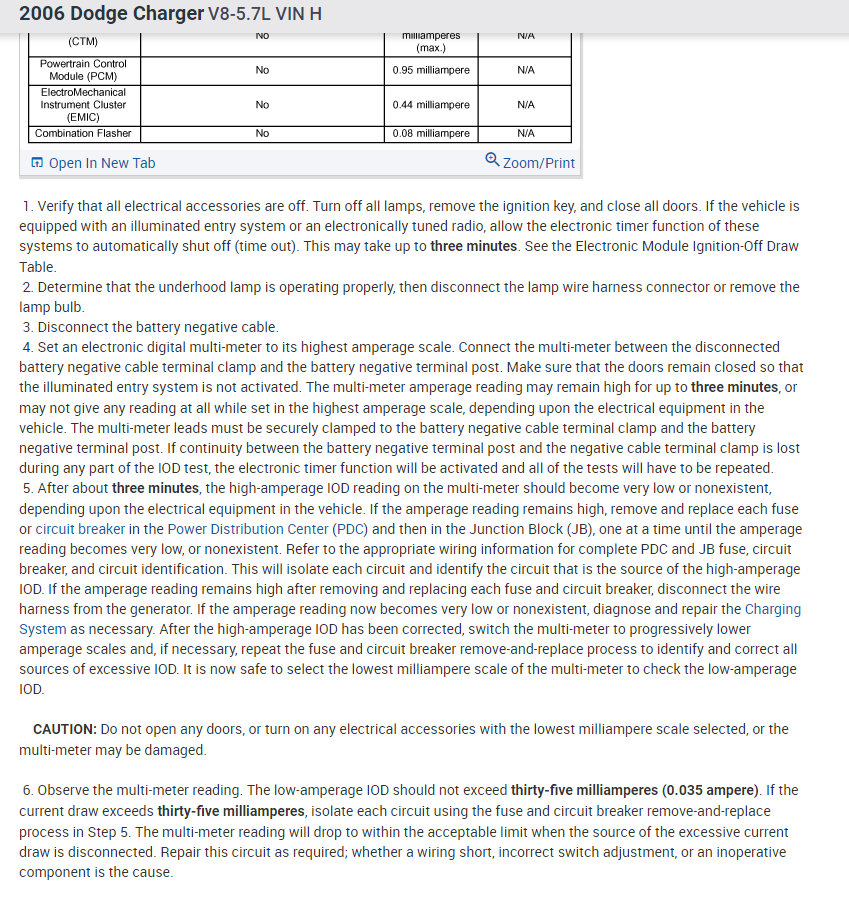

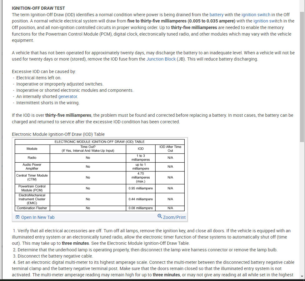

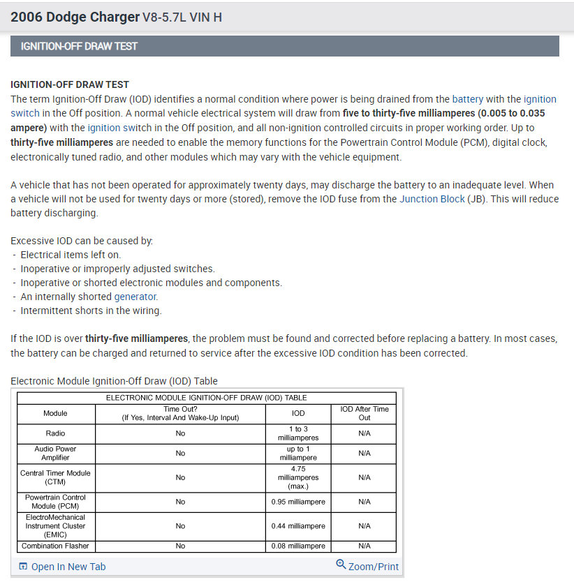

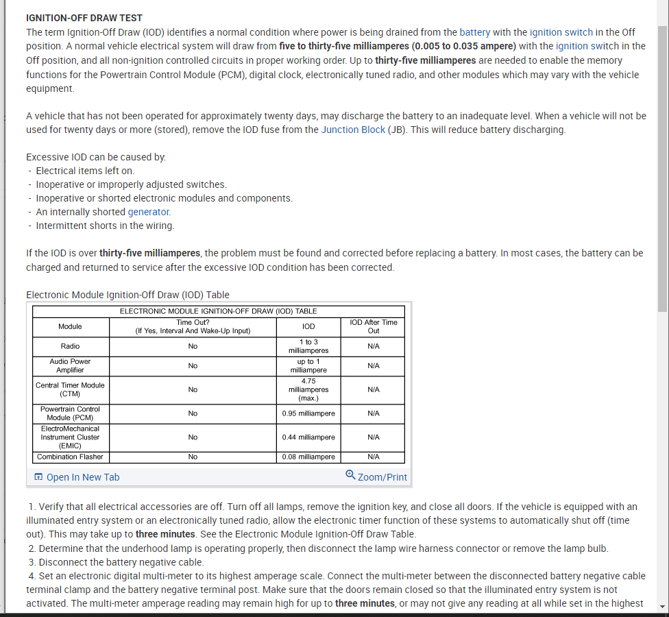

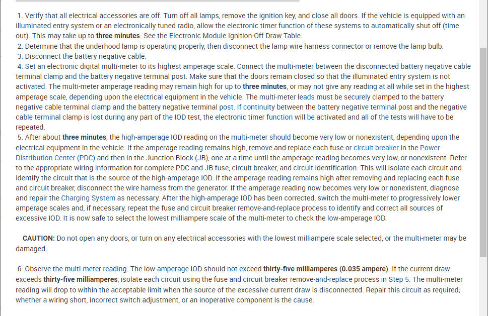

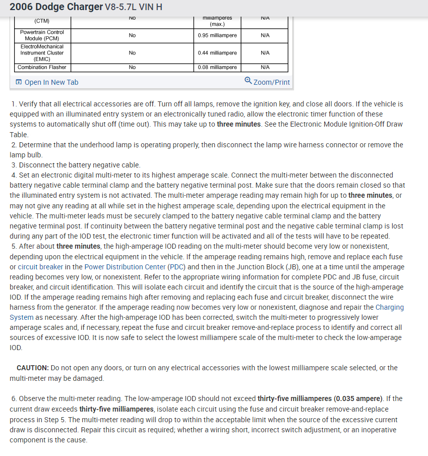

These are IOD fuses and I don't think they are the issue. Even if they are contributing to it, if that is .32 amps it is still too high. You need to be down around .035 amps.
I am attaching the info below on the IOD system as these are systems that need to keep memory alive so they are going to be drawing amperage with the key off.
Please read through this info and then keep going with removing more fuses. Also, are you waiting about 10 minutes and are all the doors closed or the latches flipped so that they think it is closed?
Sep 14, 2021 at 4:40 PM

STARLORD1976
  • 173 POSTS
Can you verify this is set correct?
Sep 14, 2021 at 5:05 PM
Yes. That is set up correctly.
Again, due to not knowing what the draw is, we need to just start with one of the fuse boxes. If it were me, I would go with the one inside the car and see what happens.
Thanks
Sep 14, 2021 at 7:43 PM
