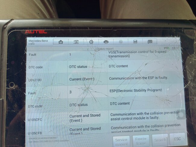

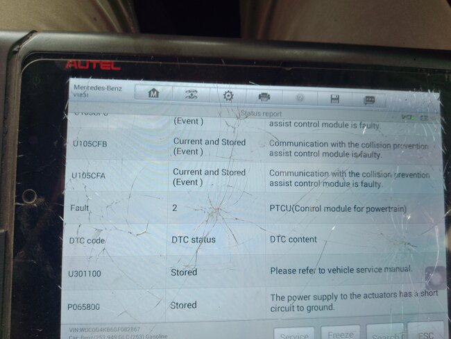

The following are the codes that were present when scanned.
Feb 26, 2025 at 12:26 AM

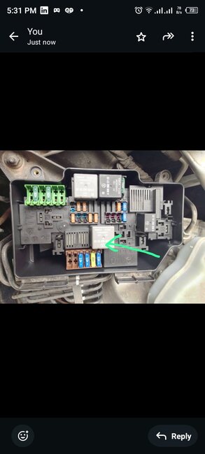

I observed that the relay clicks sometimes even when the Engine is off, and the doors are looked. I don't know what it is controlling. Is it how it supposed to be clicking sometimes?
Feb 26, 2025 at 12:35 AM
  • 55,732 POSTS
With all these codes it seems like a module is not working correctly, I would clear the codes and then turn the system on without starting the engine and then run the codes again. I believe the relay is for the start stop function, does the battery draw stop when you remove the relay?

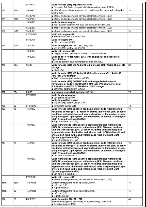

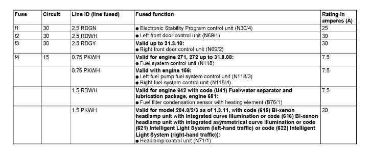

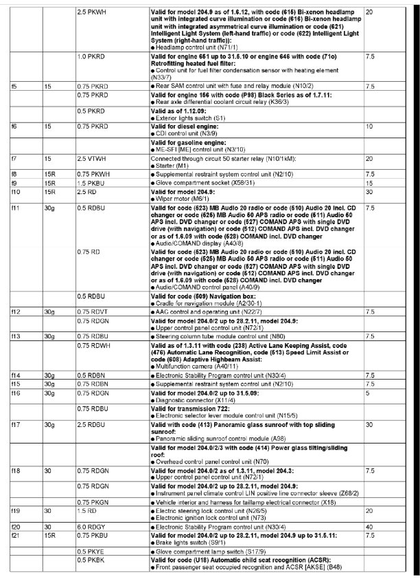

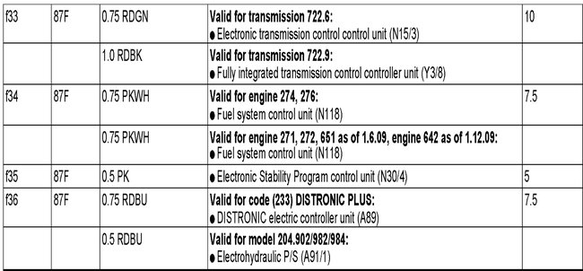

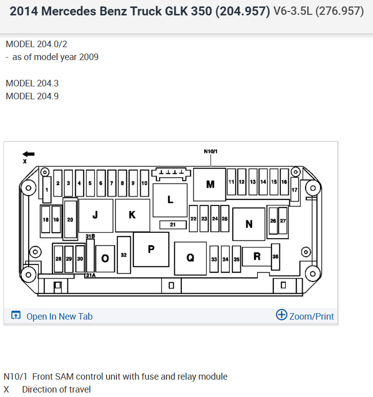

  • 55,732 POSTS
Here is the layout for the fuse panel. Check out the images (below). Please let us know what happens.
