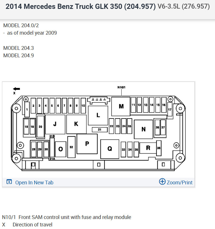

Hello, the vehicle is 2014 GLC 300. The vehicle always was noticed that the battery is been drained overnight. When the ammeter is connected in series with the battery, it was reading 12A which is very high for a vehicle that the engine is not running neither the accessories. The fuses was removed one after another to know the circuit pulling high current, none was found to pull such voltage. With all the fuses removed the reading on the ammeter was still high.
How could this diagnosis further?
Could I have the power distribution for the vehicle?
Thank you very much.

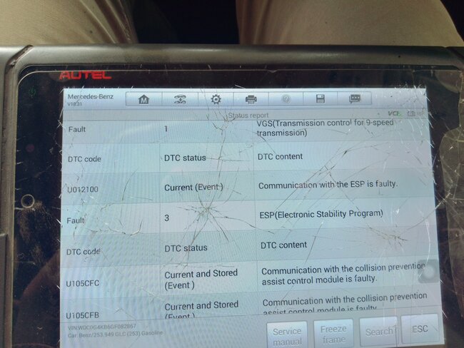

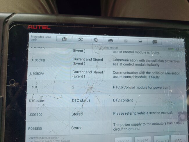

The following are the codes that were present when scanned.
Feb 26, 2025 at 12:26 AM

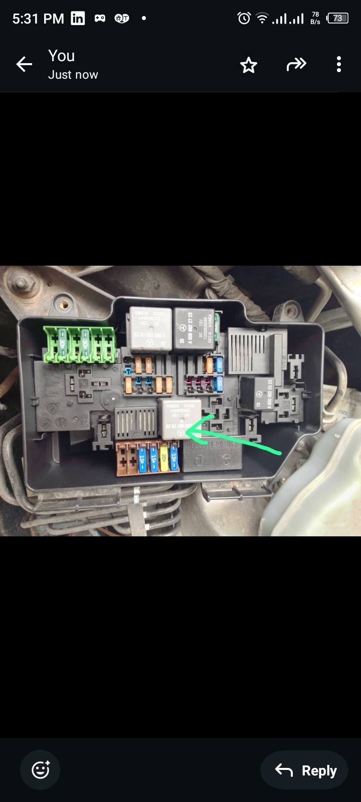

I observed that the relay clicks sometimes even when the Engine is off, and the doors are looked. I don't know what it is controlling. Is it how it supposed to be clicking sometimes?

  • 55,381 POSTS
With all these codes it seems like a module is not working correctly, I would clear the codes and then turn the system on without starting the engine and then run the codes again. I believe the relay is for the start stop function, does the battery draw stop when you remove the relay?

BLESSING EWOBOR
  • 753 POSTS
I have not removed the relay. I want to know what is controlling.

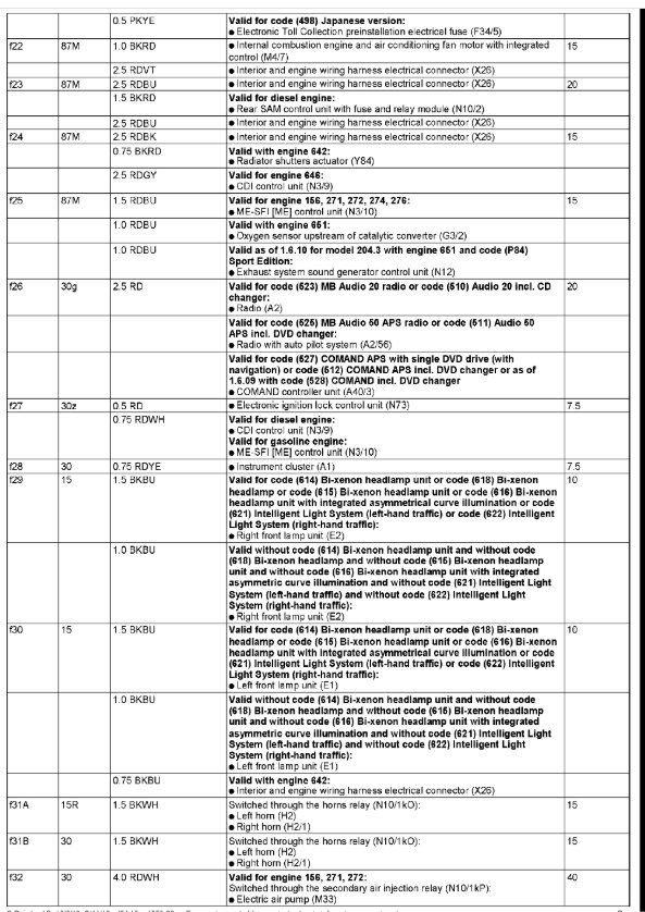

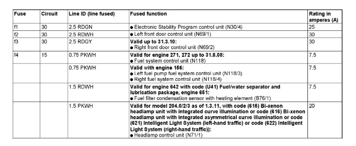

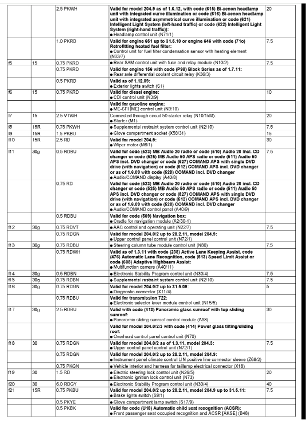

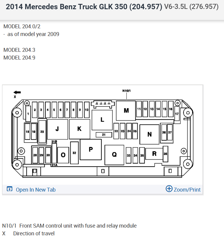

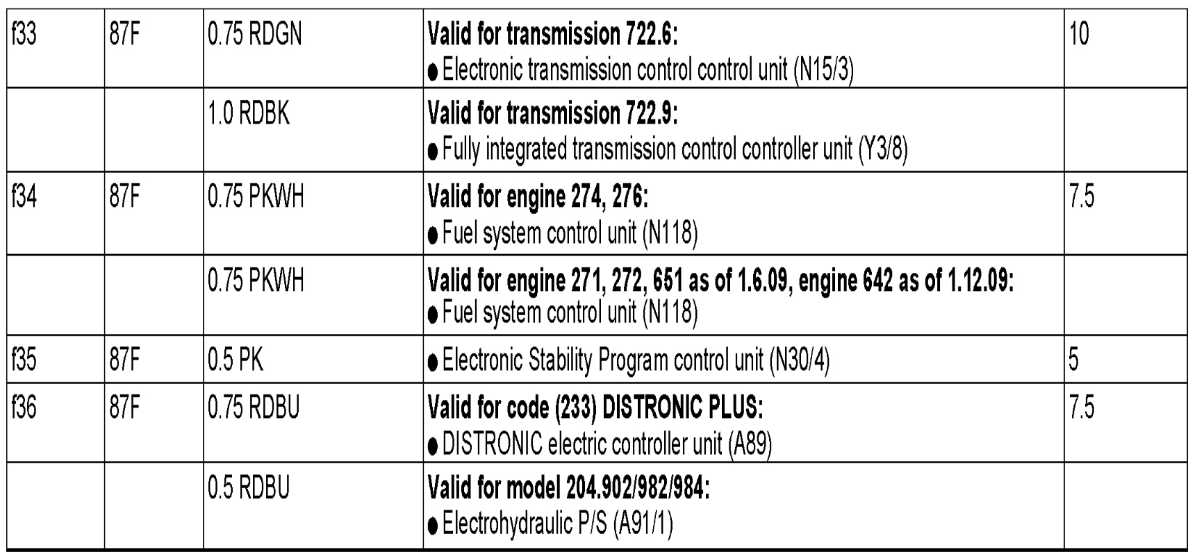

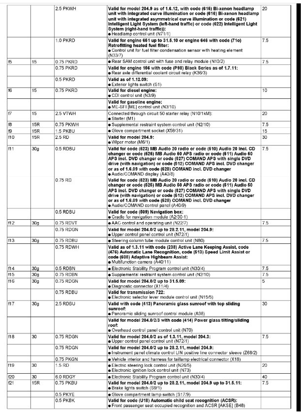

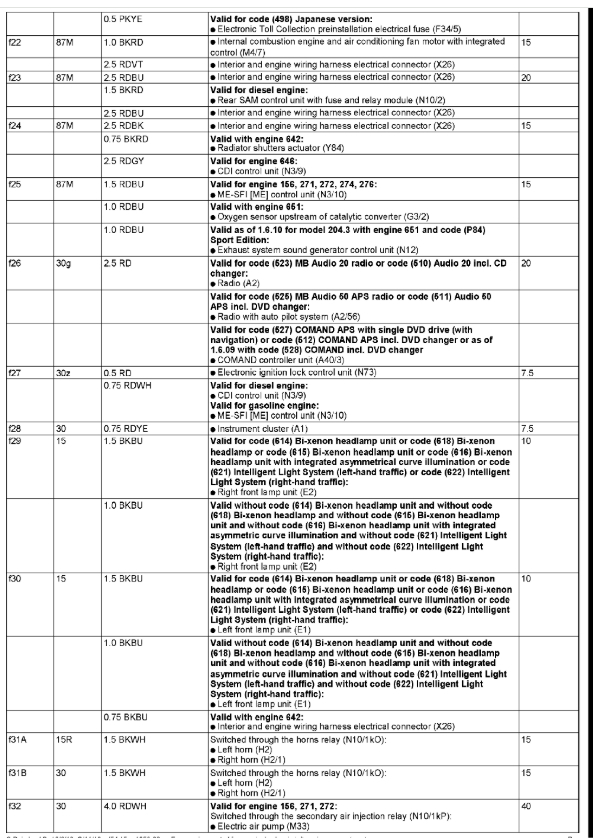

  • 55,381 POSTS
Here is the layout for the fuse panel. Check out the images (below). Please let us know what happens.
Feb 28, 2025 at 12:42 AM
