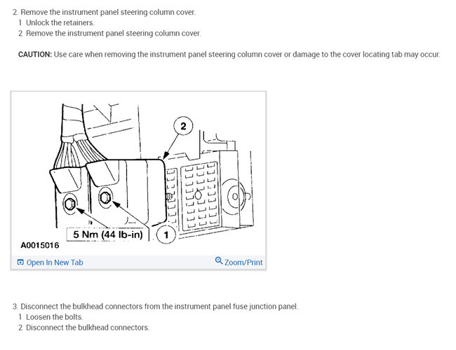

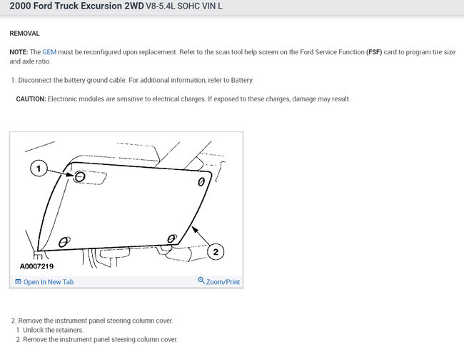

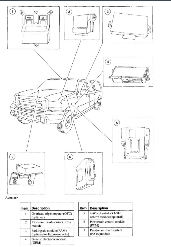

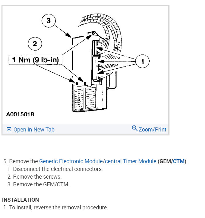

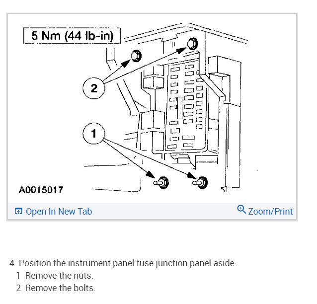

Let's check the battery with this load test first.
if it passes I have seen the GEM cause this issue lets unplug it and let the truck sit to see if it cranks over okay.
