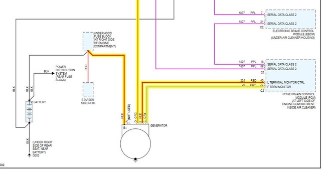

we have changed the alternator twice and the battery is still being drained. any idea of what is happening before we go in a third time?

not charging why car is running.
Nov 29, 2019 at 8:27 AM

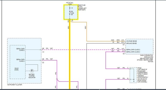

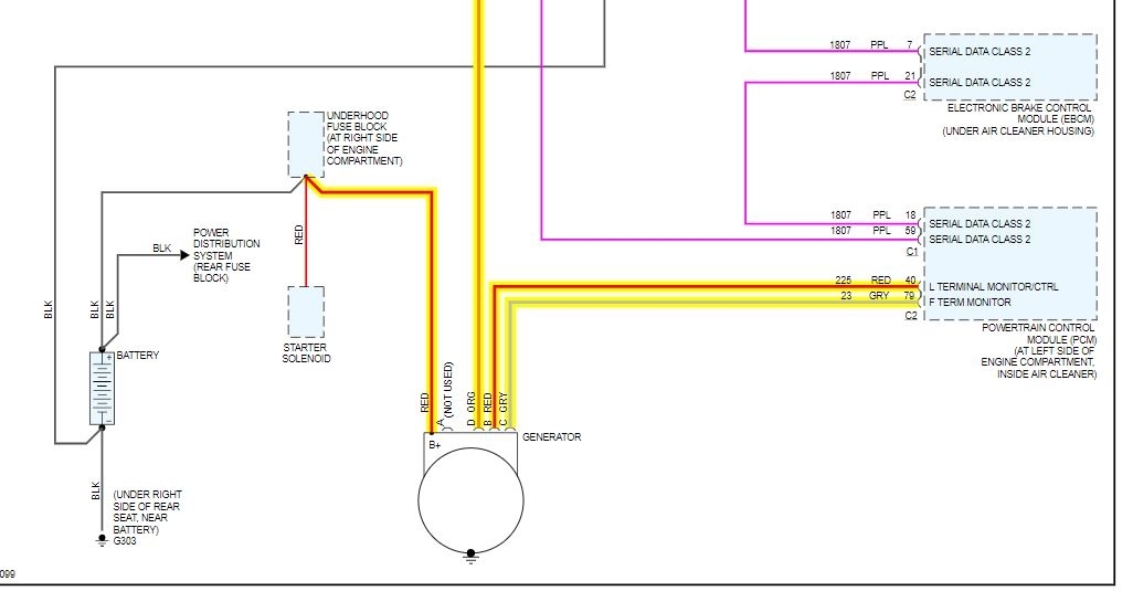

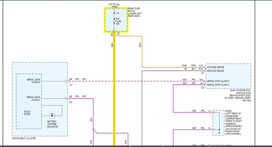

Okay, I attached a wiring diagram for you to view.
Make sure the red and the orange wires are hot at all times.
If they are, the PCM controls turning on and off the alternator regulator as load increases.

it doesn't charge at idle.
Nov 29, 2019 at 8:46 AM
Okay. What is the charge rate at idle and at 1,200 RPM's?
Nov 29, 2019 at 8:47 AM
AB AUTOMOTIVEREPAIR TRANSMISSIONS
  • 107 POSTS
At 1,200 it wakes up and charges from 13.2 to 14.8 with no load, has new battery and rebuilt alternator, i'm going right now to check the ground underneath the backseat by the battery and I'm going to disconnect the ground on the frame by the engine, under 900 rpm it runs strictly on battery voltage and drops as low as 11.9, had my alternator re-builders check for battery drains and they tell me it has no battery drain, I repaired the oil leak at valve cover above alternator which was original cause of alternator going bad from hot oil leaking into it. I'm scratching my head it acts weird - it seems like PCM is turning it on a little too late. it does not react instantly to load- if I put a window down it dumps half a volt and needs rpm increase in order to respond to a load. Any help would be appreciated greatly, I also went ahead and put in a brand new belt.

Got it.
Just something simple, is the belt tensioner in good shape? The alternator is not slipping around the belt?
If all that is good, then looks like you need a PCM.
