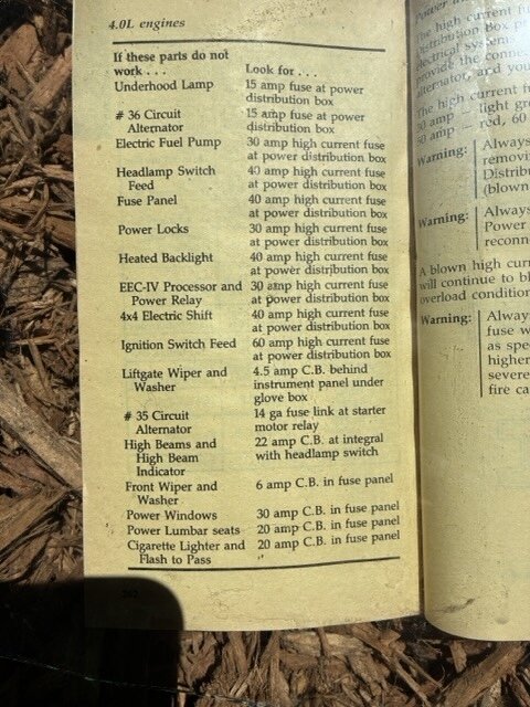

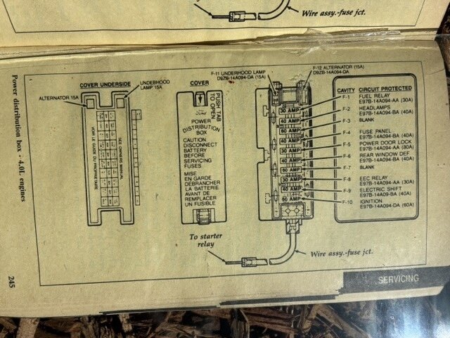

Ammeter on the battery lead shows 2.4 amp draw with everything off. Pulling the 15A "under-hood lamp" fuse (in the power distribution box) reduces the draw to a presumably negligible 0.01A.
BUT when I start the truck, the charging warning icon (little red battery) comes on.
If I reinstall the fuse, the charging warning goes away but the 2.4-amp parasitic draw comes back.
The manual implies that this fuse only affects the under-hood lamp, but this is apparently not the case.

I can't find a fuse layout drawing for the power distribution box under the hood, but based on your dandy observation, unplug the three-wire connector at the back / side of the generator, then see if the draw goes away. If it does, it suggests the voltage regulator is not turning off.
See if here are fuse numbers on that fuse box. I show fuses # 4 and 12 related to the charging system.

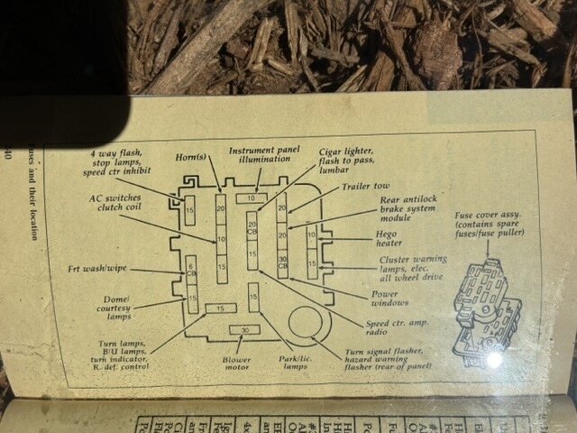

Thanks so much! Will study the diagrams in the manual and try your suggestion. By "that fuse box" I presume you mean the under-hood power distribution box near the battery, and not the fuse panel in the driver-side footwell? Back shortly.
May 12, 2025 at 5:17 AM
ROBLEWIS
  • 17 POSTS
Okay, this makes a lot more sense!
I apparently misinterpreted the diagram of the power distribution box. The fuse I've been pulling is NOT F-11, the under-hood lamp fuse, but rather F-12, labeled "Alternator".
Because when I unplug the 3-wire connector at the rear of the alternator, the current drain stops immediately.
You say this suggests a bad voltage regulator. Is this a separate part, or perhaps built into the alternator? Is it something a modestly capable DIYer could tackle?
(Not that it's significant, but I noticed that the current drain started out around 2.5A and slowly declined to 2.2A as I was working.)
I'm attaching 3 pages from the owner's manual if that helps. Thank you again!

Wonderful. The maximum current the generator's field circuit can draw is close to 3.0 amps. That's with the engine running and system voltage up to 14.5 volts. At 12.6 volts with the engine off, current flow through the field circuit will be a little lower. Factor in the normal resistance in the wires, and 2.4 amps is exactly what we'd expect to see for that drain. The reason your current drops a little is likely due to other computers timing out and turning off. On newer vehicles that can be as much as three amps that takes up to 20 minutes to go to "sleep" mode.
The first thing you should do, with the ignition switch off, is to check that the "Battery" light on the dash is not on. If it is, one section of the ignition switch is melted and staying on, and that will keep the voltage regulator on. If that light is not on, continue on.
The circuit in question is the yellow / white wire in that three-wire plug. That is tied directly to battery voltage all the time, but current flow is supposed to be blocked by the voltage regulator. (That's what's not happening now). Normal operation is to turn the ignition switch to "run", then current flows through the dash "Battery" warning light, then down through the green / red wire in the three-wire plug. Roughly ten volts is dropped across the bulb to light it up, leaving about 2.5 volts at the plug. If you'd care to measure that, it must be done with the connector plugged in. You reach the terminal with the voltmeter's probe by poking it through the rubber weather seal around that wire.
The 2.5 volts on the green / red wire is what wakes up the voltage regulator and causes it to turn on. At that point current flows through the yellow / white wire, the rotating field winding, (rotor), the voltage regulator circuitry, then to ground and back to the battery.

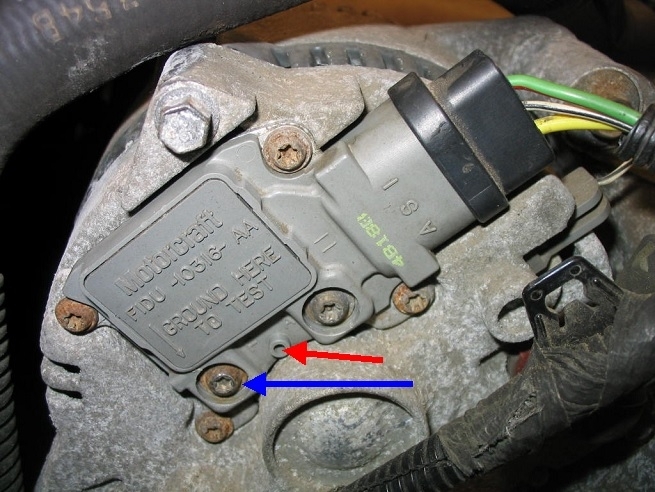

This photo below shows the back of the generator on a Tempo that I built in "bugs" for my students to diagnose. Yours should look the same, but you may need to remove the generator from the engine. On Tempos, the regulator could be replaced without removing the generator. The engineers must have figured out this was too easy, so by the late '90s models they added a stamped tin cover to the back of the generator to be sure it was more difficult to work on.
For future reference, when you have a no-charge condition, one of the potential suspects is a failed regulator. You can bypass it by using a piece of wire or stretched-out paper clip to ground the test point my blue arrow is pointing to. You'll need to scratch around a little to break through any corrosion, and of course, this has to be done with the engine running. Turn the headlights on or connect a voltmeter to the battery to indicate system voltage. When you ground the test point to bypass a failed regulator, the lights will get noticeably brighter, and battery voltage will rise from around 12.6 volts to over 15.0 volts. Don't raise engine speed during this test as it is possible for system voltage to go high enough to damage computers and burn out any bulbs that are turned on.
Another common failure on all brands and models is worn brushes that pass the current to the spinning field winding. On this design, the brushes are bolted right to the voltage regulator, so you get new brushes with the new regulator. Once you can get to the back of the generator, remove the four torx screws in the four corners of the regulator. The "Ground here to test" screw, (blue arrow), and its mate on the other side don't get touched for this service. It's the other four, in the corners, you must remove, then the regulator pulls straight out.
The new regulator will come with a small wooden stick in the hole with the red arrow. Don't pull that stick out, . . . yet. Bolt on the new regulator, then spin the pulley to be sure nothing is binding or hitting, THEN it's okay to remove the stick. It can stick a little. You might need a needle nose pliers to pull it out. As you do, you'll hear two light clicks as the spring-loaded brushes snap into place. If the regulator is removed now, those brushes must be reloaded into their holder before reinstalling the regulator.

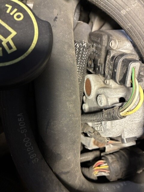

Hey, Doc. Taking things one step at a time here:
With the F-12 Alternator fuse in place and ignition off, there is no "Battery" warning light on the dash, so I guess that's good.
Attached is the best photo I could get of the rear of my alternator without removing it. I guess the thing that the 3-wire plug attaches to is the voltage regulator, right? Since they aren't very expensive, what about just replacing it and seeing if that fixes the problem? Might this be possible with the alternator in place?

You might also do that "Ground here to test" procedure by grounding that screw with the engine running. Keep engine at idle speed, but the voltage should rise significantly. If it stays in the lower 13s, there may be a defective diode. When one of the six of them fails, you lose exactly two thirds of the generator's current-producing capacity. That's usually not enough to meet the demands of the electrical system under all conditions, so the battery may run down over days or weeks. We can discuss that further if it becomes necessary. Pop that new regulator on first, then we'll see what you have.

Did the "ground here to test" procedure. Battery voltage measured:
• Open, F-12 removed: 13.02V
• Fuse F-12 installed: 12.56V
• Engine idling: 12.77V slowly increasing to 13.0V ±
• Regulator test point grounded: no change
Note I'm not *100% positive* I got a good ground on the test point but I'm reasonably sure I did. Made no difference at all in the voltage.

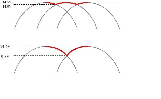

All "AC generators" put out three-phase output which is very stable and efficient. In my drawing below, the red line represents the output voltage. Ripple voltage is the difference between the high and low points, in this case, 0.5 volts. When one diode fails, you lose one phase, then the output looks like the lower drawing. There I made it 5.2 volts. There are a few testers that make a paper printout. Those actually provide a voltage for ripple voltage. Most testers just show it as "low" or "high" with a series of flashing LED lights.
The second test that shows a failed diode is the full-load output current test. This is the only time output current will reach the full potential of the generator. With one bad diode, the most the generator can develop is exactly one third of its rated output. The standard generator for your truck is a 75-amp unit. During the full-load output current test, with one bad diode, the most that will be developed is close to 25 amps. You might get by with that on a '91 model, but on newer models with all the computers, the battery will have to make up the difference as it slowly runs down over days or weeks.
It's best to have these tests done with the generator on the engine as it can take a good five horsepower to run it wide open for the few seconds the test takes. Bench testers at auto parts stores have one horsepower or smaller motors so they can't drive the generator very hard. Also, during the full-load test, a standard part of the test requires engine speed to be raised to 2,000 rpm. Can't get anywhere near that with a bench tester. Generating a current mechanically requires a magnet, a coil of wire, and most importantly, movement between them. That's why we spin them with a belt and pulley. The motors in bench testers do get close to 2,000 rpm, but the motor's pulley is the same size as the pulley on your generator. On the engine, the drive pulley on the vibration damper is a few times larger than the generator's pulley, so it spins it a lot faster than the bench tester does.

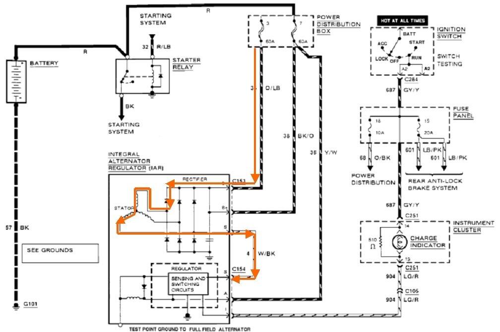

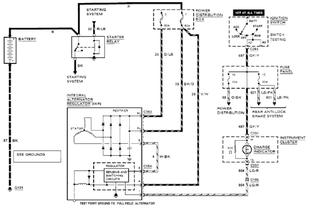

There is one more thing you can check. The first diagram below is for your charging system. In the second one, I added the orange lines to show how a shorted diode could put 12 volts on the white / black wire in the three-wire plug. Check that one for 12 volts. If it's there, one of the positive diodes has to be shorted.
Under normal operation, around 2.0 volts has to show up on the green / red wire to turn the regulator on, then normally around 6.0 volts shows up on the white / black wire to tell the regulator to stay on. It turns off when the ignition switch is turned off because there's 0.0 volts on the green / red turn-on wire, and motion stops, so there's no output on the white / black wire.
With the shorted diode, voltage remains on the white / black wire so the regulator thinks output is still being developed. It stays on and keeps working. My question now is what happens if you disconnect the battery or the three-wire connector? Leave the ignition switch off so that turn-on circuit doesn't kick in. Now reconnect that plug. If this story is correct, 12 volts will appear again on the white / black wire, but will that turn the regulator on by itself? You may find the drain doesn't come back until you turn on the ignition switch, but then it will remain even after the ignition switch is turned back off. Just curious to see what happens.
