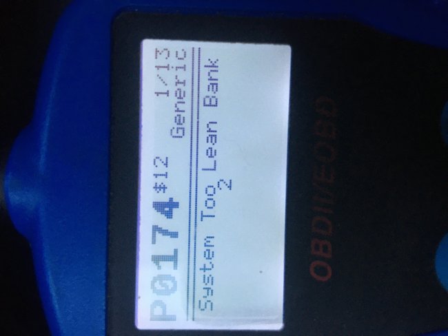

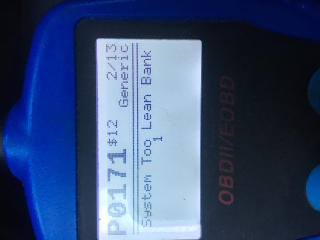

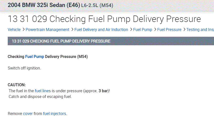

Hello, I just bought the car listed above and have had a few problems with it. It’s throwing p0174 and p0171. I just changed sparkplugs and now it’s throwing codes for cylinders 3, 5, and 6 misfire p0303, p0306, p0305 and p0300. While checking for anything that would obviously cause this, I found that after about 45-50 minutes of the engine running all lights on the dash came on except the battery light and after I cut the car off and tried to cut it back on there was no power. I charged the battery, and it did the same thing. It will run and drive fined up to 3,000 RPMs when it starts sputtering until you cut the car off and cut it back on and it returns to normal.
Feb 15, 2022 at 7:54 AM
  • 110,240 POSTS

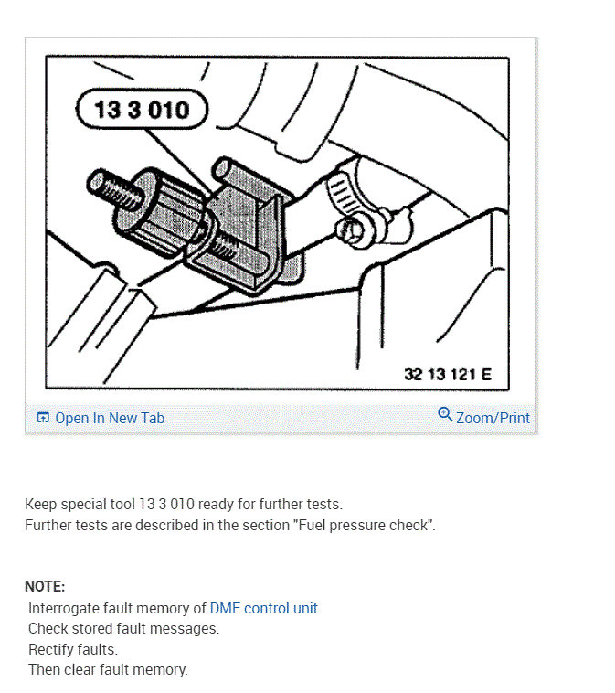

The codes P0171, and P0174 are related to the air/fuel mixture. Either we have too much fuel or not enough. When this happens, have you ever noticed black smoke from the exhaust? If so, it's likely getting too much fuel. If not, then a lean mixture is the likely cause.
Can your scan tool read live data? If it can, check the short-term fuel trims and let me know what they are. That will help me determine which it is, lean or rich.

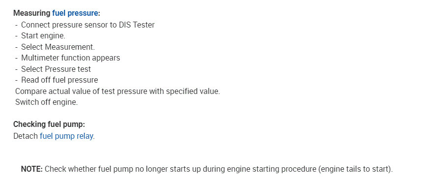

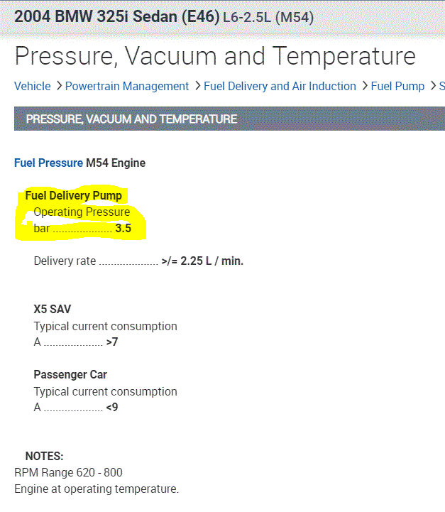

Also, if there is no black smoke, you may want to consider checking the fuel pressure to confirm the pump is producing proper fuel pressure. If it's too low, it will cause a lean mixture.

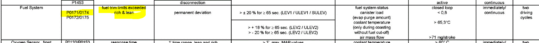

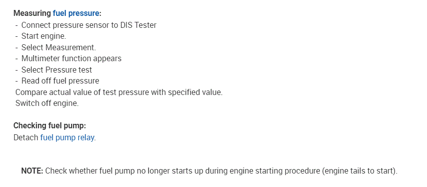

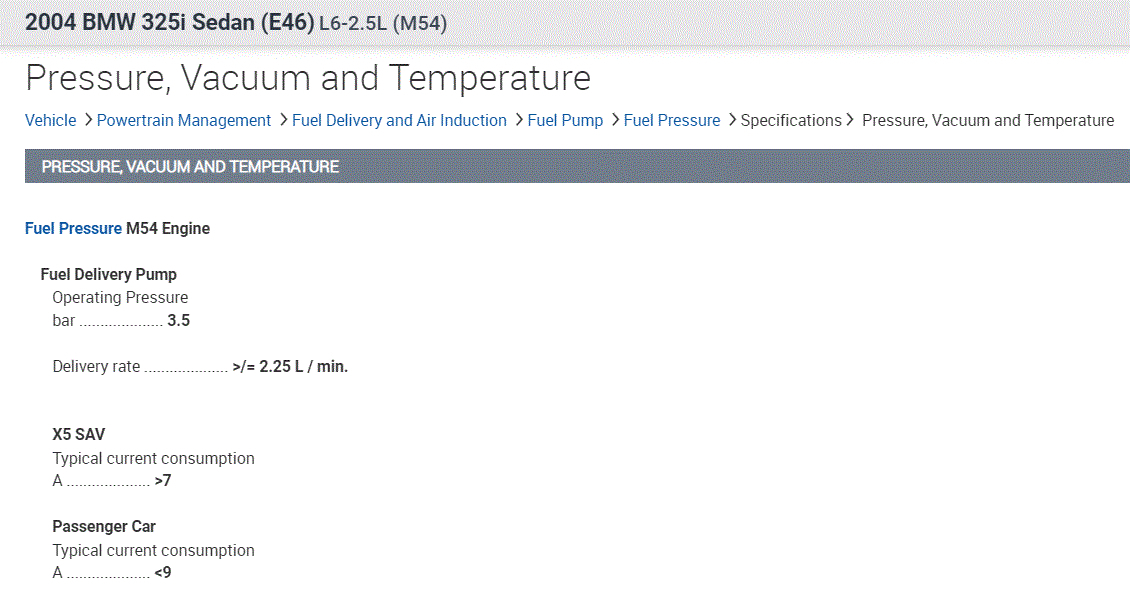

Pic 1 below provides the manufacturer's fuel pressure specifications. Pic 2 shows the description of the codes.
Let me know. Also, let me know the fuel trims if you can get them.

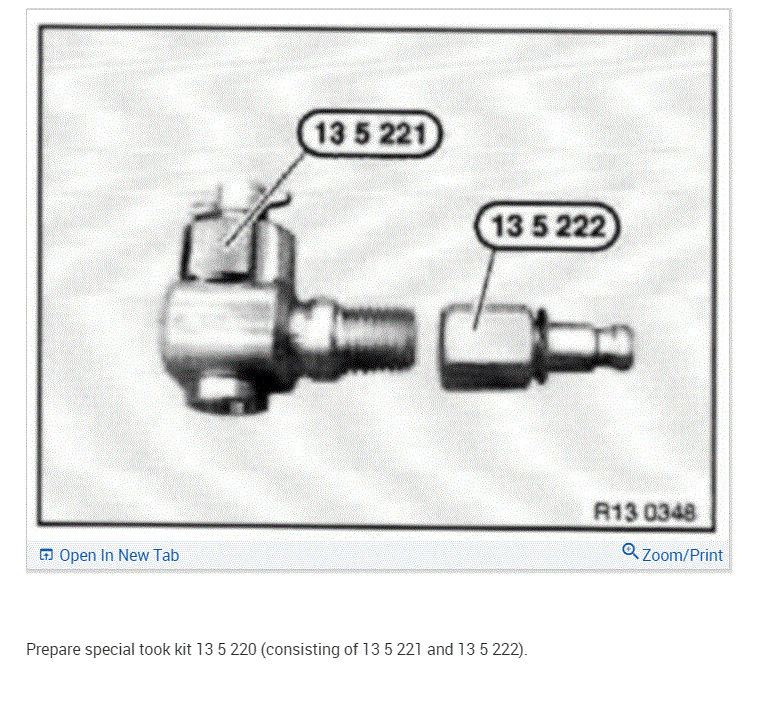

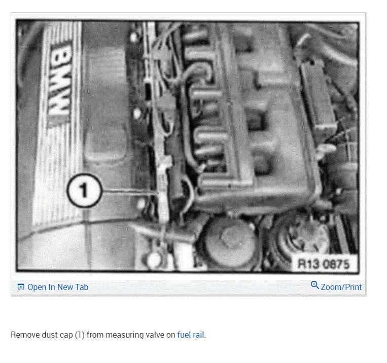

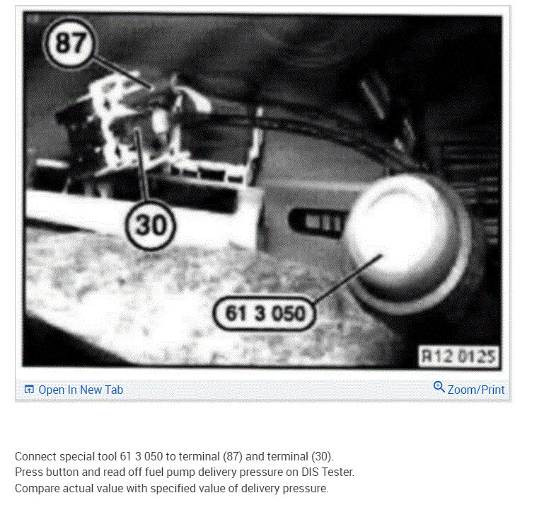

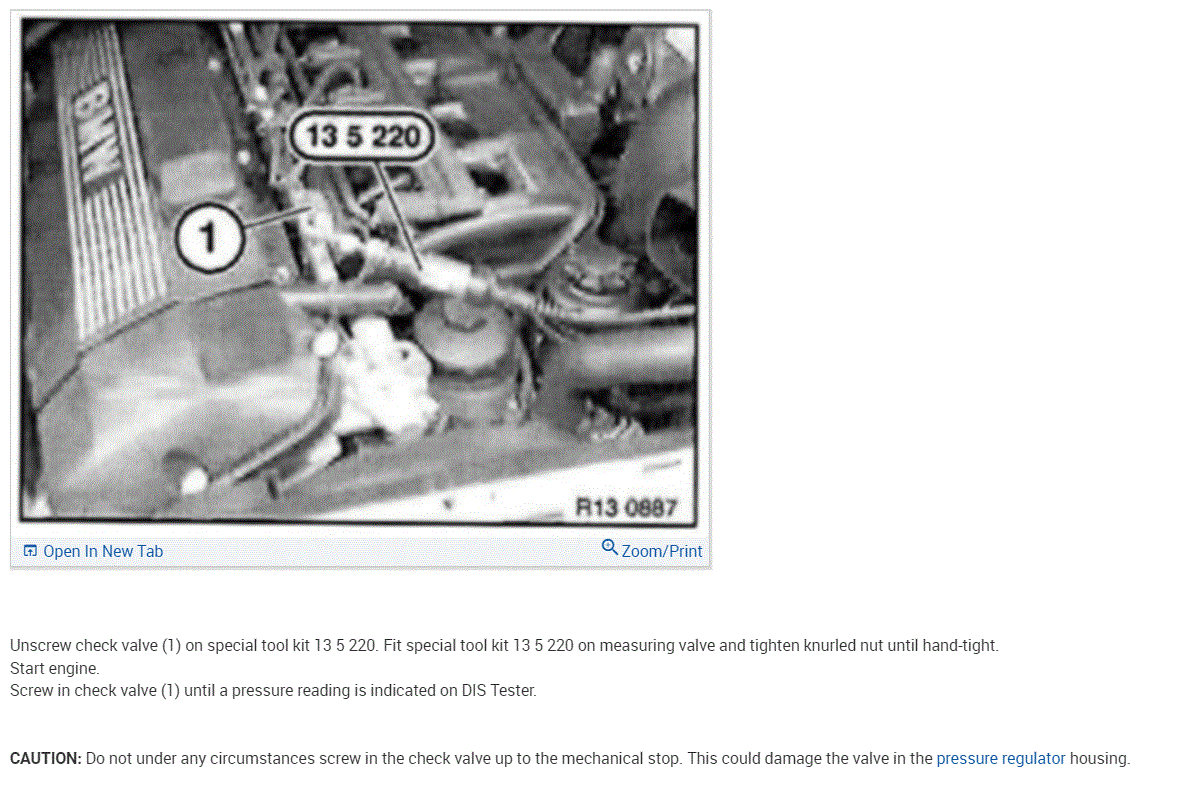

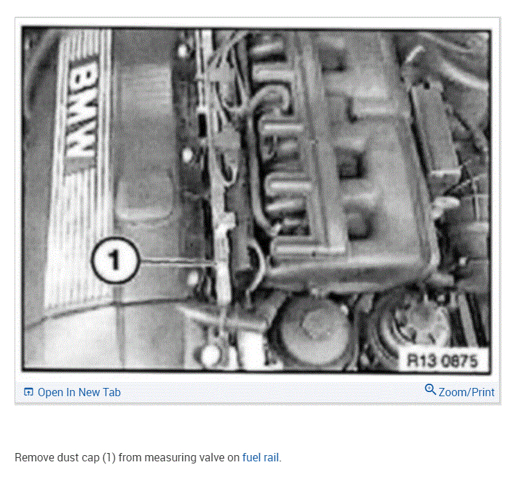

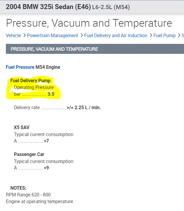

That is very possible. My concern is that the battery shouldn't fail after cranking a couple of times. If it passed a load test, I'm wondering if there is something else going on. Are you able to perform a fuel pressure test to see if it is within the manufacturer's fuel pressure specifications?
Here is a link showing in general how it's done:
If you look at the pics below, they provide directions specific to your vehicle. The last pic has specs.
Feb 17, 2022 at 11:20 AM

The fuel pressure stays at 3.4 bar under load and at idle.
Feb 18, 2022 at 8:25 AM
  • 110,240 POSTS
That is nearly perfect. There must be a vacuum leak allowing unmetered air to get into the engine. Are there any exhaust leaks? Also, can you get your hands on a live data scan tool? If we know the fuel trims, it will help. Also, we can confirm the oxygen sensors (which the PCM uses to determine the air/fuel mixture needed) are working properly.
If there were other codes, I would be pointing you in a different direction. However, the fuel pressure is great and it's still lean. Somewhere, somehow, it's getting too much air and not enough fuel.
