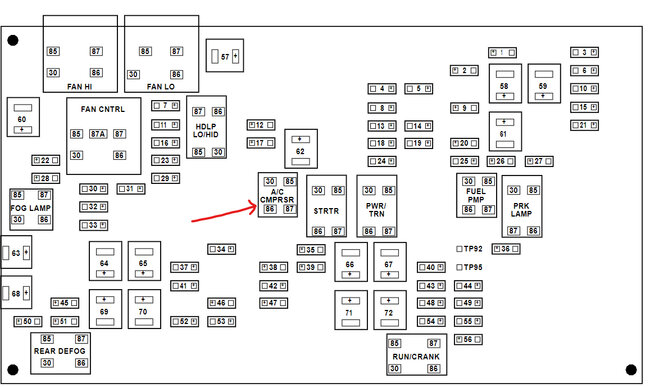

My car battery drains within hours to a day after it is jumped, or AutoZone fully charges my battery. I replaced battery 3 weeks new, alternator and starter 1 week new and alternator 175amp fuse 2 days new. Battery still drains after a few hours to a day later. What could it possibly be?

Yep, I have seen the A/C compressor relay stuck closed and drain the battery on these trucks. Here is the location so you can remove it to see if the drain goes way, also here is a guide you can go over to help you see what other items can cause the battery drain:
https://www.2carpros.com/articles/car-battery-dead-overnight
The A/C relay is under the hood in the main fuse panel. Check out the images (below). Please let us know what happens.

So i charged my battery today to 75%. I just removed the ac compressor relay. I'll post an update tomorrow to see if the battery still drains. But it does explain why every time i disconnect and reconnect the battery, my ac is running even though i never turned it on before disconnecting the battery or jumping the car.

So, i waited two days to see if my battery would die and lo and behold i am once again charging my battery. The A/C compressor relay was blown but the battery is still draining.
