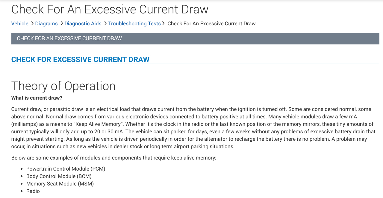

Recently battery would drain after car sat for two days. Battery and charging system test okay. Problem just recently began.
Jan 24, 2020 at 9:14 AM
SCGRANTURISMO
  • 4,897 POSTS

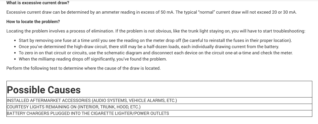

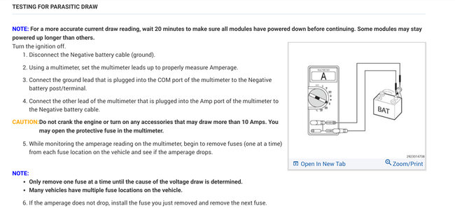

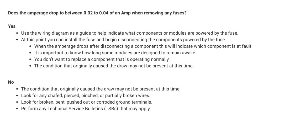

This sounds like a common problem called parasitic draw. Here is a link to a generic explaining about parasitic draw below:
https://www.2carpros.com/articles/car-battery-dead-overnight
Here is a detailed guide explaining how to track down parasitic draw in any automobile in the diagrams down below. Please go through these guides and get back to us with what you find out.
