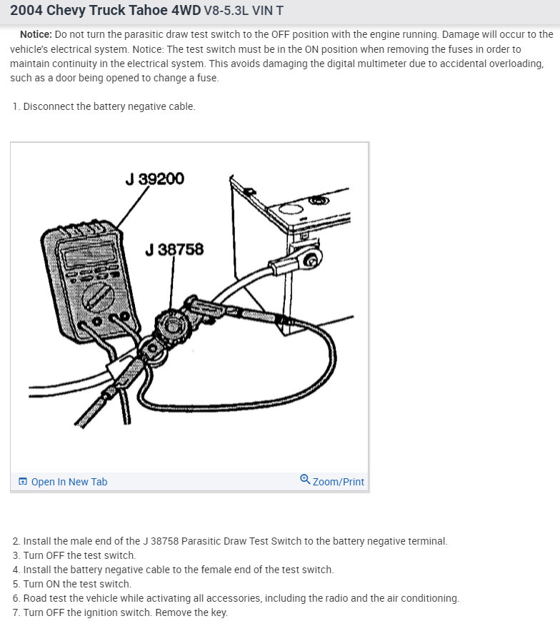

One day after sitting all night it will start fine and then the next day it may be drained. Got it started drove it for about an hour parked it let it sit for about 45 minutes tried to start it completely drained.
Nov 19, 2021 at 6:26 AM
SQM
  • 6,383 POSTS

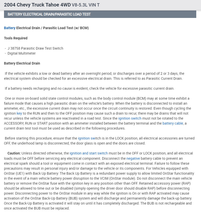

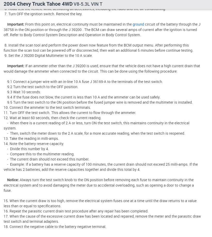

Sounds like the vehicle have excessive parasitic draw (current drain).
Typically, this points to a faulty electrical circuit or something staying on like a glove box or cargo area light etc.
To find out where is the excess draw is coming from you will need a multimeter and check the battery drain.
Take a look at his video, it shows how to find the parasitic draw:
https://youtu.be/z5F7WpgjaRs
https://www.2carpros.com/articles/car-battery-dead-overnight
