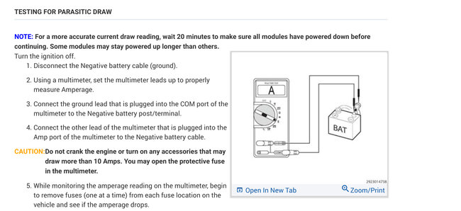

FARMERPARSON
The battery and alternator has been replaced. Their is a parasitic drain that I have found at the PCM (battery fuse under hood). With a well charged battery I can start the car and place voltmeter on alternator and watch the voltage drop drastically. I have had the new alternator (not refurbished) checked and it checks out fine. Any suggestions?

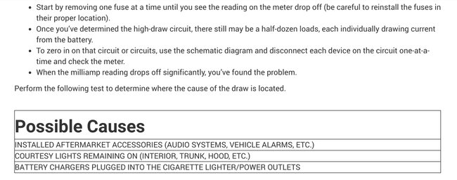

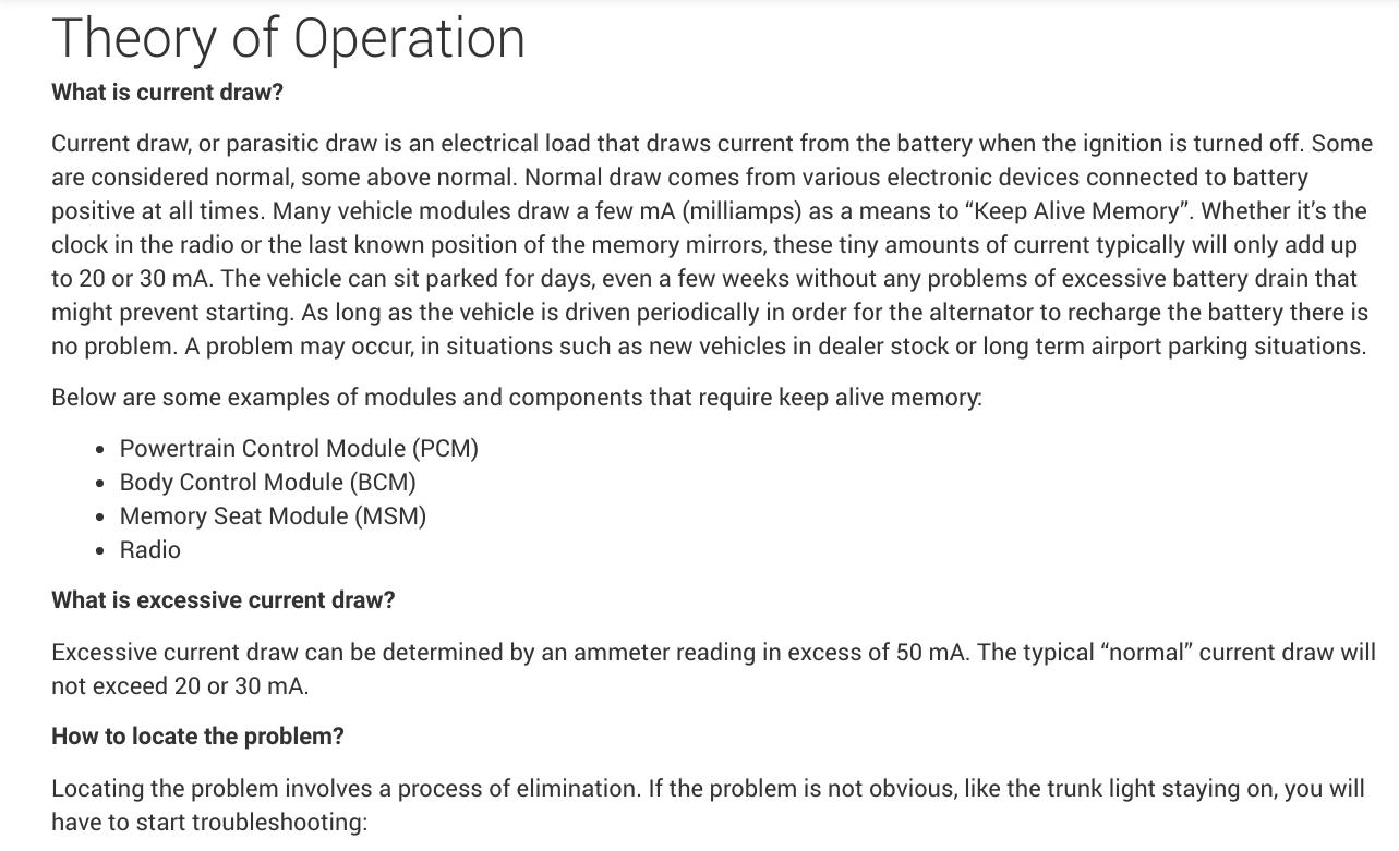

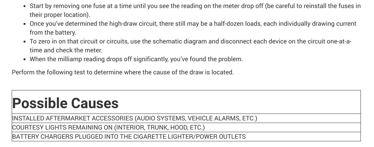

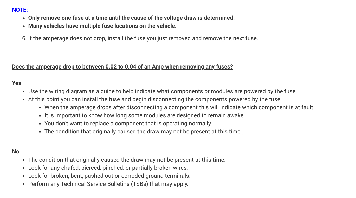

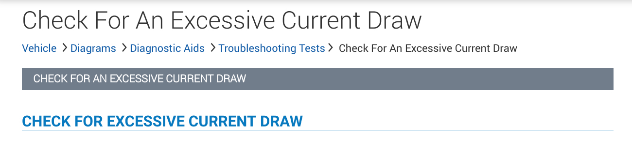

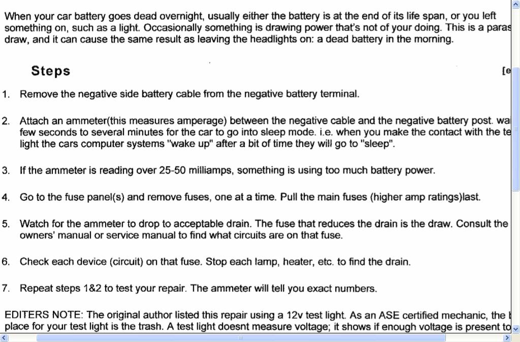

Here is a diagnostic troubleshooting guide on how to find a parasitic draw in an automotive circuit so that you can fix it, in the diagrams down below. You will need to use a Digital Multi-meter [DMM] to use this guide. here is a guide explaining how to use one below, if needed:
This guide should help
https://www.2carpros.com/articles/car-battery-dead-overnight
Please go through these guides and get back to us with what you discover.
