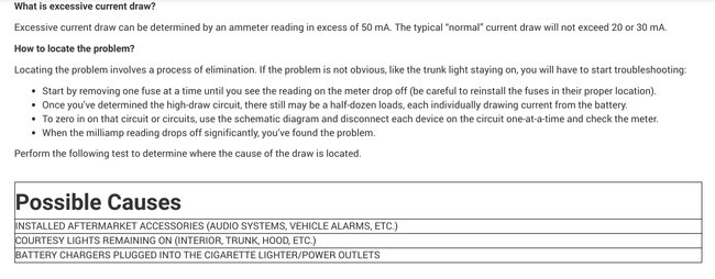

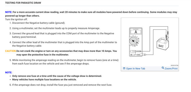

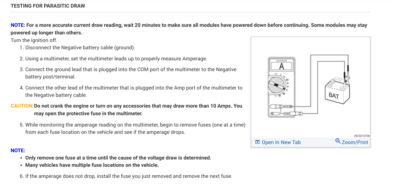

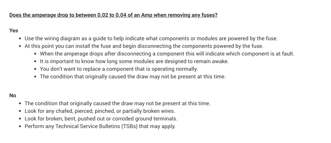

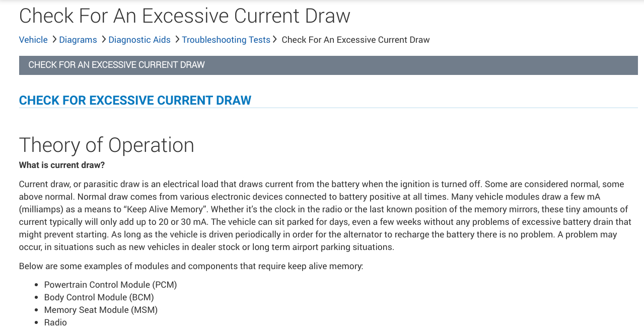

This is definitely a case of parasitic draw. This is when something is left on or there is a short to power somewhere in one of your vehicle's circuits. Here is a link to a general guide below:
https://www.2carpros.com/articles/car-battery-dead-overnight
If you can't find the problem using this guide I have included a more specific guide in the diagrams down below. Please go through these guides and get back to us with what you find out.
