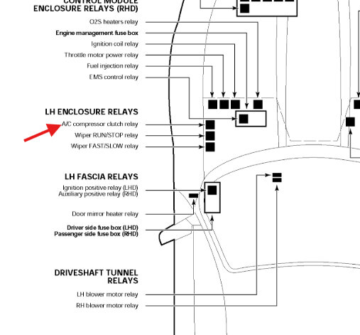

Hmm, I have seen the AC compressor control relay stick on and drain the battery in these cars. But, I would check the glove box light and the trunk light. The cluster does use fuse #18 in the driver side fuse panel which is hot all the time so if you remove this fuse the raw should stop if the cluster is the issue. Here is a great guide on how to find the draw and the most popular items to cause the draw.
https://www.2carpros.com/articles/car-battery-dead-overnight
Here is the location of the AC compressor clutch relay so you can remove it to see if the draw stops as well. Check out the images (below). Let us know how it goes

Pulled the Ac relay. Verified the glove box and trunk are not the issue. Before the Ac relay was pulled the battery voltage was 12.79. I checked the voltage 23 hrs later (with the ac relay removed), the volts dropped to 12.31. What do you think?

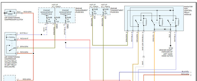

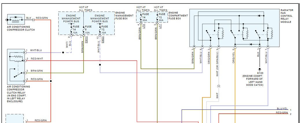

Hi Ken, Can you supply me with the electrical schematic for the circuit that the AC compressor clutch relay is in please. Thanks
Jan 5, 2026 at 8:42 AM
  • 55,433 POSTS
Sure here you go, did the engine start after you pulled the AC compressor relay? Check out the images (below). Let us know how it goes
