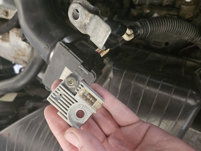

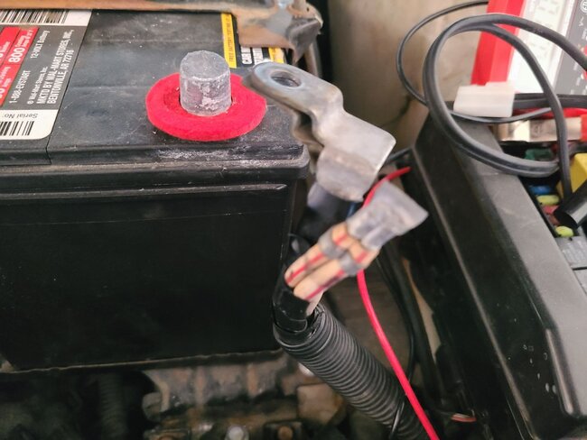

I wasn't able to find the drain but this wire snapped and I don't know how to replace it. I was trying to replace the terminals.

The wire connector is what broke. Looking at the picture, it appears the wire harness will need replaced for that connection unless there is enough room left on the wire side to drill a hole and mount it.

There isn't enough room.
Aug 28, 2024 at 4:38 AM
PAULSENJAKE
  • 30 POSTS
Is there a way to replace the connector?
Aug 28, 2024 at 4:46 AM
  • 110,241 POSTS
What I suggest is to visit a local parts store such as AutoZone. They have a section of battery connectors and repair parts. If you can find one that is similar to the one that has broken, you could cut the wires and crimp them onto a new connector. Just make sure all wires are tightly connected in the new connector, and all are making contact.
All you will need is a repair connector that can fit all the wires and the bolt stud you need to attach it to.
Let me know if that helps or if you have other questions.
