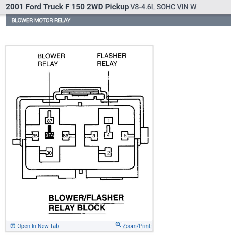

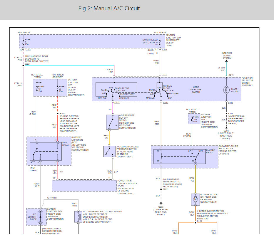

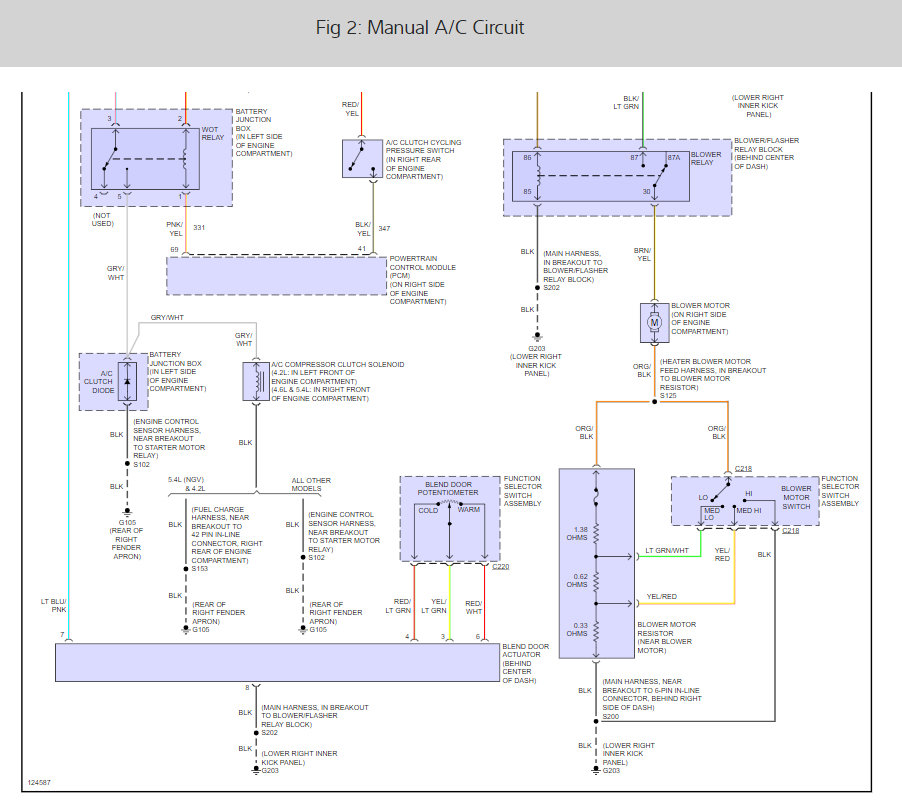

It sounds like the blower motor control relay is stuck on causing the blower motor to keep running. but to be sure here is a guide to help test it and the location of the relay with the blower motor wiring diagrams so you can see how the system works:
