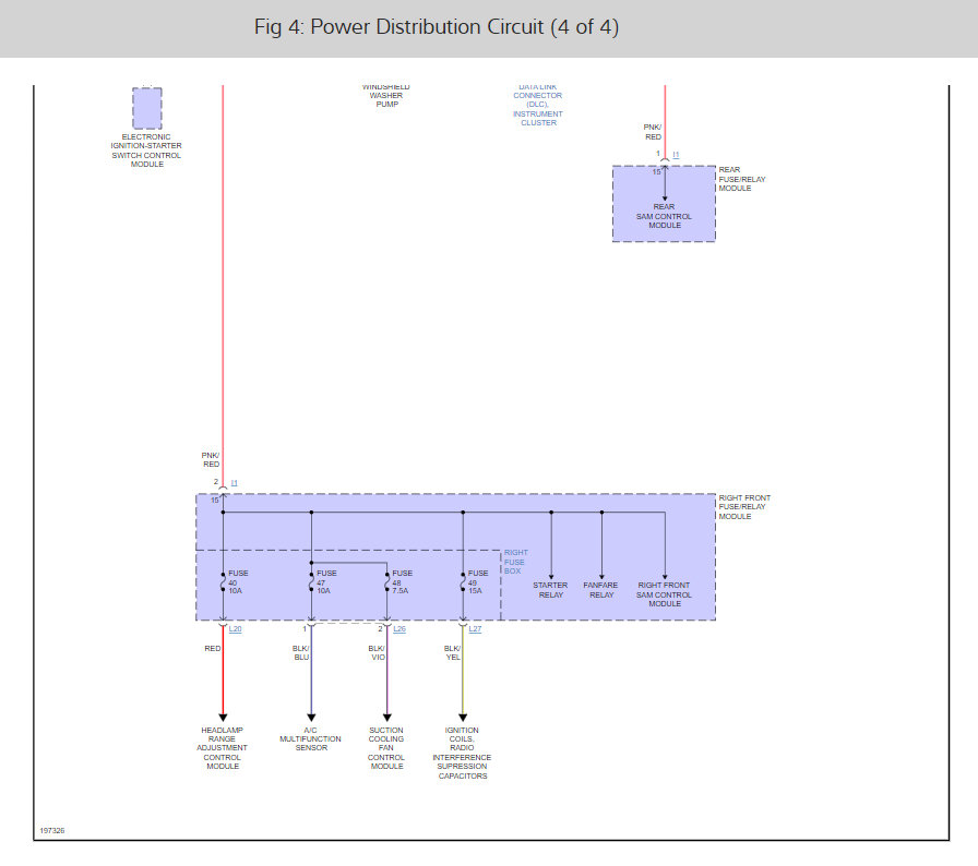

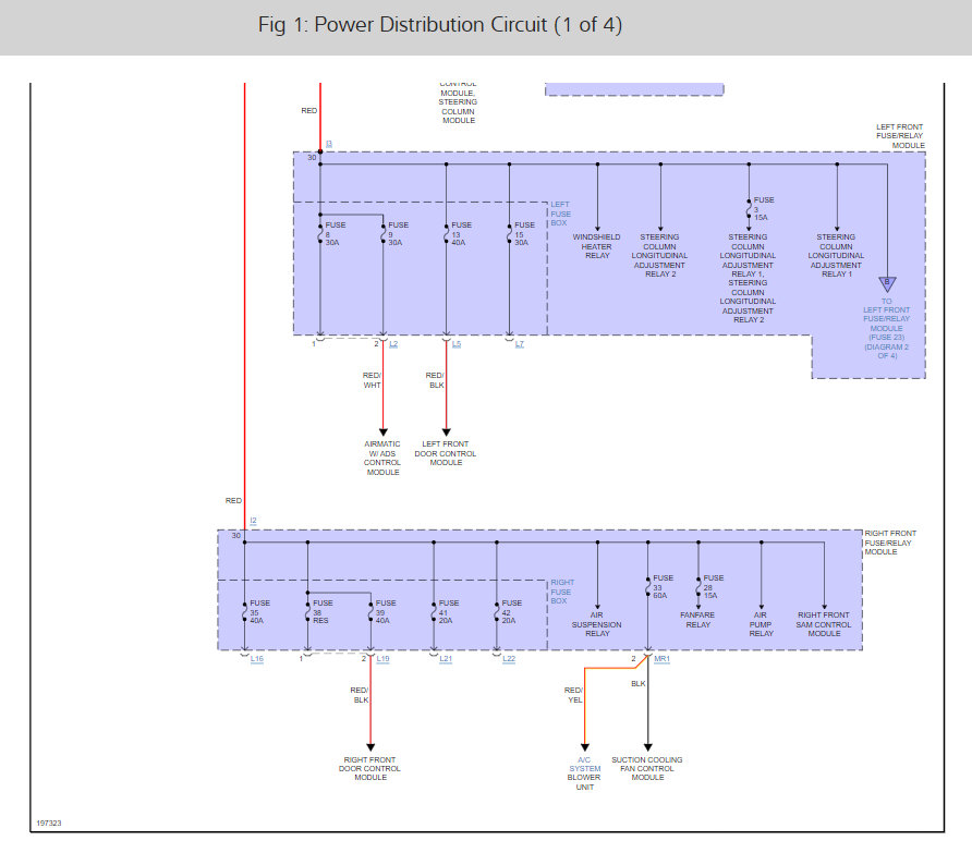

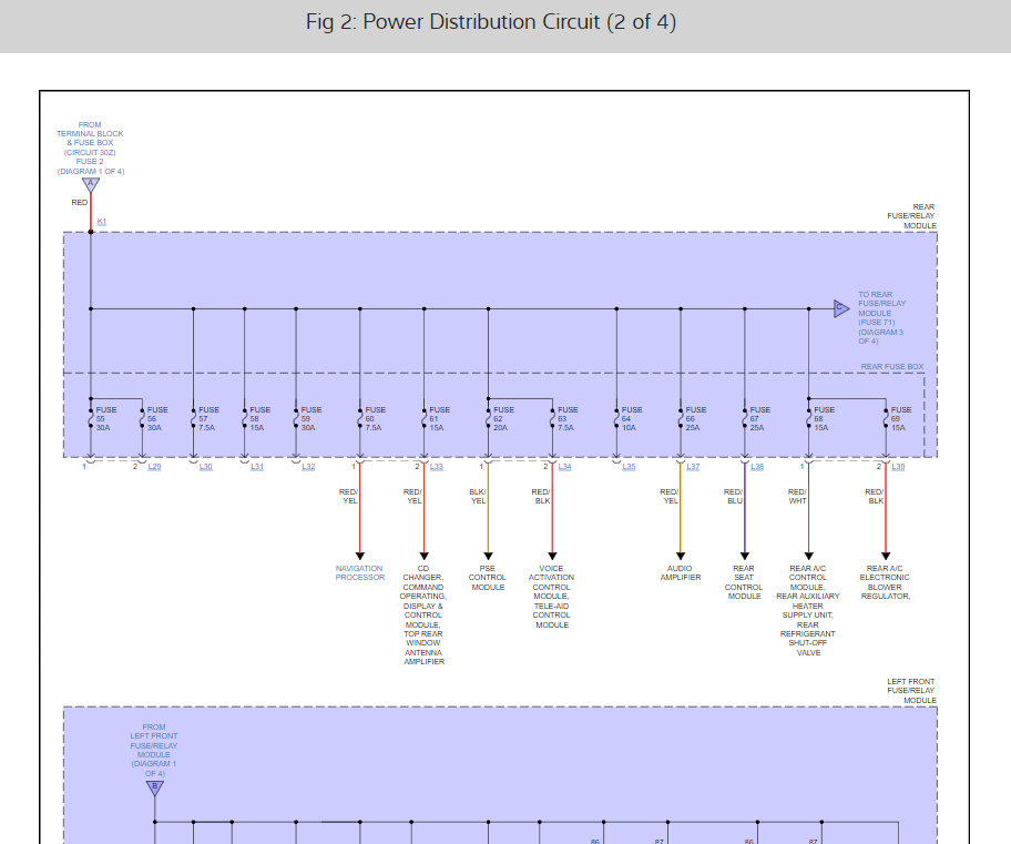

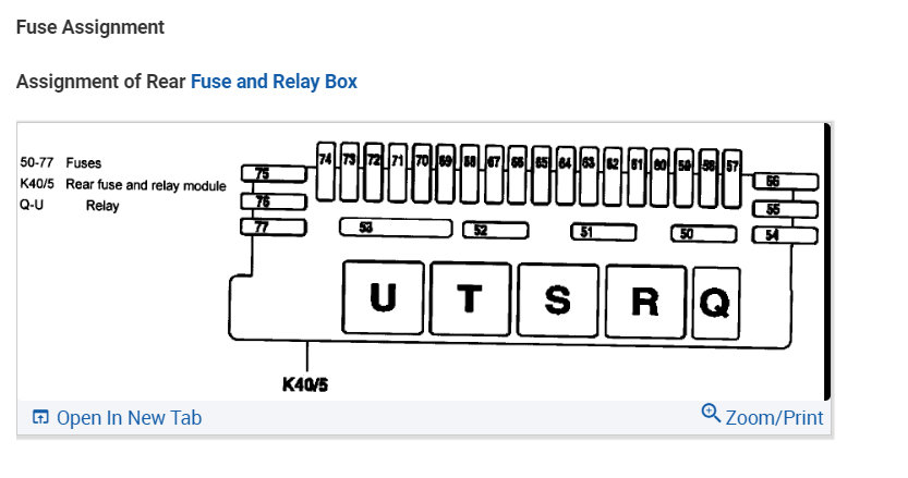

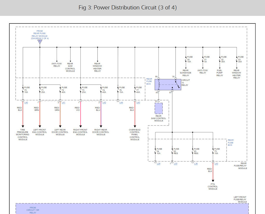

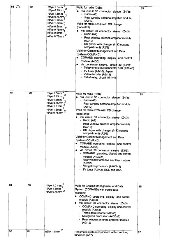

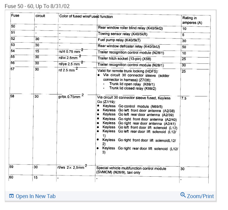

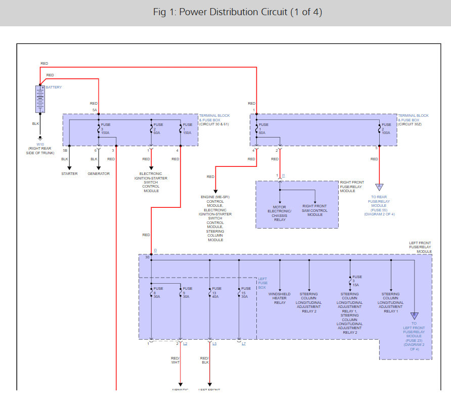

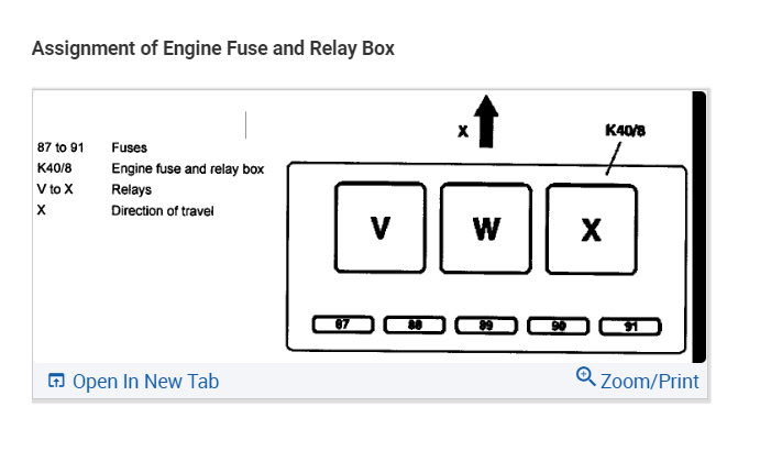

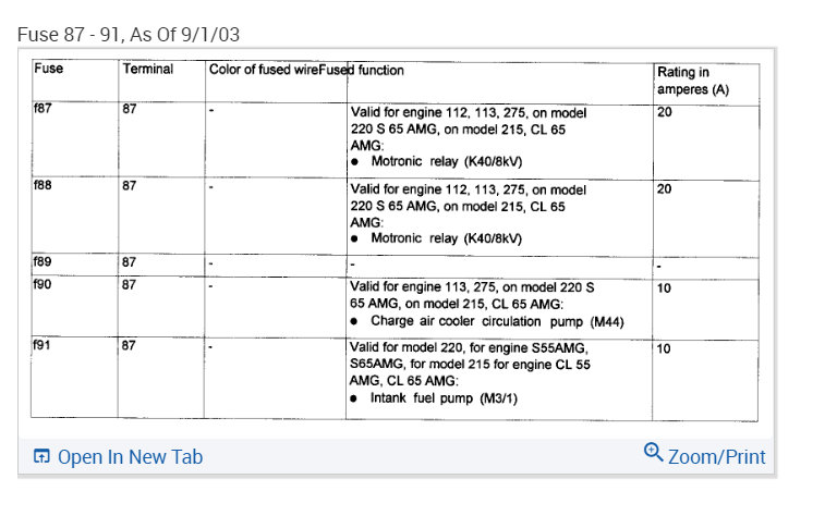

Ignition won't turn, I believe the profuse is blown. The car previously cranked before jumping battery and fuse junction box under the passenger side floorboard. Where is that fuse located?
Jul 10, 2022 at 12:03 PM
  • 55,732 POSTS

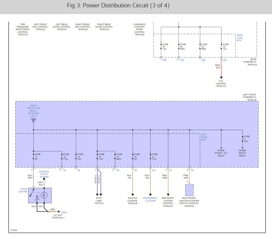

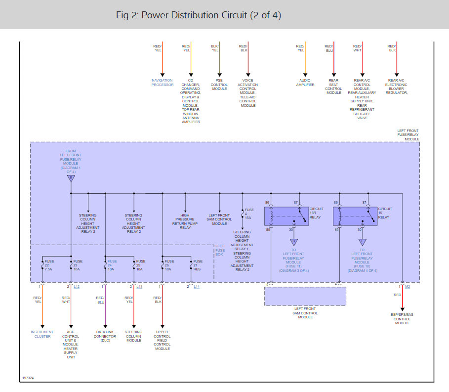

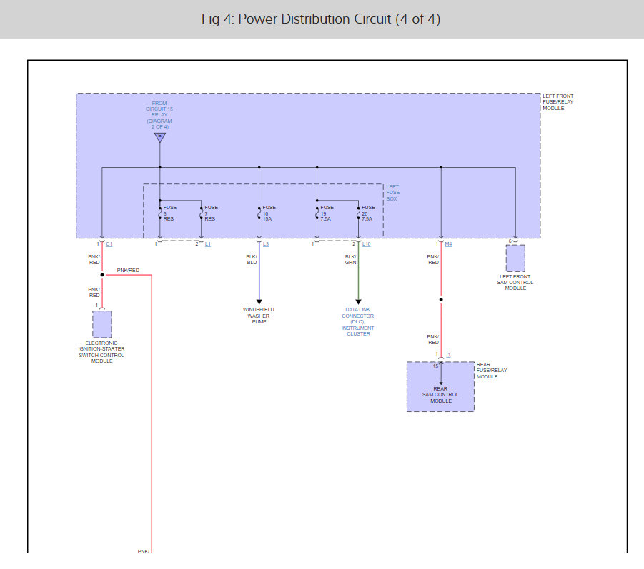

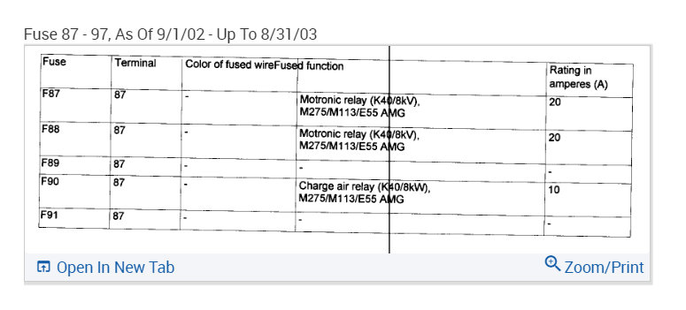

I am not sure what fuse you are referring to, but I think you need the main fuse in the panels in by the battery. Also, I have found the power distribution wiring so you can see how the car is powered in the diagrams below. Also included is a guide to help you check for power and the fuse.
