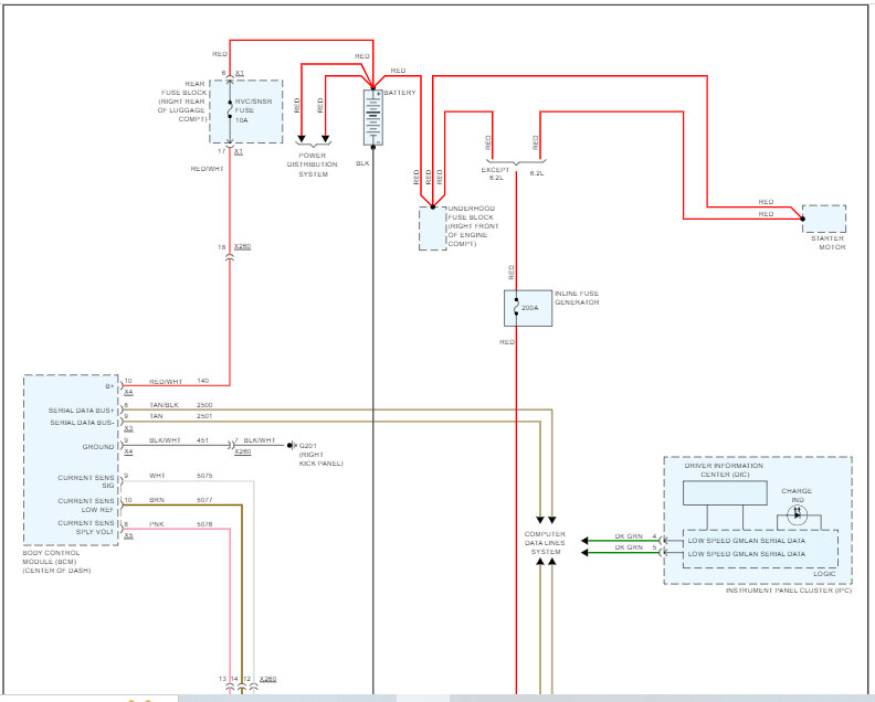

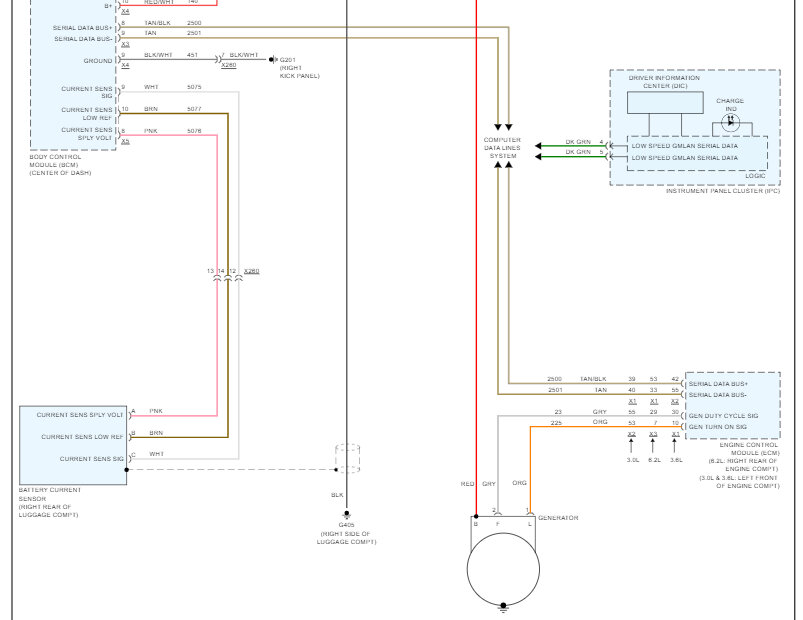

There is a battery circuit sensor that can be causing issues as well. If you can, let me know all the diagnostic trouble codes that are stored.

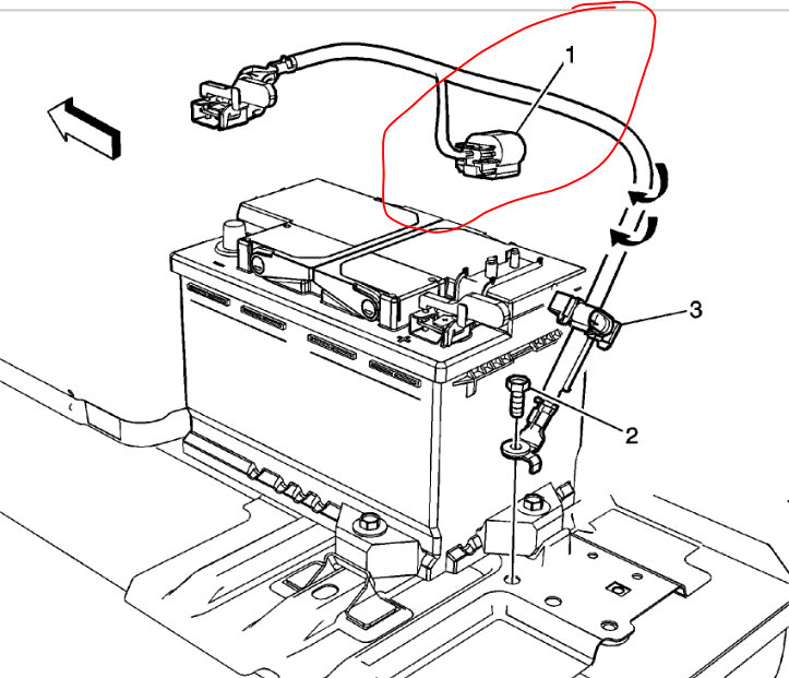

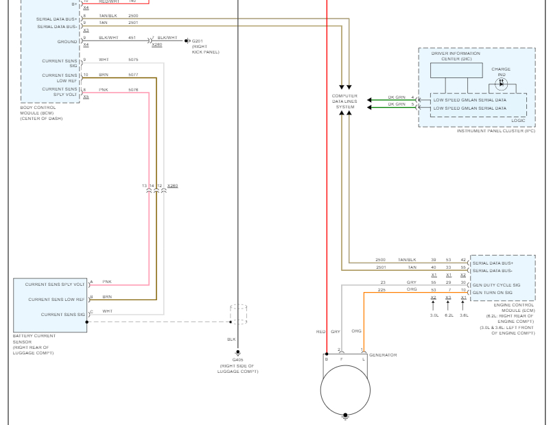

Pics 1 and 2 below are the wiring schematics for the charging system. I added them so you have a reference. Pic 3 below shows the battery circuit sensor location.
Let me know if the voltages you found are as I mentioned. Also, I can look through the diagnostic trouble codes to see if something stands out for voltage issues. If I had to guess, I would say most codes are related to a voltage issue.

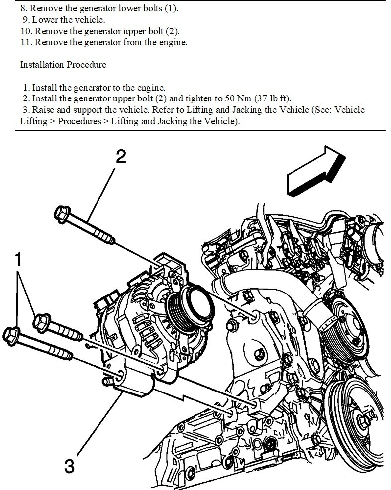

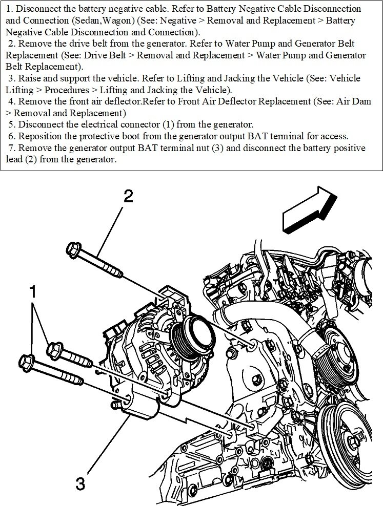

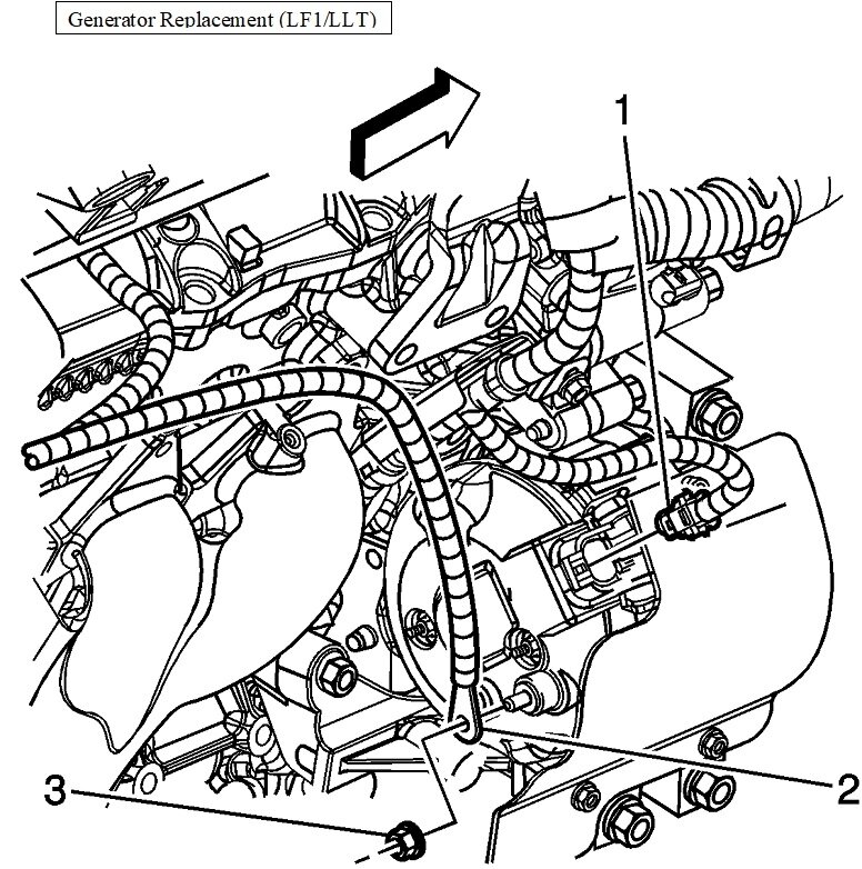

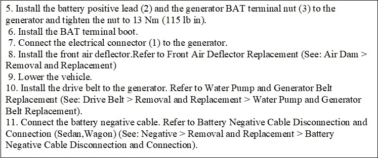

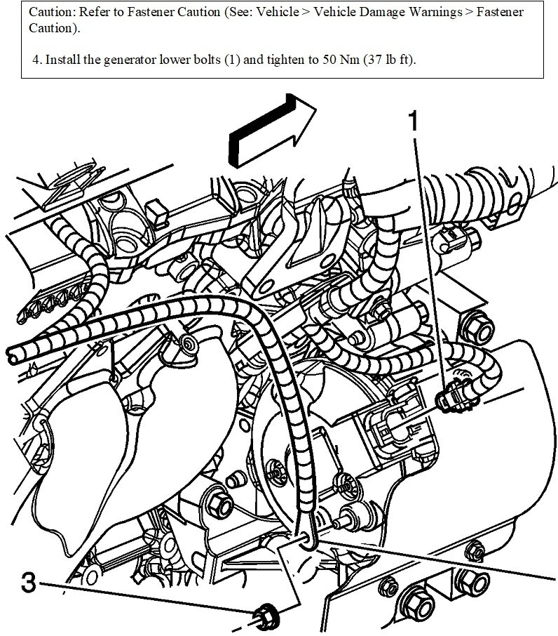

If testing shows the generator must be replaced, I copied the instructions for you from our online service manual. The steps are in these five drawings. Please let me know what you find.
