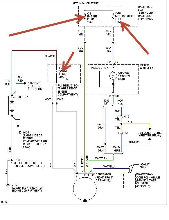

Ok My car is having issues charging my battrery. The belts are all tight the altenator test as good i guess so then i thought it might be those brushes inside the altenator however when i get into my car and start it its starts fine it sometimes charges to now when i begin down the road i can hear clicking or arching coming from my fuze box area( the one located in side the car) I looked up there with a flashlight and nothing looks burned. Also when this clicking sound happens my battery either begins to charge or stops charging. this clicking has somthing to do with it. all the fuzes seem to be in there places firmly. Any ideas will be helpful...Thankyou

check the three fuses I have pointed out in pic and ground on right front lower frame.

forgot pic

These fuses look fine the one under the hood is screwed down but appears to be fine. is there a voltage regulator or voltage relay that i should look at? THANKYOU for you time if you have any ideas please let me know. Also the battery is grounded.

the chart I sent I s the wiring for your turck the only thing I can see is the a/c relay see if that is good. unless this has been messed with I have no idea. although the relay only deals with 95 so that may be the problem as well.
