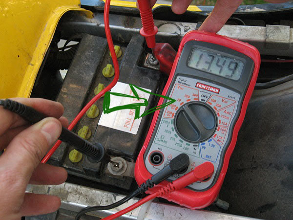

Thanks Mr Mark. How can I test the current that is going into the battery from the alternator?
Apr 23, 2017 at 4:12 AM
OBXAUTOMEDIC
  • 3,713 POSTS
Hi Hassan,
First off you will need a digital Multi-Meter (picture below). You will turn the meter to 20 volts scale (see picture), with vehicle running touch red lead to positive battery post and black lead to Negative post (see picture). And as stated voltage should be between 13.5 - 15.1 maybe as high as 15.5 volts
Battery Voltage with vehicle off should be 12.5 - 12.8 volts.
