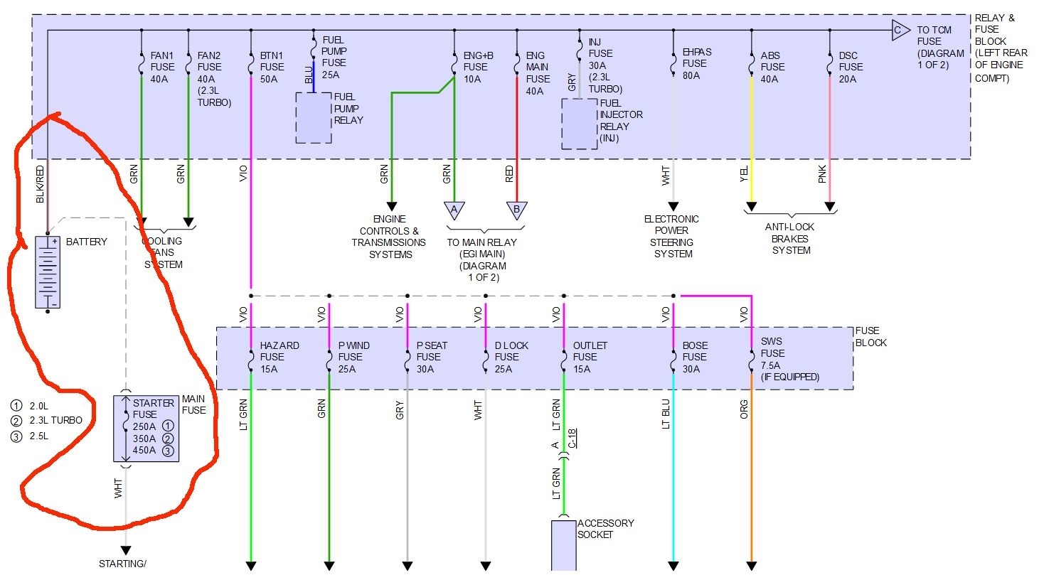

KYRON BENJAMIN

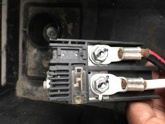

I appreciate the quick and detailed response. I have attached an image of my negative lead, I suspect the fuse on it has blown. Is it still safe to connect my battery? Also, can connecting my battery the wrong way reverse its polarity, or is it more likely that it was labeled incorrectly? Because this was my first time, I was sure to insert the new battery in precisely the same manner the old one was inserted and to add to that, the new battery had colored plastic over the poles indicating their polarity. I am pretty sure I connected it right.

STEVE W.
  • 15,345 POSTS

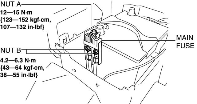

Yep, that is blown. That also is not the negative terminal. That is the main fuse assembly on the positive lead.
Mazda likes to use a black lead with a red stripe for the positive battery connection to the fuse box. The white wire goes to the alternator/generator as part of the charging circuit.

KYRON BENJAMIN
I drive a 2011 Mazda 3 if that makes a difference, but I am about 90% sure I took the photographed lead off the negative pole of my old battery. Is it possible for my car to have been functioning with the battery installed incorrectly this whole time, in the event what I photographed is in fact the positive lead?

STEVE W.
  • 15,345 POSTS

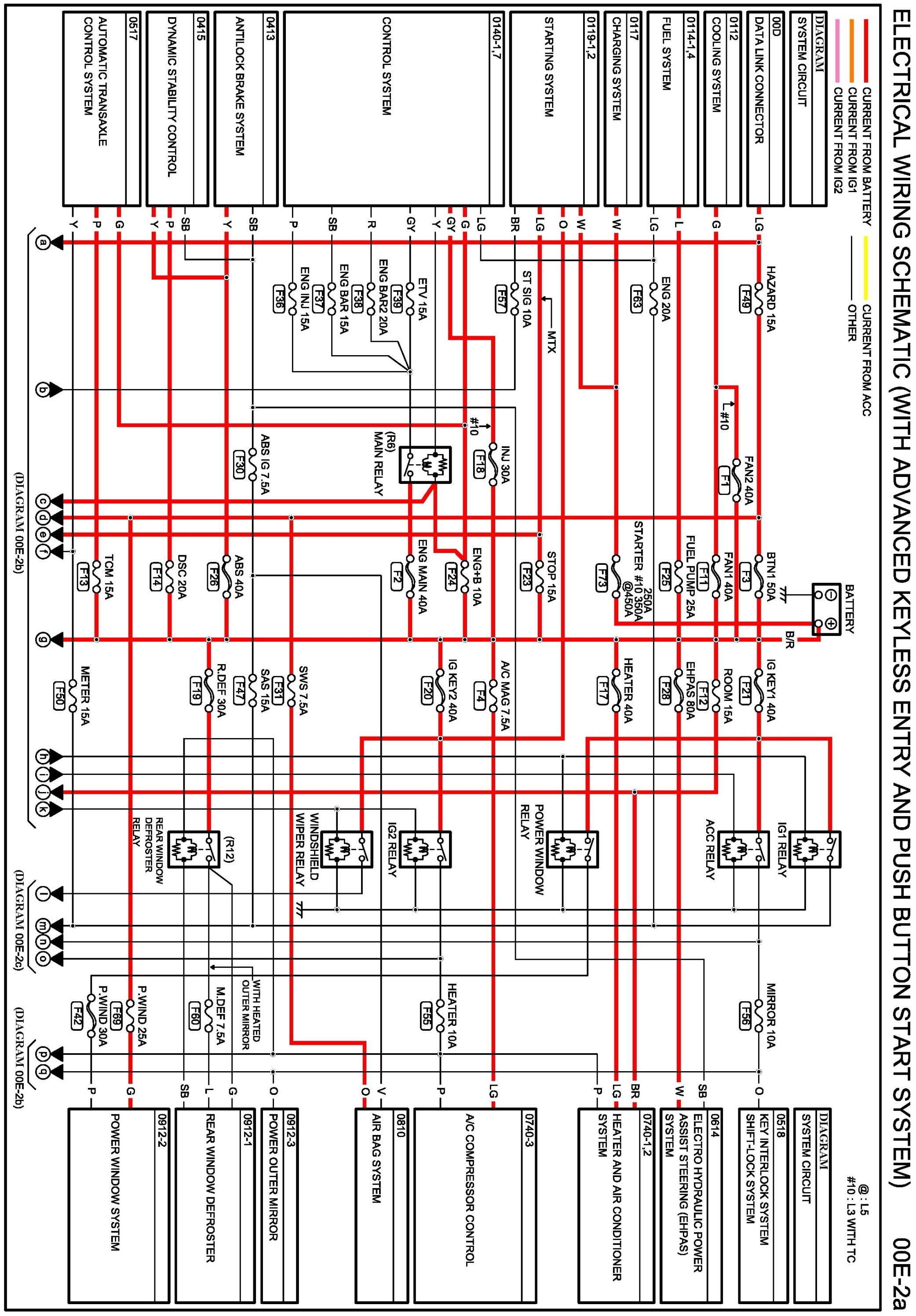

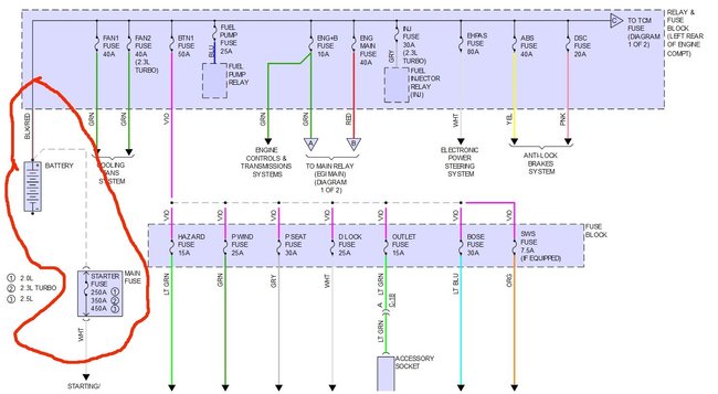

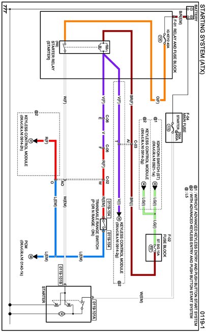

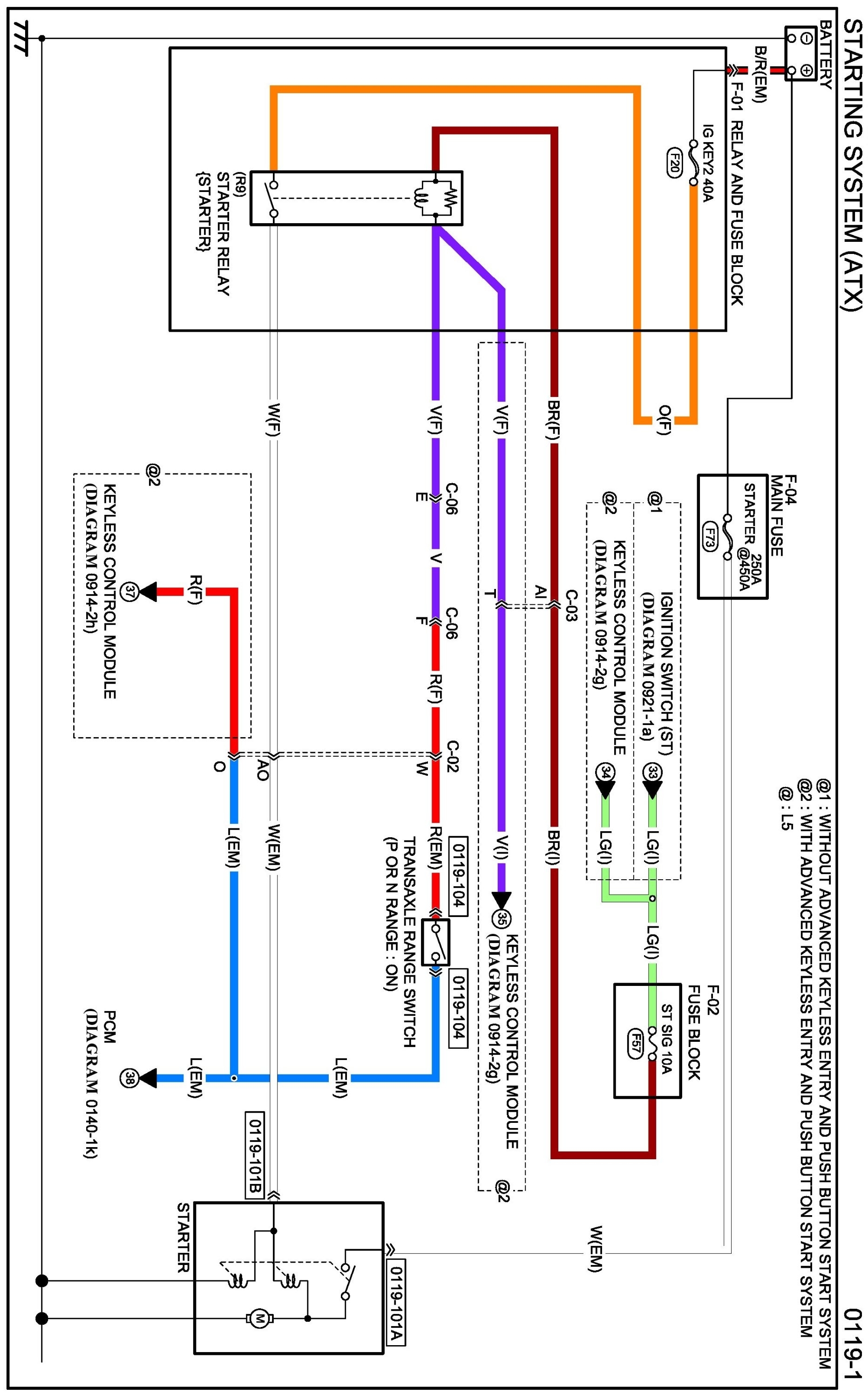

Here are three wiring diagrams, one aftermarket and two factory diagrams. they show the main fuse with the white wire and the black/red stripe on the positive terminal. The other cable will be solid black and go to chassis and engine ground.
Not possible for it to work the other way, sorry.
