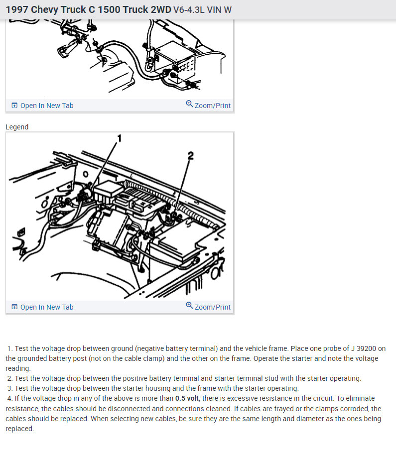

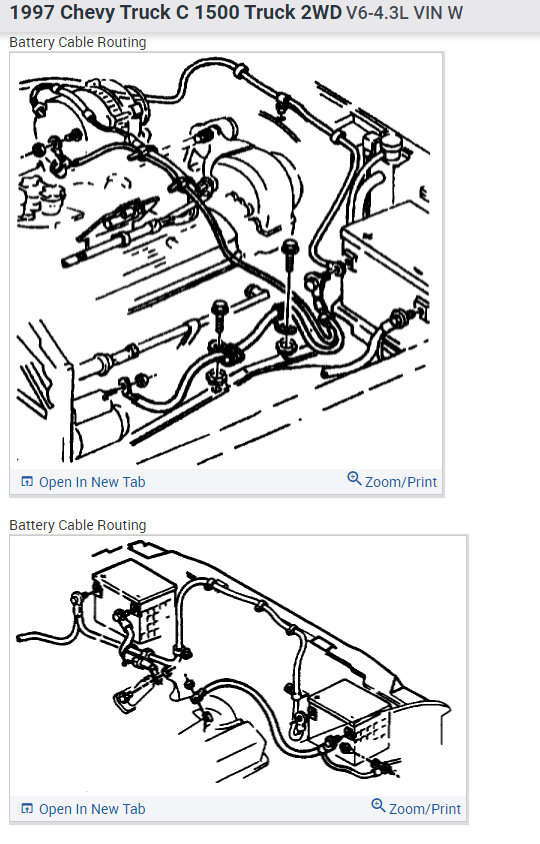

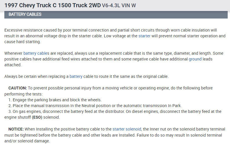

My truck has two red wires for the battery which one do I use?
Oct 7, 2021 at 2:41 AM
SQM
  • 6,383 POSTS
If you would please upload few pictures of the cables that you are mentioning.
So we can have a better idea.
I have attached the cable diagrams for your reference.
