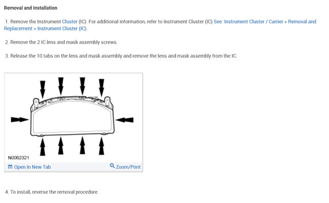

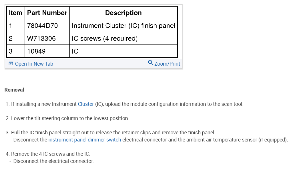

Is there a way to replace the bulbs for the tire pressure and battery warning lights on back of the instrument cluster?
2009 FORD ESCAPE
180,000 MILES • 3.0L • V6 • 2WD • AUTOMATIC
KANADA1234
Do they have separate bulbs or are they all connected? If anyone can find a diagram for the set up for the back of the instrument cluster that would be great.

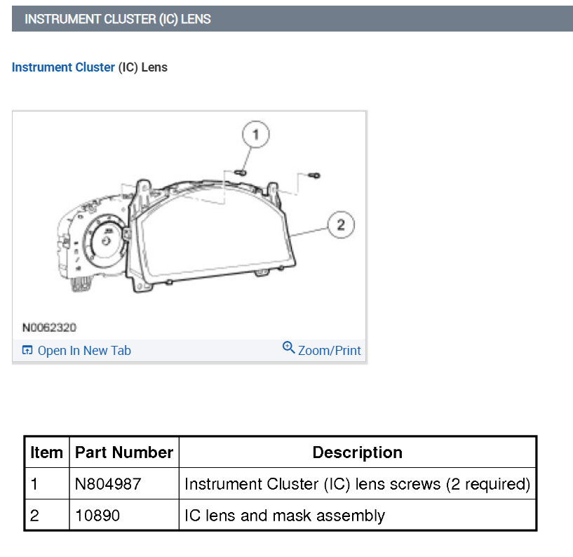

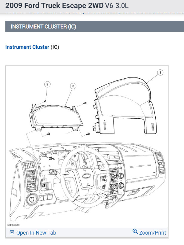

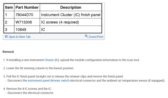

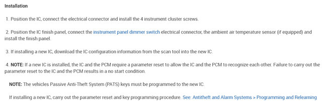

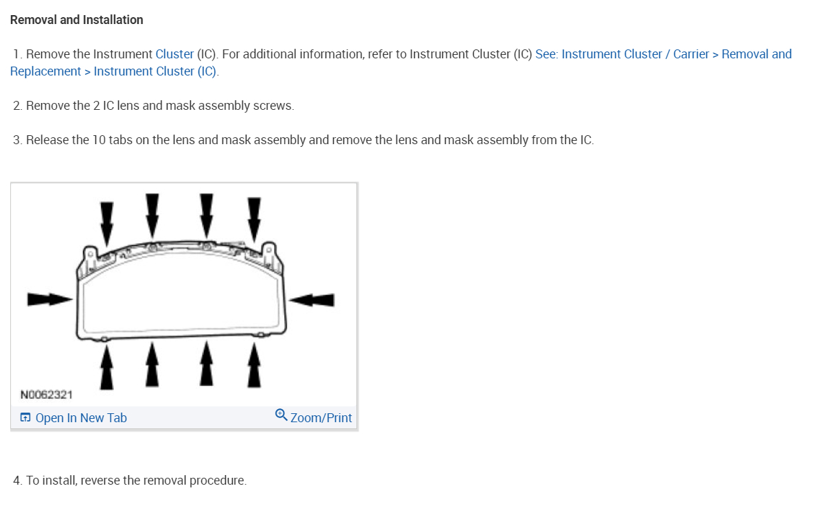

It sounds like the cluster is going out, the bulbs might be hard wired in, I would remove the cluster and see if you can remove the lens to pull the board and look at the bulbs. Here is how to remove the cluster and pull the broad, if this doesn't work, I would get a rebuilt or used cluster by searching google or Ebay. Check out the images (below). Please let us know how it goes.
