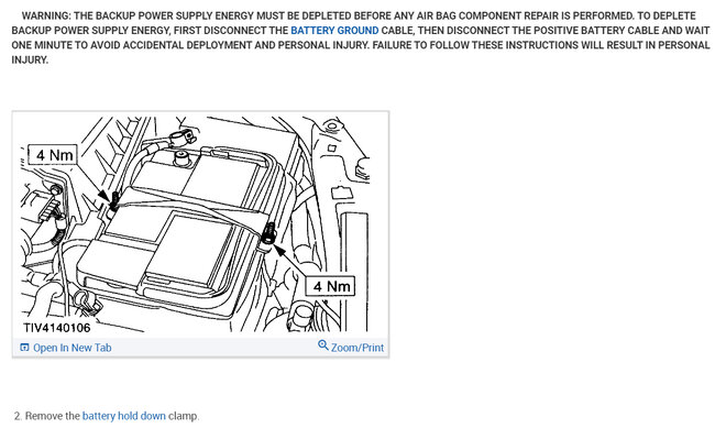

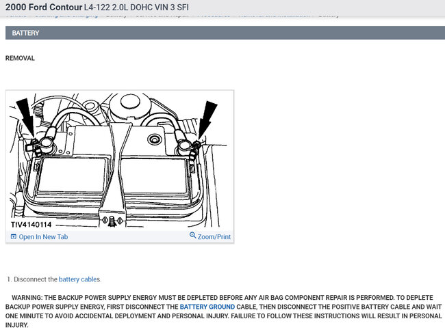

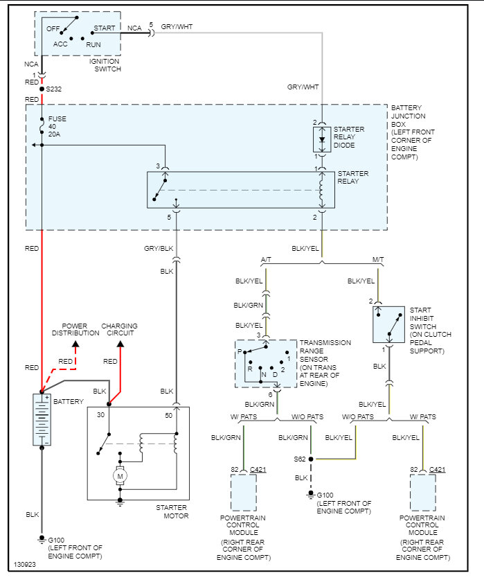

I was changing my battery one day and just lost the part that goes for the wiring on my battery terminals, so I don't know which wires go to the starter and the battery.
Jul 13, 2023 at 1:04 AM
  • 55,694 POSTS
Sure, here is the battery and starter wiring diagrams. Check out the images (below). Please let us know if you need anything else to get the problem fixed.
