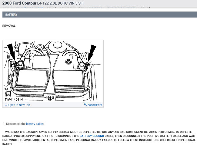

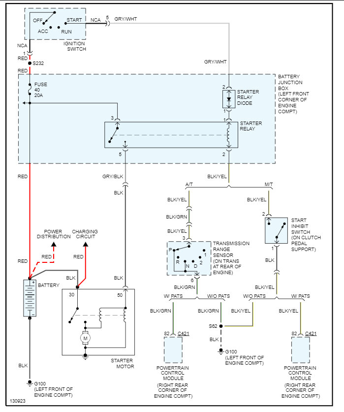

I was changing my battery one day and just lost the part that goes for the wiring on my battery terminals, so I don't know which wires go to the starter and the battery.

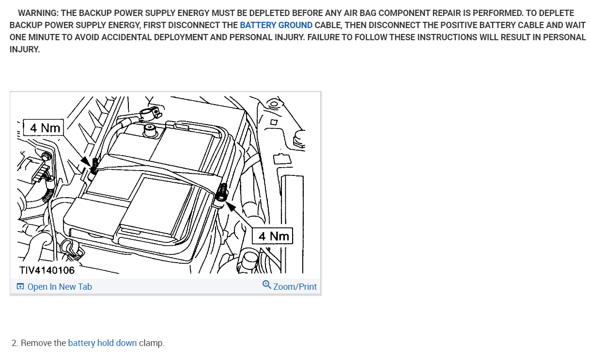

Sure, here is the battery and starter wiring diagrams. Check out the images (below). Please let us know if you need anything else to get the problem fixed.
