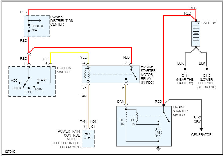

Had battery and starter checked, both are good, but car will not start. no sound at all coming from starter. all lights,horn are working.
Sep 11, 2020 at 10:09 AM
We need to assume at this point that the starter is okay so we need to check voltage at the starter. I attached the wiring diagram.
You should have 12 volts all the time on the red wire but you should have 12 volts on the brown wire only when you are cranking the engine. If you do then I suspect the starter is failed. If not, then the relay or something else is the issue.
Let us know what you find with this and we can go from there. Thanks
