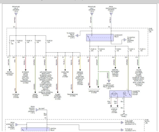

I have changed alternator and battery and when I put it in drive my battery light and my e-brake light and A/T temperature comes on the dash then either lose power.
Jan 22, 2017 at 3:52 PM
  • 55,433 POSTS
Hi JEANNIE

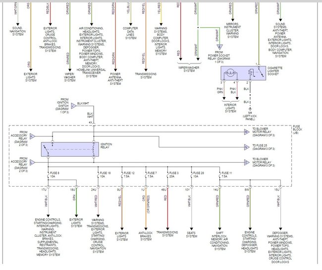

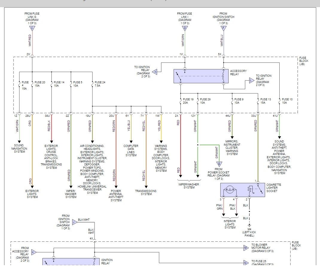

There is an ignition relay in the fox box that looks like it might have bad here is a guide and a diagram that will help you get the problem fixed.
and please check the battery cables they could be going bad causing the problem as well.
Run some tests and get back to us so we can continue helping you.
