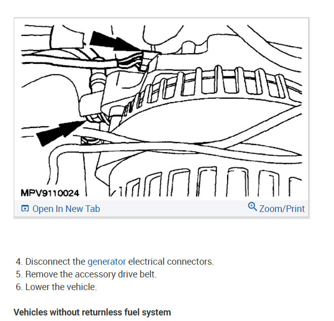

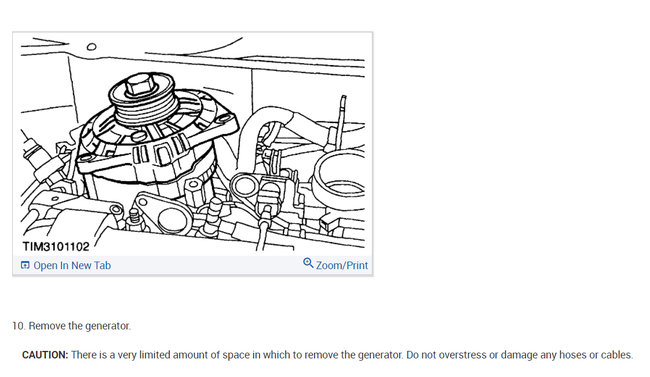

The battery was dead, after taking it to Advance Auto for replacement. They discovered the battery was good and charged it. I placed it back in and the vehicle started okay. after driving it for two miles, it went dead again. I placed my truck battery in it and performed without any problems.
Oct 10, 2016 at 2:33 AM
HMAC300
  • 48,601 POSTS

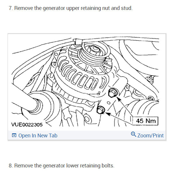

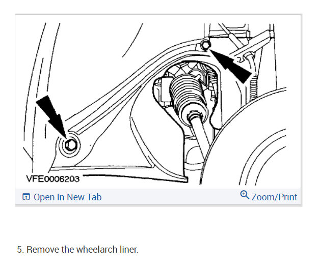

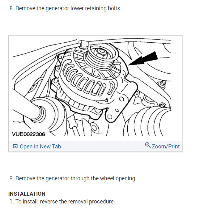

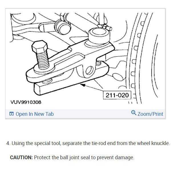

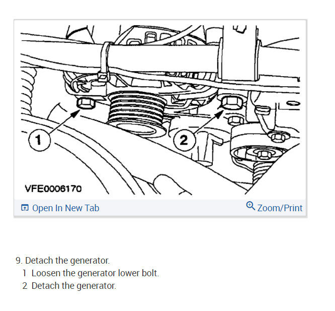

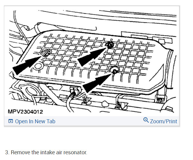

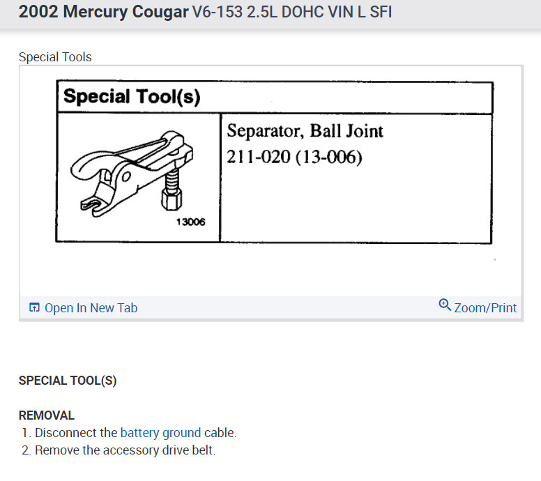

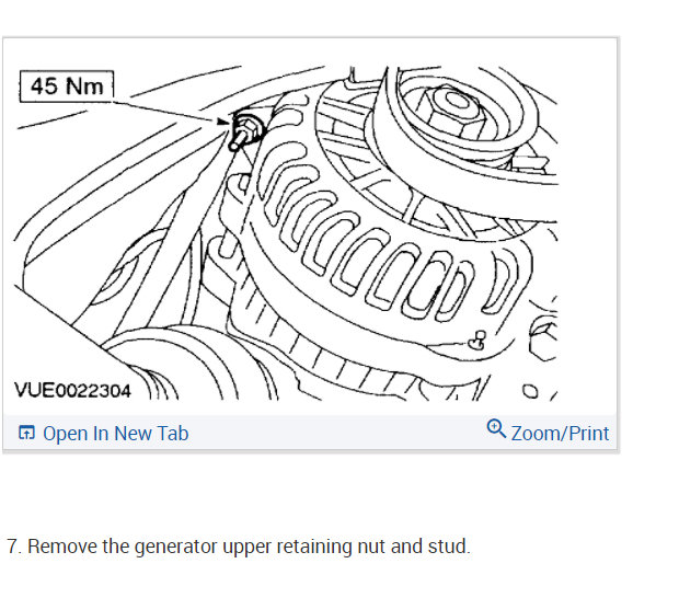

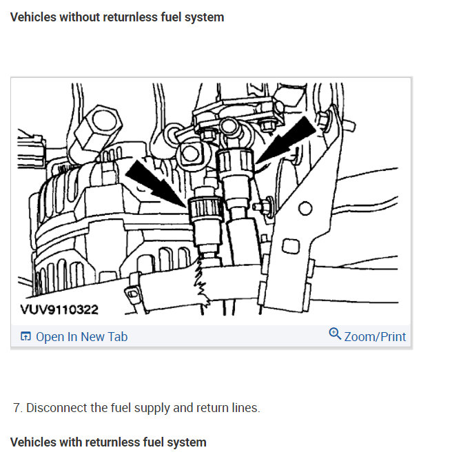

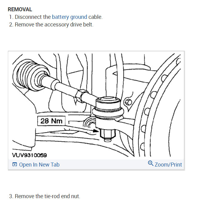

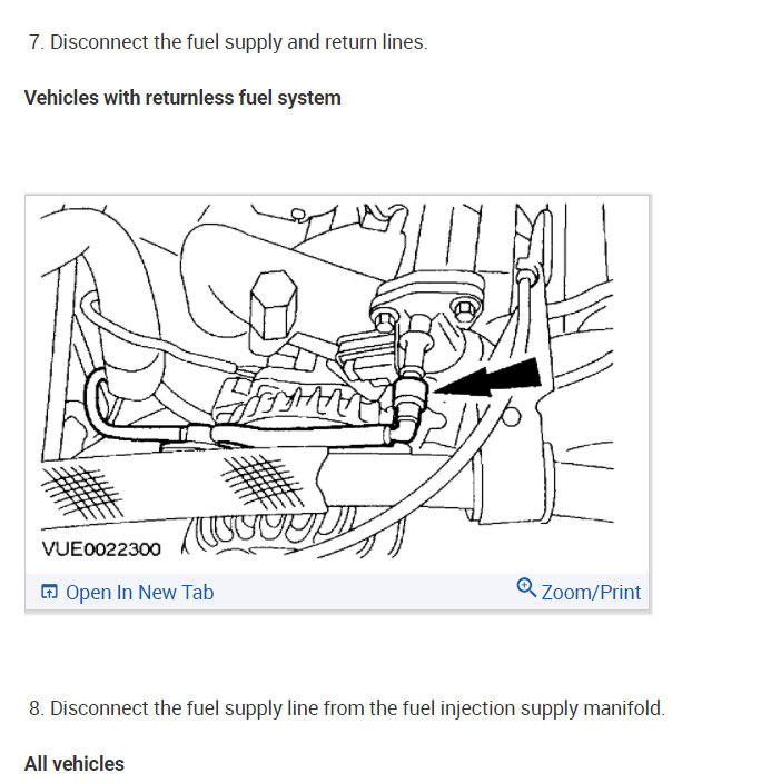

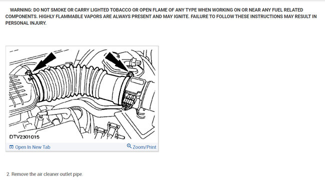

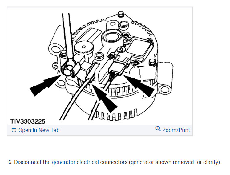

Here is a guide to help you step by step with instructions in the diagrams below to show you how on your car. I have included both 4 and 6 cylinder engine in the diagrams below.
https://www.2carpros.com/articles/how-to-replace-an-alternator
